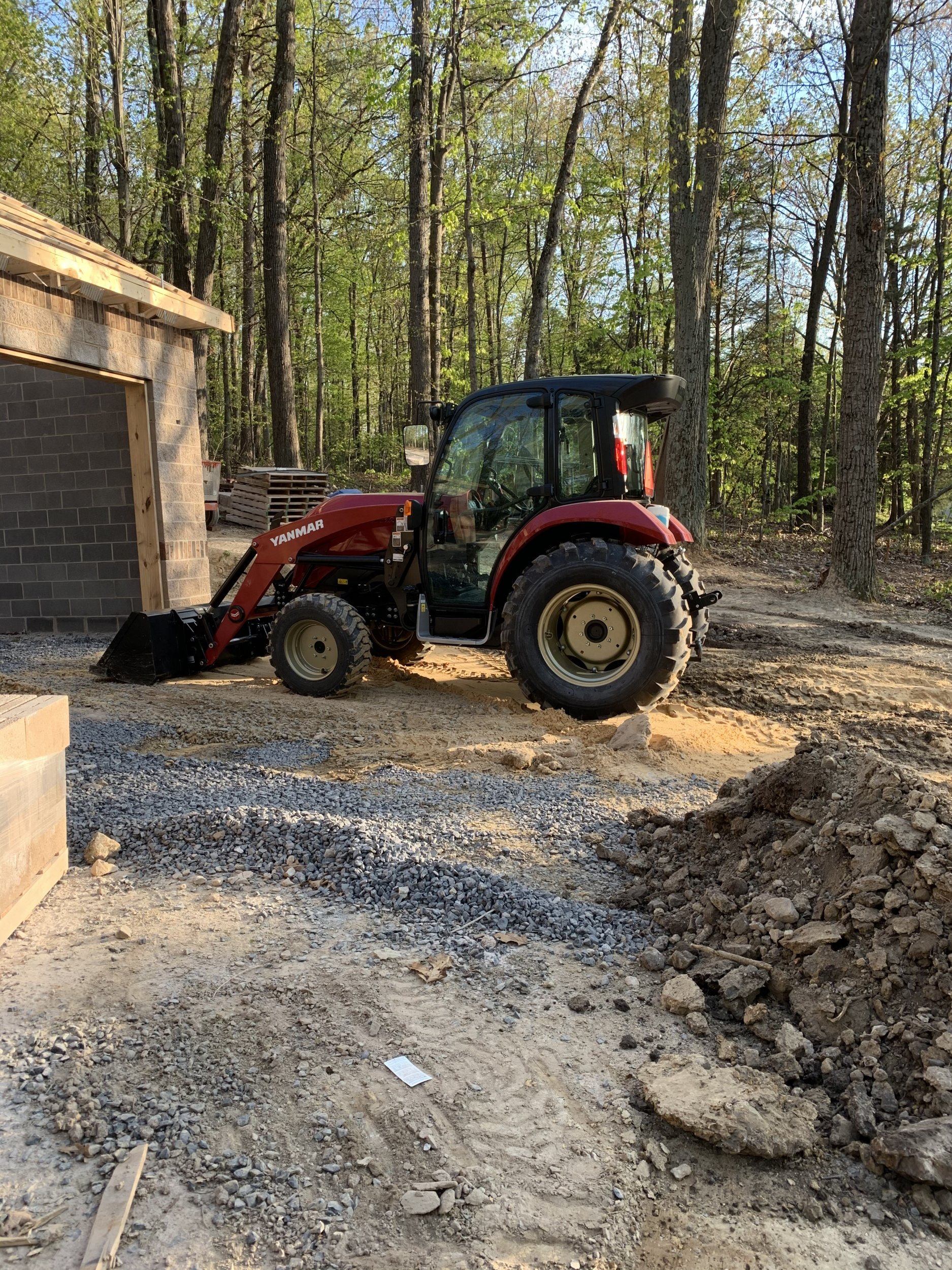

I am new here and this is my first post but after 8 years with a kubota L3800 I finally replaced it with a YT359C. The kubota was a great tractor but I simply needed more HP and after spending some time in the Yanmar I was amazed at the simplicity of the transmission. After several days of mowing and moving dirt, the AB function and auto throttle is like having a very high tech machine that was $1000s less then a comparable sized kubota or JD. Not knocking those tractors at all, just simply saying if you have not spent time in a yanmar, you really should!
   / Ready to buy: Yanmar YT347 or JD 4044R #18
Great looking tractor! Congratulations!
