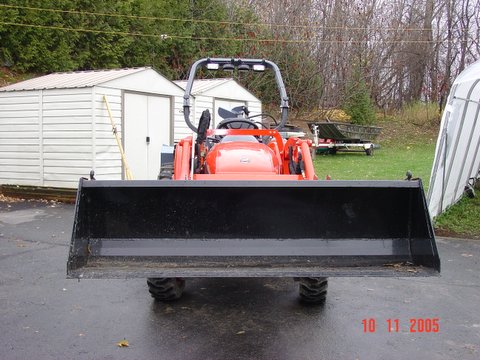

Let it snow!!

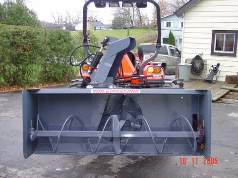

Here is a pic of my new Econor snowblower with dual remote.cag

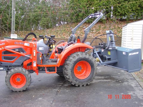

Another

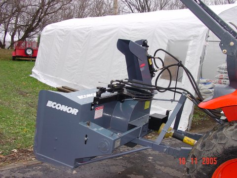

another view

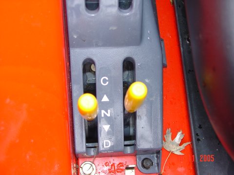

By the way the last pic was of my dual remote

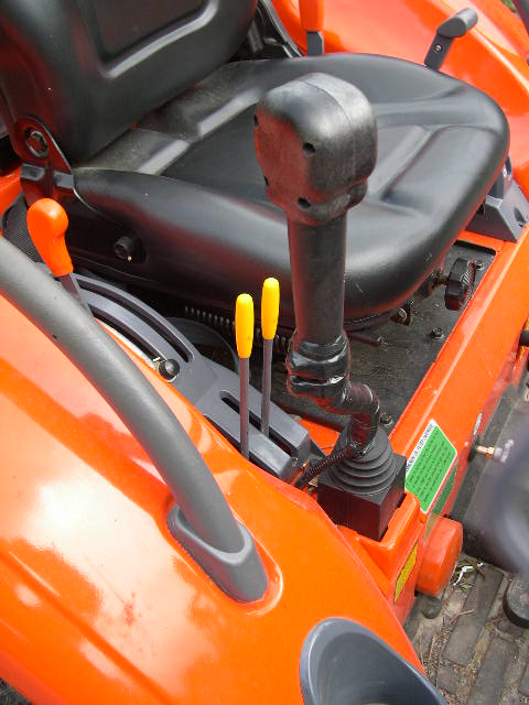

Really nice setup. I'm sure you will enjoy winter a lot more. I use a Puma on my CK30 with rear remotes. I found the remote levers to short to have much control over the cylinders. They wanted to go all the way or not at all, so I welded 6" extensions on them and now can feather the control. It was that or flow controls which I may install anyway.
I am attaching a picture of the extensions.

That's a great idea. /forums/images/graemlins/cool.gif I also think they are too short. I'm going to do the same thing when I add my second remote.
