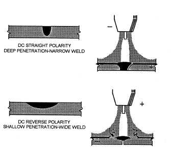

Thanks - the steel is pretty clean - light/patchy surface rust is all. I can wire brush it a bit first, if needed.
Electrode positive on both of those (6013/7014) right?
   / (Re)starting to learn stick - which rod? #7
Cribbed from somewhere on the 'net:
The terms "straight" and "reverse" polarity are used around the shop. They may also be expressed as "electrode-negative" and "electrode-positive" polarity. The latter terms are more descriptive and will be used throughout this article.
With few exceptions, electrode-positive (reversed polarity) results in deeper penetration. Electrode-negative (straight polarity) results in faster melt-off of the electrode and, therefore, faster deposition rate.
- so yes, electrode positive for relatively thick sections of steel.
