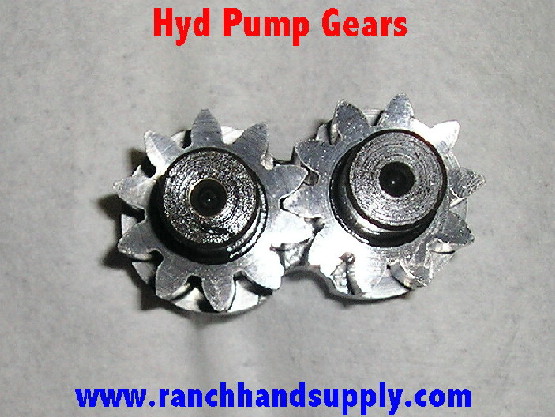

Talking about pump hyd problems.... if the filter/screen did not catch the trash before it entered the pump ..... then it will try and pass/sucked through the pump. If it made it through the pump......that means it had to go through the pump gears. I think it would have to be really small to pass through the pump. So I think if the hyd problem I was having that was due to trash...then it picked it up after it left the pump.?...just a thought process.

Pump Gears
