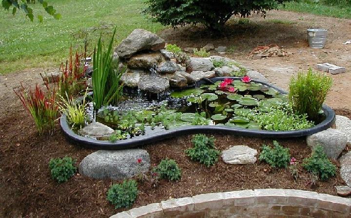

You've got it about right Harv...fresh running water and fish with infinite appetites will easily keep away all traces of mosquitos. Ponds are like aquariums...everything is about balance. Ph levels, ammonia levels etc. With the right balance of plants, fish and naturally occuring bacteria, the balance is easy to keep once you attain it. Finding the balance can be tricky. Attached is a picture of one of my small ponds. Landscaping was still in progress!

They sure are pretty when you keep them up. Nice-looking pond, Tony. /w3tcompact/icons/smile.gif
When you say, "fresh running water", you're really talking about fresh recycled water, aren't you?
I remember my dad creating a very elaborate screened-off sump area for the submersible pump unit. Being a kid, that and the fancy multi-tiered waterfall were my favorite parts. /w3tcompact/icons/wink.gif

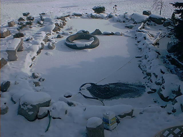

Here's what our pond looks like now /w3tcompact/icons/sad.gif Won't see the koi for a few more months when things starts to melt. Not a lot of snow yet but temps been below 20deg for the past few weeks.

Yep, you're right. It's recycled water. By fresh I meant it is clean and not stagnent. The only filter I use is a $1 fabric type strainer on the waterfall pump. I just put the pump in an old black plastic flower pot (10") and form fit the mesh into the top, with a hole for the hose. All this does is filter out loose suspended material but it really helps. After that, I just depend on natural bacteria. A few times a year when a see an algae bloom starting, I add store bought natural enzymes which help out mother nature. The fish and the plants do the rest. The water tests perfectly every time.

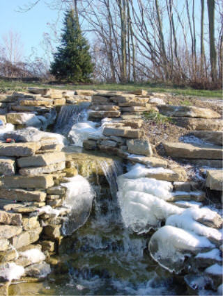

Thought I'd post a picture of our waterfall this afternoon. We've had a week of 8-25 degrees and the ice is starting to form pretty good.
