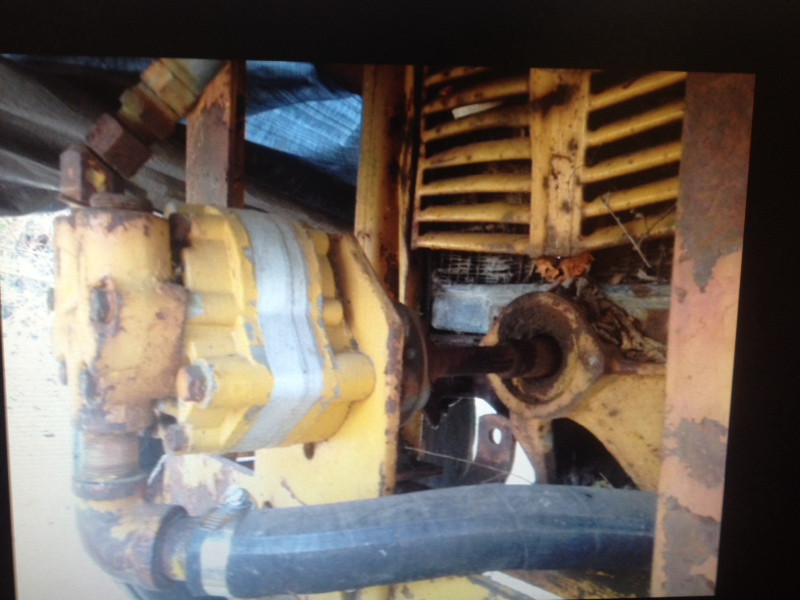

You can make plumbing a lot easier if the loader has a reservoir built into the frame, and if you use a front mounted hydraulic pump instead of the internal pump.
The loader will be slow with the internal pump, but it will still work. Using a front mounted pump has many advantages- no messing with valves under your seat, your 3pt hitch will still work no matter what loader work you're doing, and you can easily use both simultaneously.
Edit: I believe the 135's used an adapter similar to the one that was on my machine when I bought it. Really just a plate that bolts to the loader frame and allows an SAE Type A pump to bolt to the plate and be centered with the front drive shaft off the crank pulley.
(My MF35 isn't supposed to have that setup on it, so I removed it and set it up properly)

Yes, as Shaeff stated, it would be a bit easier, and from an operator's view more convenient when using both systems frequently, to have a front-driven pump for the loader like his and my tractors have fitted. The 135's 3pt pump would certainly be capable of operating the loader - might require a few extra RPMs though. According to TractorData, the internal pump dlivers 4.8GPM, and is capable of 2800psi. The front-mounted pump on my MF40 loader (likely the same pump on Shaeff's tractor) does 20GPM, and will push 2125 psi. I find, unless I'm loading a truck, a fast idle is sufficient for most of what I do with the bucket, and suspect the internal pump would also be sufficient for me.
A lot of MF tractors from the late 1950s to early 1990s used similar versions of the same basic hydraulic system, built into the transmission cover.
A lot of these tractors has diverter valves fitted - there should be someone here knows them like the back of his hand. Maybe a m oderator can move this thread over to the MF Classic and Vintage for more response.
Note: I believe those plugs on the sides of the cover are pressure test points, not return ports. The best idea I believe is to drill and tap a hole into the (round) RH side cover beside the oil dipstick for a return hose fitting.

The nice thing with the front pump, is that it has zero effect on what your lift and draft control are doing. That's one of the several reasons I suggested going that route. You won't need to mess with your draft or position controls to use the loader, and certainly not a diverted under the seat.
Front pump makes the loader system completely independent of the internal pump AND simplifies the hydraulic routing.
