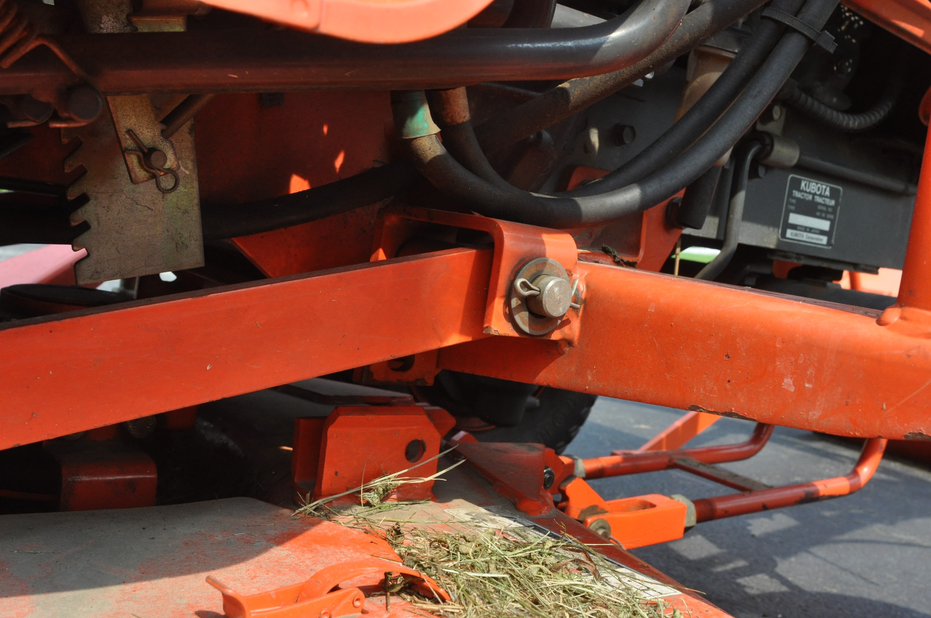

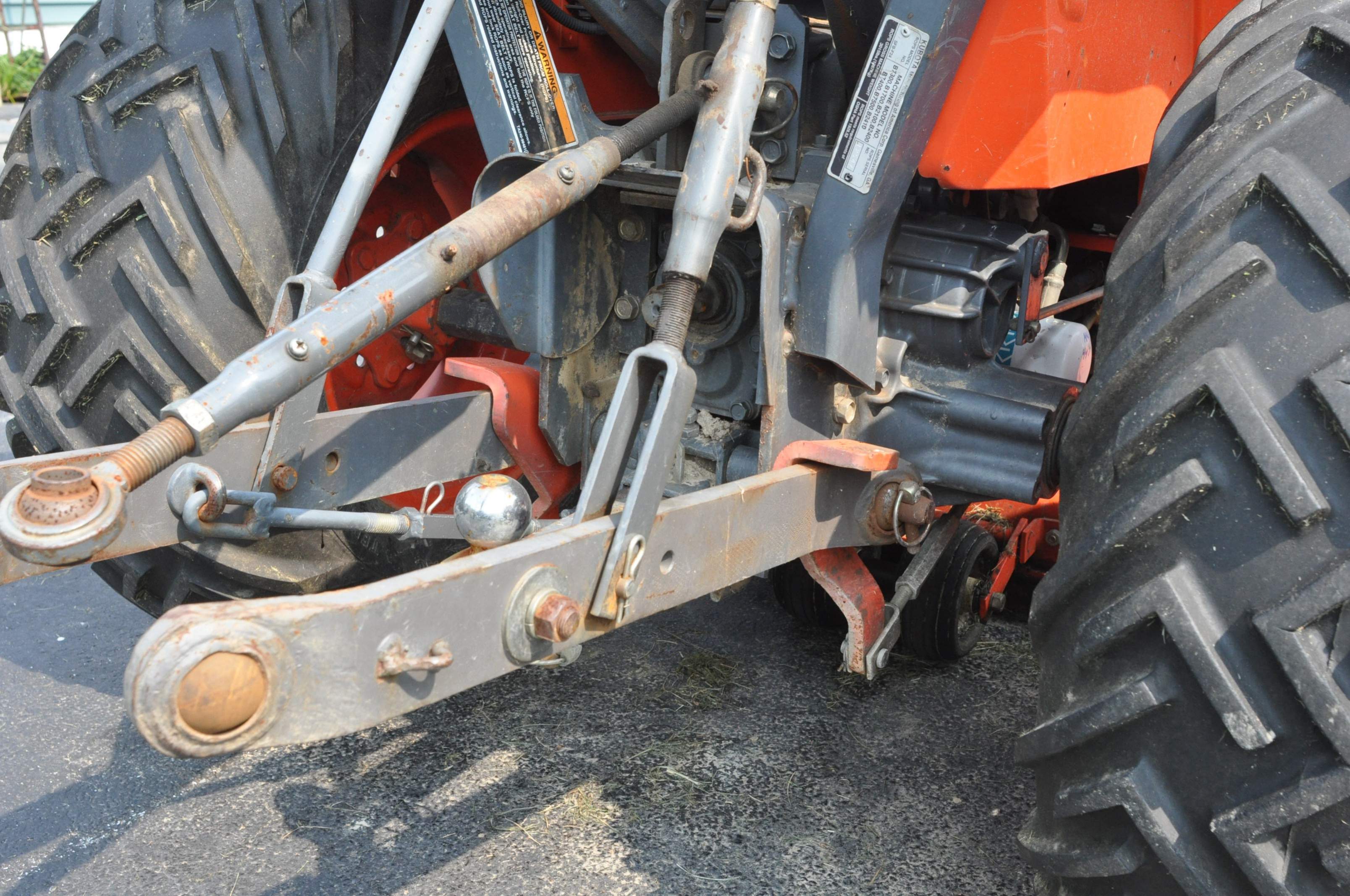

First of all, HAPPY BIRTHDAY AMERICA:cool2: New owner of a B7510, it came with a FEL. I just got a RCK60-24B deck and all of the brackets. Now I am trying to figure out the mounting. Got the operators manual with the deck ( thankfully ) but still have concerns as to where the hyd. line on the right side should sit between the lift arm and the connecting rod. Anyone with a B7500,B7510,or a B7610 would you have a picture of where yours is routed ? Just trying to avoid installing this twice. Not much room in this area for the moving linkage with the hyd. line snaking through there. Thanks.

I have a B7500 with the deck on I will try and get some photos for you tomorrow

Thanks ever so much for the pictures, the middle picture of the right side is the hyd. line in question. I am going to print YOUR picture and then go look at mine. Stay tuned.

Let me know if you need anymore . Those rods connect the deck to the 3 point arms , they do run close to the hydro lines and just under the filters .

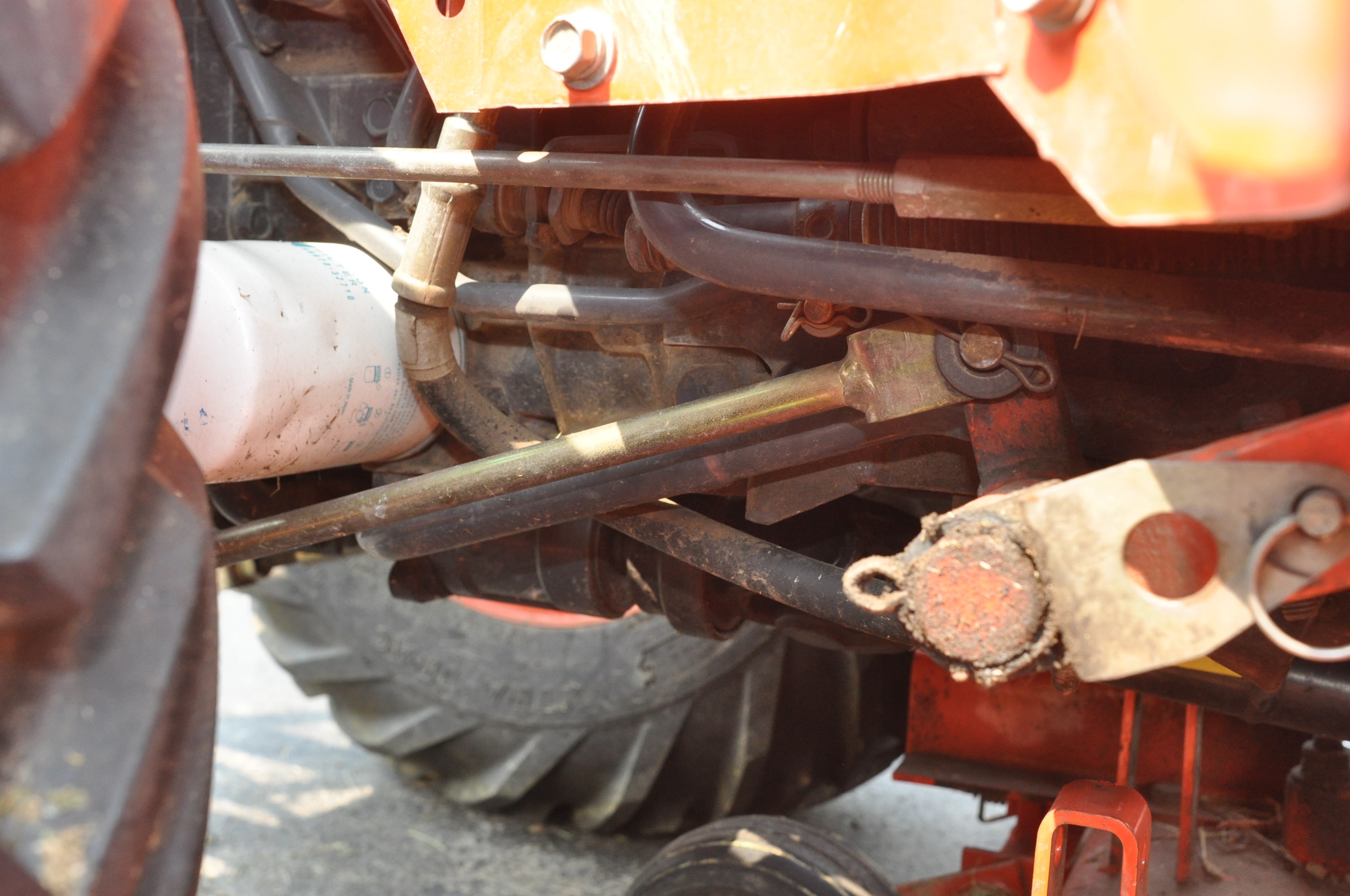

Heres what it boils down to.Does the hyd. hose go above or below the rear hanger bracket and lift arm ? Thetooth, from your picture, it looks like it goes BELOW. While underneath this thing, I noticed the guard around the universal going to the front axle is boogered up. But one thing at a time.

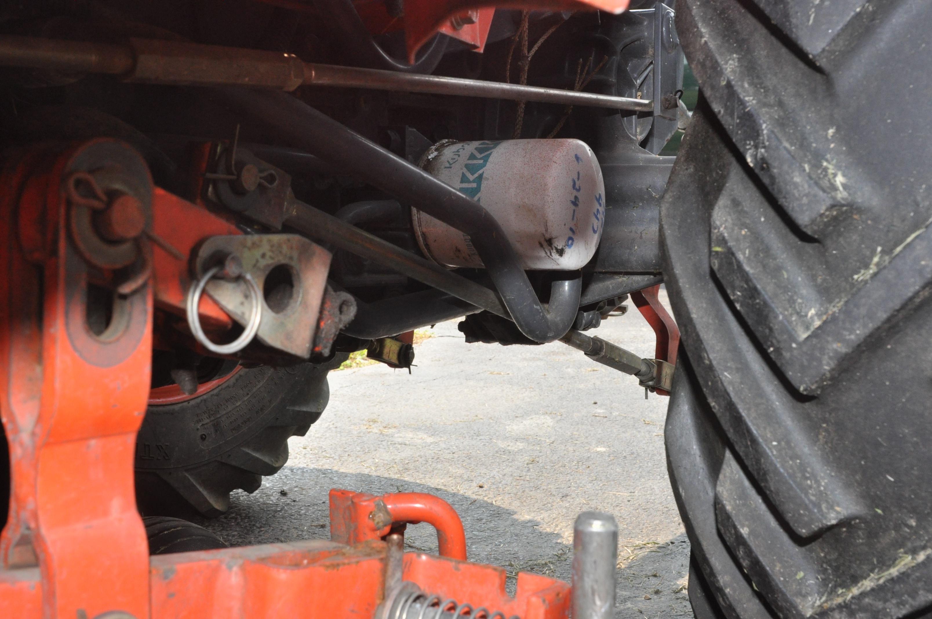

Thetooth would you be kind enough to take a picture from below on the right side showing how the hyd. hose to the loader is routed . Thanks. That is if you can stop collecting orange tractors.:cool2:

Those photos are in the above post . They are the 3rd and 4th photo left to right . One line in near the white filter and the other two are shown in the 4th near the loader frame .
The hose near the filter is ty wrapped off the frame of the tractor .

Got it, thanks. Gator blades finally showed and got installed. Work light project is complete with the TuffLED stuff. Next is some type of U joint guard for the front, plastic is NOT looking good. Short of tall grass, is there any reason to cover it up ? It does not have a grease fitting so it wont make a mess till it goes out. Then one of these days I can finally mow something.
