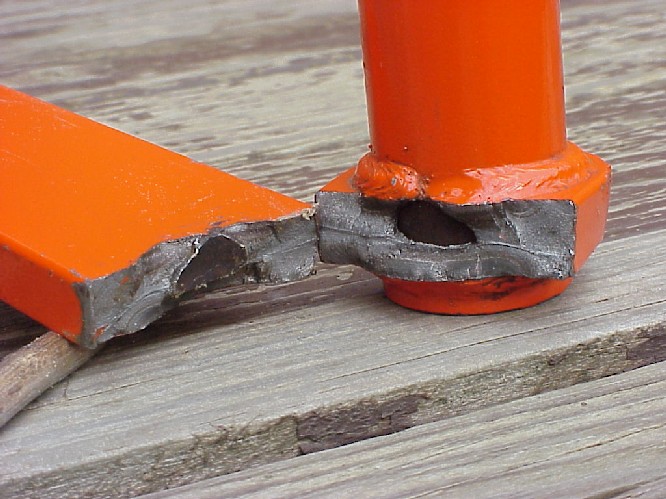

Foremost, I am writing to see if anyone has encountered the same problems with their 72" belly mower mounts (on a B2710) as I have. Specifically, one of 2 identical bars that attaches to the mower to the tractor, and lifts the mower via the tractor hydraulics, has broken at a weld point on the bar itself. Both ends of the bar are pinned (to the tractor via a large pin thru a bushing welded to the bar...the weld which broke...and a small pin to the mower thru a hole in the bar). Both pin points move/rotate freely. Whew, a picture is worth a thousand words....hopefully I can get the picture attached.
Finally, any ideas on cause appreciated. Below is correspondance I have had with Kubota, and detail explanation and photo's of the problem. Must say, very disappointed in Kubota on this one. Sent notes to various e-mails trying to get a response. So far all I got was what I consider a 'blow off' letter below. I will post future responses.

Which picture are you referring to, and what are beech marks?? It is clear the weld was not completed, and that is where the failure occurred. I agree loading (of all types) is the cause of the observed effect. However, this weld point would not be the weakest point to fail. The deck attachment points, etc. would fail first (bend, crack, tear) if the cause were excessive loading as suggested. Pls have someone in your metallurgy activity look at this.

Thank you for the analysis of this failed part. However, the beech marks
on the left of the flat piece, indicate that there was excessive side
loading of the mower deck and linkage causing this failure. This means it
is not a defect in material or workmanship and the unit is out of warranty.
Kubota will not be participating in this repair.

> The Mower Deck Rear Link (part number K5751-51293) on my B2710 failed due
to an incomplete weld where the bushing cylinder is welded to the link bar>
...> .ref. attached photo 'Kubota Both Ends'.
> Evident in the attached picture 'Kubota Bushing End' are the following:
> - The weld was not completed resulting in a small gap that resulted in a
weak spot and stress concentration point. The replacement part was welded
throughout the 360 degree perimeter, as were the bars on 2 B2710's I
reviewed at a Kubota dealer.
> - Fatigue striations radiating from this point showing it is the point
of failure. Striations are also visible on the attached photo titled
'Kubota Both Ends' on both the bushing cylinder and the bar.

After seeing the photos I think I would have to side with Kubota on this one. It does look lke the weld broke from side impact. Maybe you have rubbed the deck against a tree or fence a few times. I know I have gotten closer to some trees more than I would have liked. /forums/images/graemlins/blush.gif I have the same deck and had a crack in it. (Still don't know what caused it though) My fix was to just weld it up and repaint, and thats what I would have done with your part as well. Life is way to short to worry about small things like this. Kubota still makes a great product and I for one am glad I got mine, even if it does have its few flaws. /forums/images/graemlins/smirk.gif

But in looking at the picture you sent, I can't see where a weld broke - looks like the break was below the weld point (although how that could happen I don't know - looks like a pretty serious piece of metal to me /forums/images/graemlins/shocked.gif).

Sorry for your problem. The break looks to be at almost the point where it should break if pushed beyond some limit. The flat stack is apparently drilled and a pipe inserted and then welded around it. The weak link broke which in your case could possibly kept something else from bending. The fix would be extremely easy for many of us and for me an oppourtunity to make a more substantial setup. If it were me, I would be talking to my dealer, not Kubota. The dealer is the middleman who should be working with you and not indifferent about it. If they are not interested, keep squeaking the wheel. Fortuantely, your repair looks like a snap to take care of. Best wishes.

Everything has a proper chain and you probably have hurt yourself by going the way you did. Your first contact should have been with a dealer and it should have finished there. Yours is so simple and a quick look at the side of the deck could have told someone if it was a natural break or forced or a short weld. But it could have and should have been delt with at the dealer.
