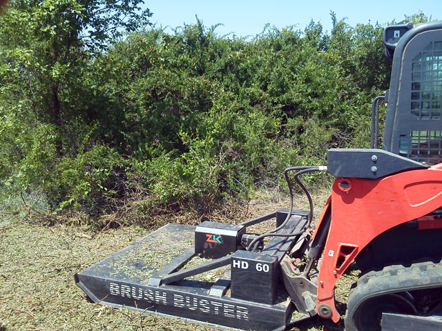

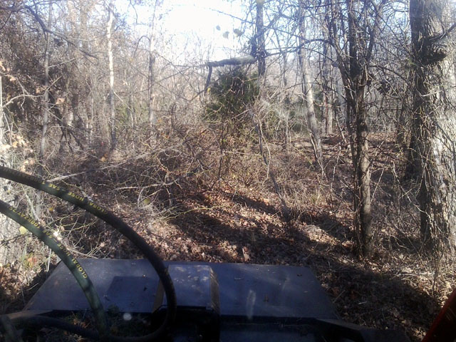

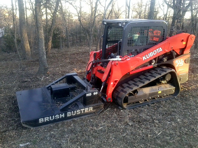

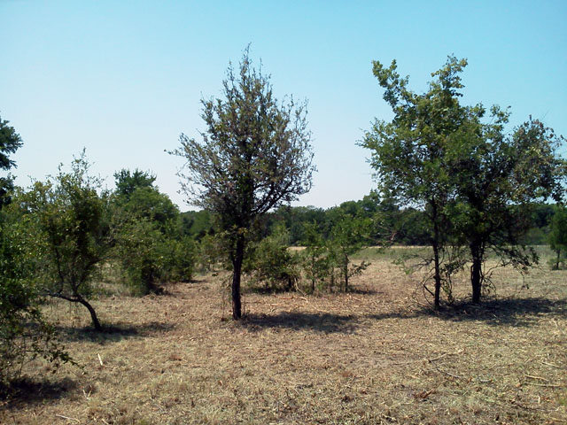

I've run a rental 60" Brush Buster on a Kubota SVL75 quite a bit. That particular unit is pretty lightweight, but it'll cut 3" material without too much problem. It won't push trees down, and even in -3" material the front will bend a bit if you try. With the right technique and being careful about the pushing part, it'll do a pretty dang good job of knocking out heavy brush and saplings. I tried to get the rental guys to weld a heavy piece of angle on the front edge. They never did, and it still goes out on rental all of the time.
Here's some before and after pics of a couple of jobs.
Edited to add: What happens at the leading edge, is that the deck sheet metal separates from the heavier frame material between the welds since it's not welded all the way across. Material gets jammed in there. It looks like an easy fix to me.
