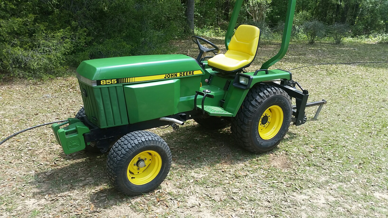

Wife bought me some new hood decals and a front lens for Christmas. She didn't understand you can't just stick new stuff on an old faded tractor. I put them on the shelf till I could get around to painting it.
I used the Rustoleum brand Farm Equipment paint in aerosol cans. Took 4 cans of green and 2 cans of yellow with a little left over from each color. I wet sanded the whole thing with 320 grit and wiped it down with rubbing alcohol right before spraying it. I am very impressed with how the paint went on and looked. Rustoleum dries slow so you need a bright sunny day to use it or it will remain tacky too long. I have tried using it in the garage a couple of times and it will stay tacky for 2 days or longer depending on the weather but in 90* sunlight it will cure in a few hours. The upside however is it doesn't dry so fast you get those dry streaks like you do using fast drying aerosol paints.
Tip: If you paint your tractor make sure to have compressed air available to blow out the grill while it's wet. Paint will dull a little but it keeps it from clogging the holes. Mine had been painted before I got it and 50% of the grill holes were clogged. Took several sandblastings and some digging with a sharp object to get most of the holes open before I repainted it.
Here are before pics.
And here it is during the process
And the final product

I thought I would update this with a photo I took today. A year and a half later and I am still pleased with the results. Shows a little wear on the foot boards and has some scratches but otherwise it's held up pretty good. Tractor is stored outside under a carport.
