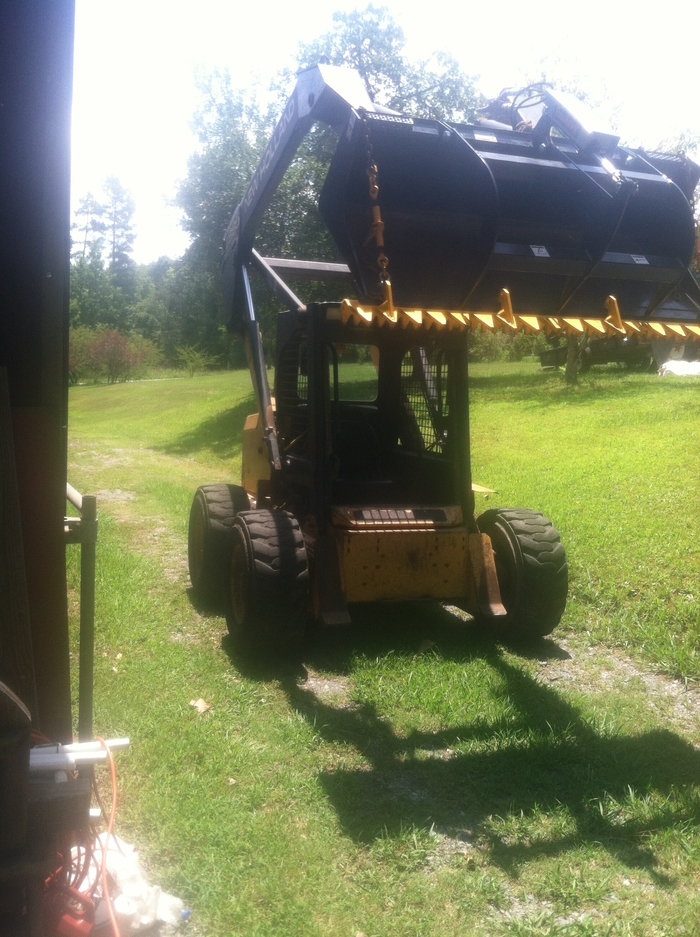

This is a 72" RR I have on a 66" grapple bucket. It's held up great with heavy use. You can see where the chains are right at the end of the bucket but works fine. The straps some use should work ok too. As far as it hanging out past the bucket I don't see how that's much different than having a wider bucket. I have a 84" tooth bucket that hooks up the same place as the 66" grapple bucket.
   / Ratchet rake size question #6
Yea, I have a longer RR on our 4n1 and it has worked pretty well. One of the ratchet points has to go on outside of bucket, but hasn't been an issue for us. Didn't buy it that way on purpose...only when Tractor Supply had this length for $99
