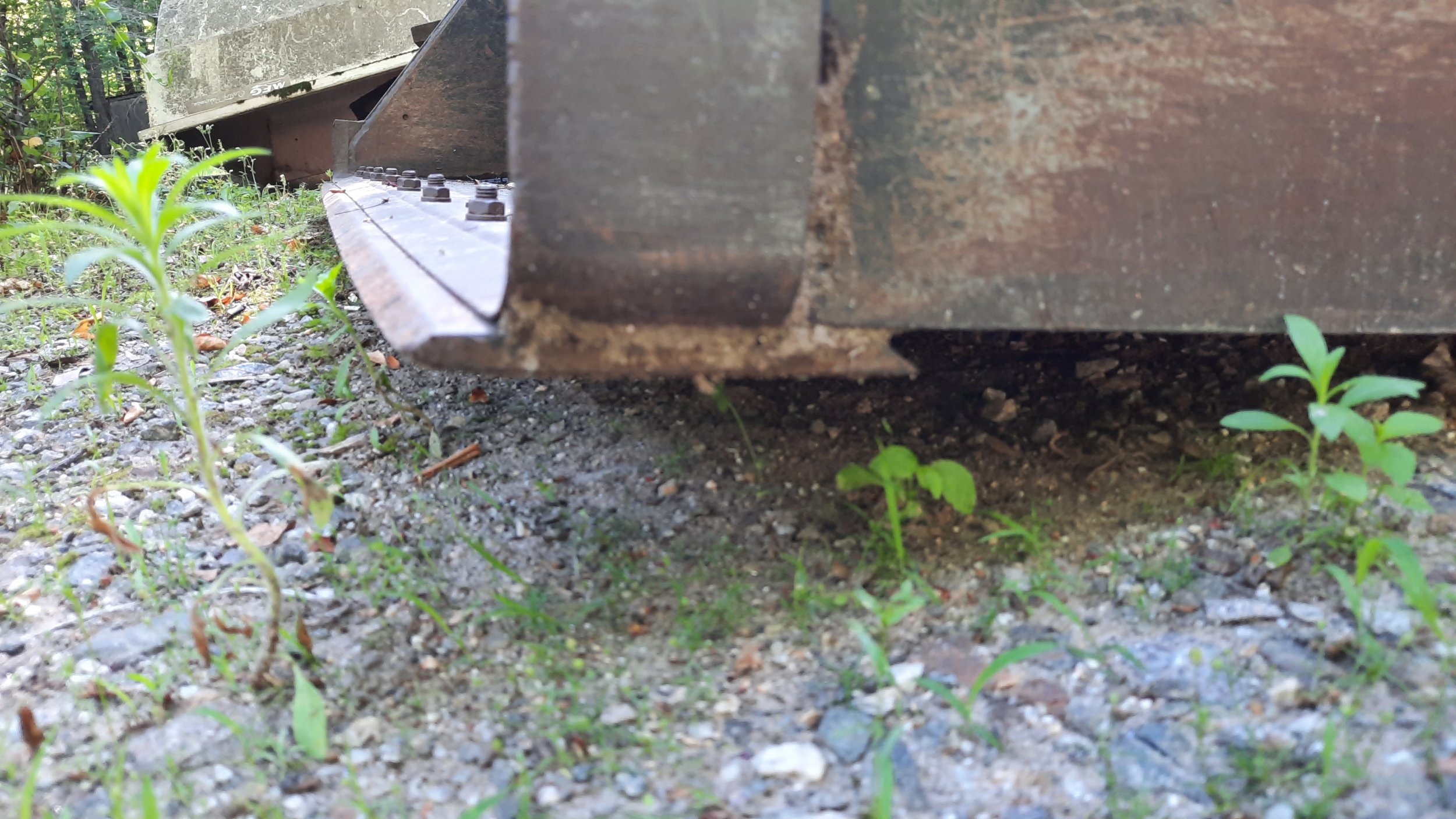

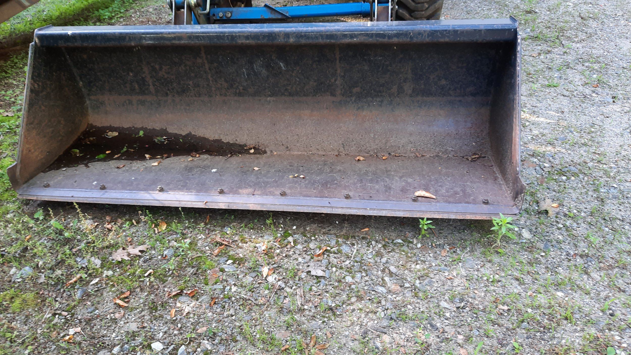

Looking at possibly purchasing a Ratchet Rake for our NH TC40D with pretty specific use in mind. I’ve read tons of threads on TBN (thank for all the info) & viewed multiple videos (most terrible) & pretty convinced on purchasing one… So without going into a huge debate on if it is a good tool or not; I’m more interested in information for our use.
I’m hoping to use the Ratchet Rake to pull back some of the stone / process (1 ¼ “minus) back into our drive. Our ½ + mile drive has culverts lined with Rip-Rap & over the years the stone/ process has migrated in to them. I’m not looking to completely remove the process from the culverts just pull back areas that have accumulated to much of it. Also not too worried if some if the Rip-Rap is disturbed as we can just place it back.
We have a Rake but is not really the tool for this & do not want to use a blade as I’m not looking to reform or disturbed the base of the culverts… I just want to move some of the top process layer back to the drive. I realize I will be only working 5+ feet of area at a time with the R.R. & that is ok.
I want to get the culverts back in shape prior to repairing & possibly topping the drive with new process.
A few questions regarding the Ratchet Rake:
Is there any reason the 68” version would not work with a 72” bucket that has a bolt on blade?
- Attached pic of bucket below
Do any R.R. owners use theirs in a similar fashion – pull stone back out of a culvert / ditch? And does it work well?

The 68" version says it fits buckets 60" - 72" and the binding points are 54" so I see no reason why you couldn't use it on your 72" bucket as long as you can use the binding locations.
The 72" is made from thicker plate however, so there is that.

Yeah, I saw the specs... I was wondering if there was any concern with it working with the bolts for the bolt on edge... didn't know if the R.R. will work with them...
   / Ratchet Rake Questions - specific to our tractor bucket & our use #4
ahh.. Only problem I see would be are the slots wide enough to accommodate the bolt on blade. You should give them a call. Otherwise the bolt on blade should actually help by increaseing the bucket's edge strength.

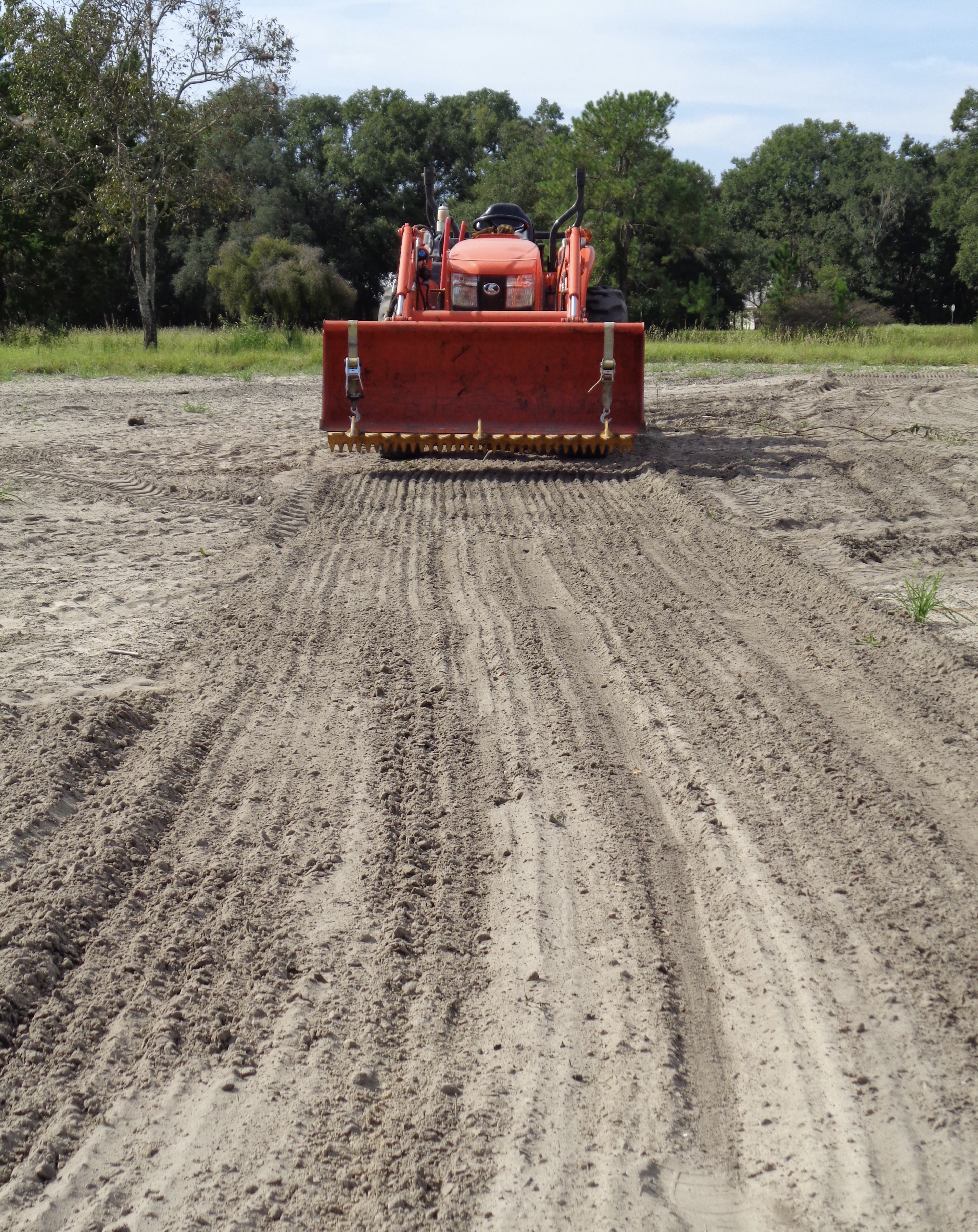

I have owned a ratchet rake for 5+ years, and have never even unboxed the mounting hardware.
To be fair: I have 3 rear blades, a box blade (also unused), 2 loader buckets, a tooth bar, a grapple, and an 11' reach backhoe.
I have just never had an application for my ratchet rake......so it sits, with the mounting straps in the original box!

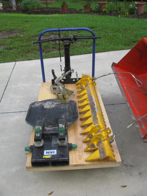

Is there any really good reason to pay the extra $35 for the 72” version?
Each increment of width uses a thicker steel so the wider rakes have more weight of steel per foot of width concomitantly stronger. I once had a tooth break off. My local welding shop welded the detached tooth back on and I have not had another problem of any description.
   / Ratchet Rake Questions - specific to our tractor bucket & our use #7
You could simply call the Ratchet Rake mfg.(1-888-850-6070) and ask about the cutting edge bolt issue.
Yes. The mounting gap height dimension may vary by rake width. Correct RR fit over a reinforcing bucket edge has been a problem for at least one T-B-N contributor.
Is there any concern with a Ratchet Rake working with the bolts for the bolt on edge?
The RR can be moved from side-to-side so mounting hardware will miss the bolts. That will not be a problem.
If the mounting gap on the RR is a tight fit over the bolt-on edge on your bucket, after use you may need a sledge to break the RR free.

I like my RR and it works well for ripping out saplings and brush, mostly used it for tearing out honeysuckle that was stifling the tree growth. I would equate it to having an industrial duty rake on the blade of the bucket and I believe it would probably work for what you want it to do. They are very well built and don’t think it will ever wear out in my lifetime and they are fairly inexpensive. My 2 cents
