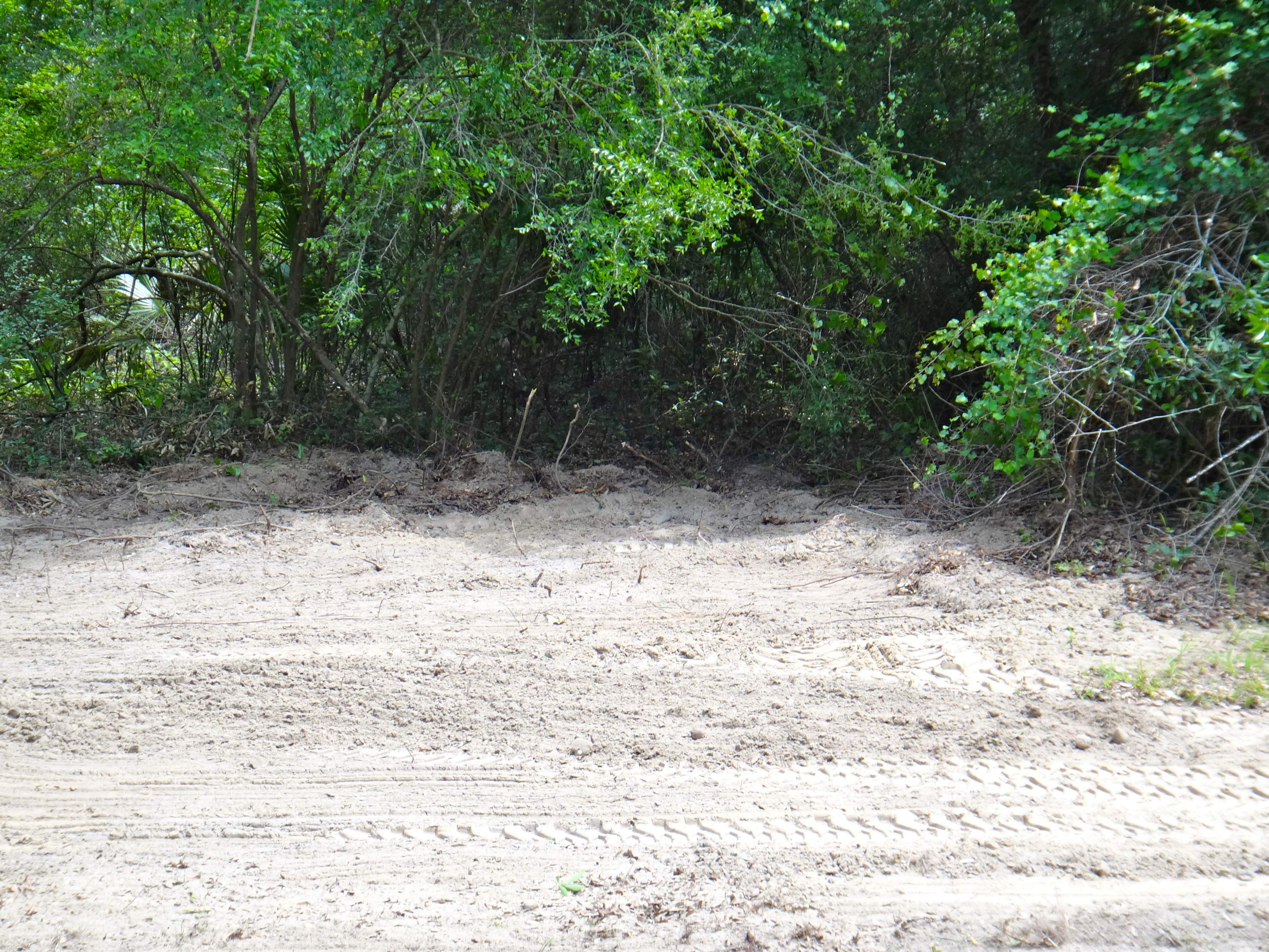

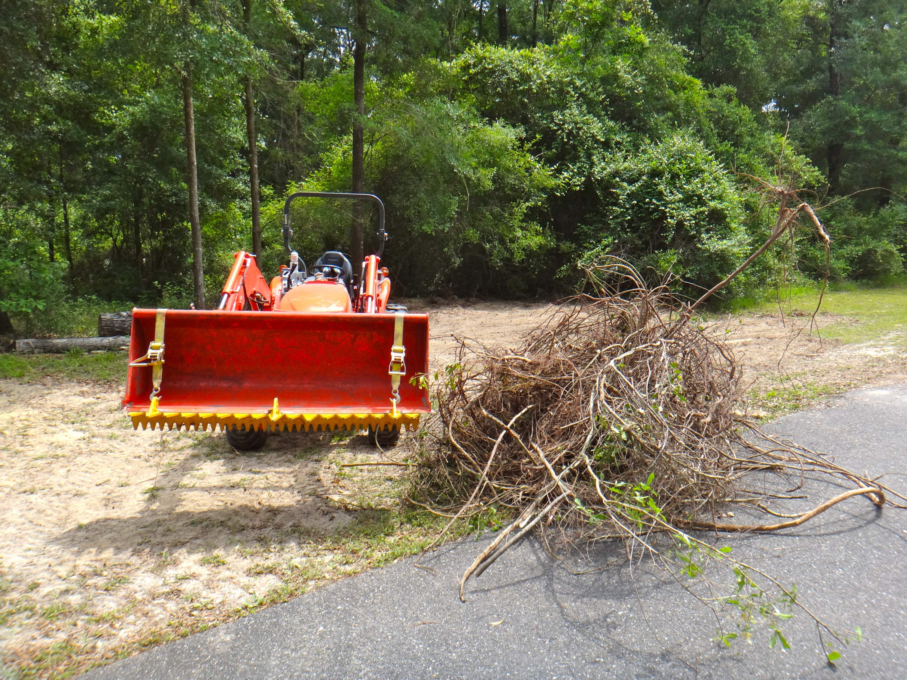

There it is. I have the RR and wouldn't give it up. I do mostly home landscaping and RR leaves ready to seed yard and takes less than 2 minutes by yourself to install, depends on how fast you walk from one side of bucket to the other side, and a minute, by yourself to take off. I had a bolted on tooth bar early on and was worthless to me but the Pirinha wasn't available at the time. For my uses I still pick the RR with the Parinha nipping on it's tail. The Pirinia can stay on and the RR has to be taken off when scooping up "stuff".
