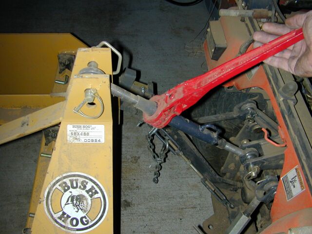

Anyone ever tried using a ratchet jack for their top link?
AgriSupply Ratchet Jack
I'm thinking it would be an easier way to adjust the top link on implements (especially heavy implements) with out going the top'n'tilt route (too expensive for now).
I've never used a ratchet jack so I'm not sure they would be easier than the standard top link arm.

I've had the same idea for a while but haven't implemented it yet. So far drilling my top link and inserting a long bolt as a handle and brazing a short bolt to the side of the lock nut has been working well. I bought a ratchet style load binder at Harbor Freight on sale to use, whenever I get to it, on my top link. The ratchet itself is pinned onto the tube of the binder so I thought to just pin it to my top link. The tube diameters seem close but haven't measured. The prob may be still having to use a lock nut though.

Made one out of a ratchet chain binder by welding ball ends and short extension to the ends. Works good.

I don't think you have to give up the ball ends, you can buy ends that are made to weld onto a bar. Just drill the proper size hole and pin them into the fork end of the ratchet jack. I was thinking about a worm gear type of adjuster, but haven't worked it out in my head yet. One thing you can do is buy a hydraulic top link and put piping and a cock valve between the inlets at either end. You'd need a small reservoir to make up for the fact that one side of the cylinder uses more oil than the other. /forums/images/graemlins/wink.gif
   / Ratchet jack for top link? #9
Found a use for it last night so I quickly threw it together to test ... works good so far.
