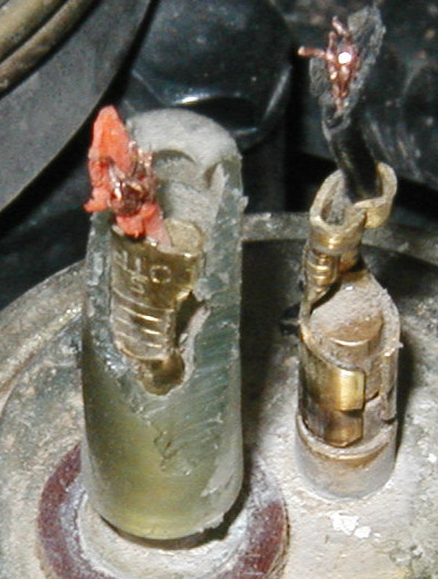

A rat chewed the wires off of the temperature sending unit. My dealer has no connectors or info on size needed. I discovered the problem just as I was leaving my ranch, and had no tools handy. I did have a camera with me so here is a picture. The auto parts store nearest the tractor is 40 miles away, so I wanted to buy connectors and make up the repair wires before I drive back to my ranch. It won't be hard to kludge something up, but I'd like it to look nice. Does anyone know the size and type of connector?
Also, does anyone have a suggestion on the type of electical tape that should be used near exhaust system parts?

I could be wrong, but I think the temp sender is a one wire deal. Looks to me as if that is the air cleaner restriction indicator sender. Screws into the intake plenum. The temp sender is in the thermostat housing with the terminal pointing to the left of the tractor. Yank the connectors off the switch and take them to an auto parts store to match them up. Try female bullet connectors. Consider heat shrink tubing over tha splice and terminals.

Thanks for all of the suggestions. I tried to yank the connectors off with my gloved hand at the time, but it didn't work and I had no tools handy. I'm going back to my ranch tomorrow with an assortment of connectors.
I have a rat problem in a vehicle about once every three years or so. The last one chewed heater hoses. I may try the moth balls. (I once had a BMW come back from dealer service in Dallas with a rat's nest under the hood.)
Interesting that it might not be the temp sensor. The dealer's parts guy seemed to think it was, just like I did, but he may have been influenced by my assumption. In any case, I need to fix it. I've got a lot of tractor work to do next week.
