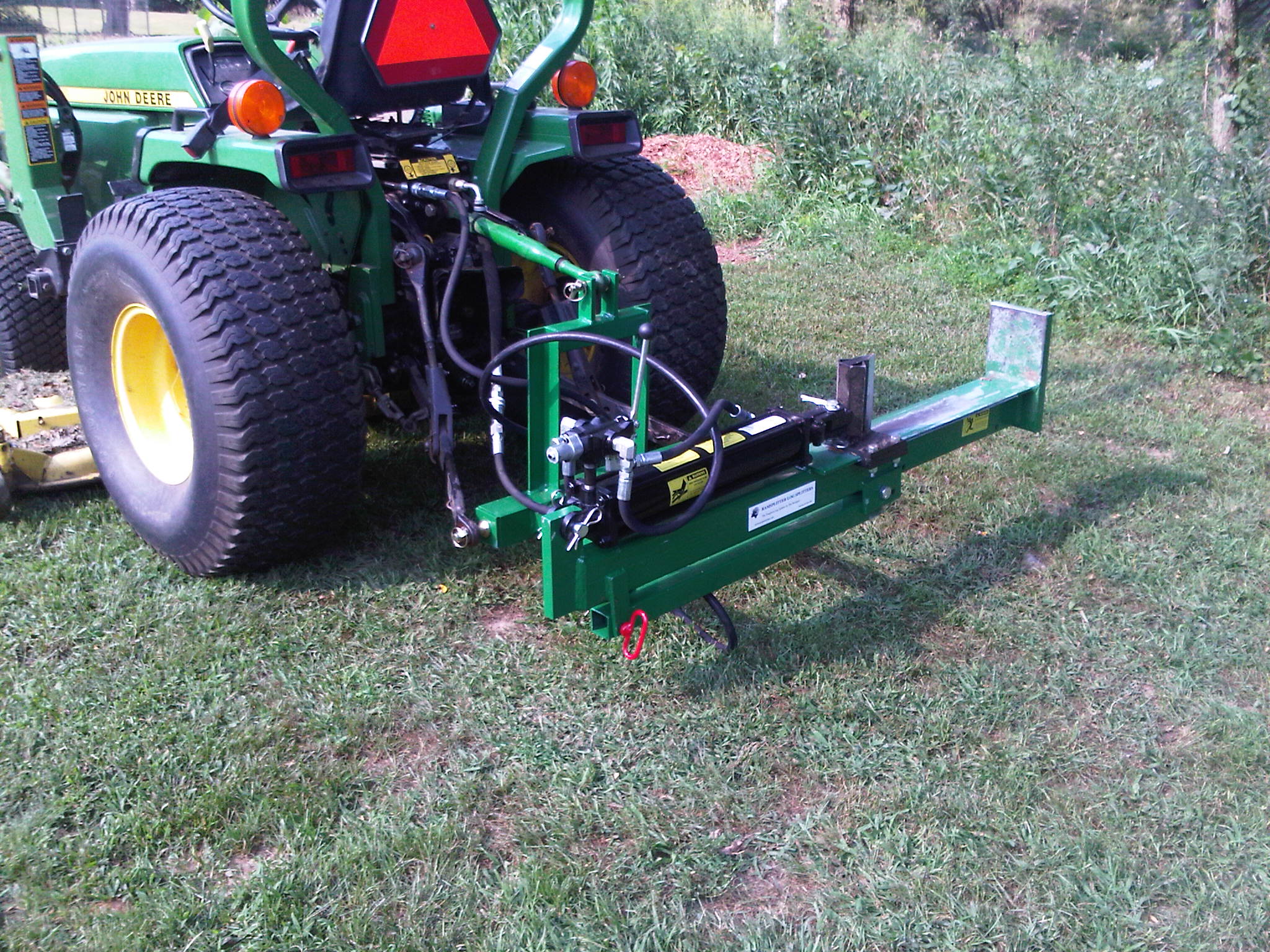

For the past 3 years I have borrowed a friend's 32 ton Huskee stand alone splitter, so this year I was forced to buy my own. My main concerns with the 3 point models were cycle time and force. I have a 955 with a power beyond kit (Thanks to KennyD on that one) that puts out 7.2 gpm at 2500psi. After running the numbers on the charts provided in a previous thread, I knew that any unit with a 4 inch cylinder would give me long cycle times, and a force that would not exceed 17 tons on a good day.
After looking at various units, I decided to purchase a ramsplitter 16 ton unit. I had it modified to sit perpendicular on the back. With hoses, taxes and shipping it was less than the 22 ton TSC model, and with a 3.5 inch cylinder I hoped the cycle time would be better.
I have since split over 2 full cords with this splitter. It was very easy to hook up on the hitch. I did it alone in less than 5 minutes. It has split everything I have thrown at it; Cherry, Oak, Ash and Maple. At 1800rpm the splitter runs at a perfect cycle time for me working alone. If I move it to 2400rpm I can barely keep up. For those worried about cycle time, at 7.2 gpm all is good. I cannot say it would be worth it at 5.6gpm. The sound of the tractor is way quieter than that of the stand alone I used in the past.
Overall, I am happy with my purchase and I hope this helps those looking at a splitter who have the same concerns I did.

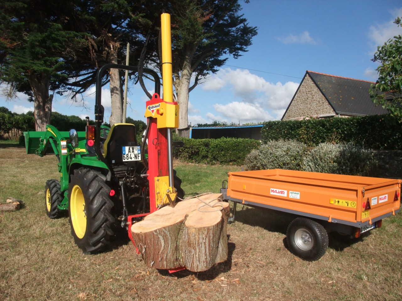

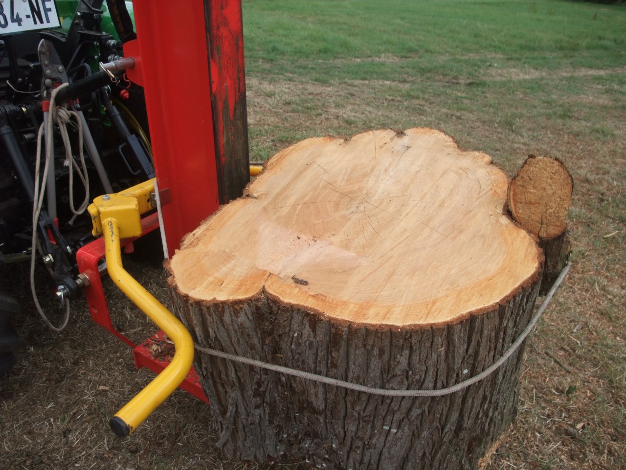

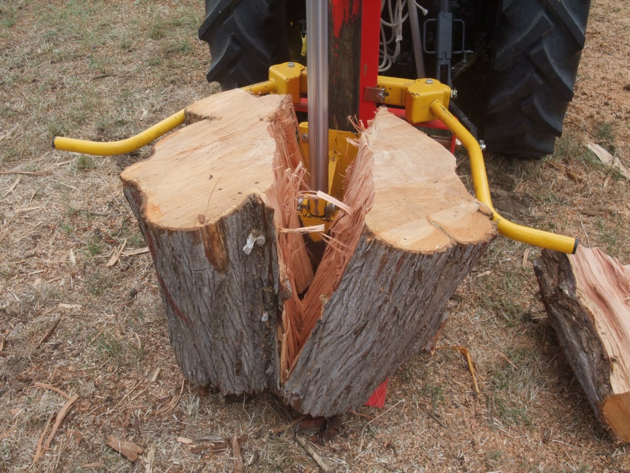

I bungee the lever on my 3rd SCV (in fact I use a small metal chain) to keep the valve open then use the splitter's valve normally. I usually run the tractor just above idle to keep noise and smoke to a minimum. The splitter seems to be rather slow, but working alone or with a second person, I can barely keep up with the machine. There seems to be a lot of overkill with the enormous pressures announced. My 13 ton splitter has split anything I have tried so far.

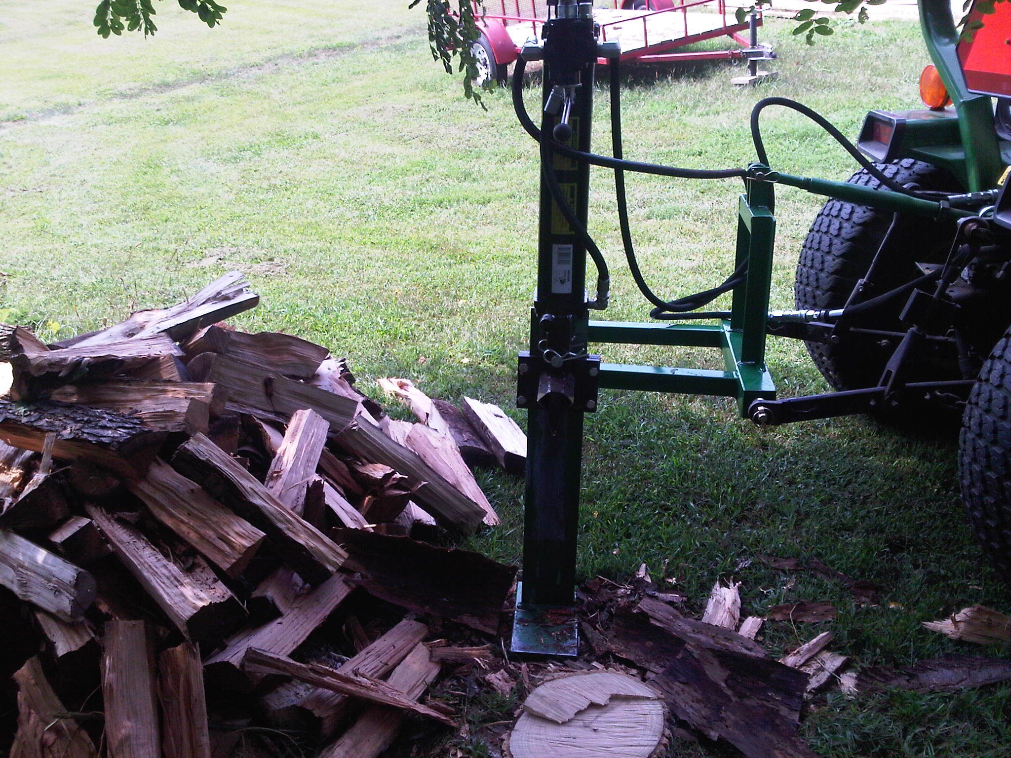

I was wondering the same sort of thing. But, in his second picture, he has the splitter in a vertical position.

I am getting the full 16 tons. The cylinder is rated at 2500psi, which is what my tractor puts out. The mount is the what they use on the 20 ton. They just modified it for the 16 ton is. If you just want a horizontal model, they sell them on ebay at a nice price.
   / Ramsplitter 3 point log splitter
Sorry. Plenty of room to work with it in the vertical position.
