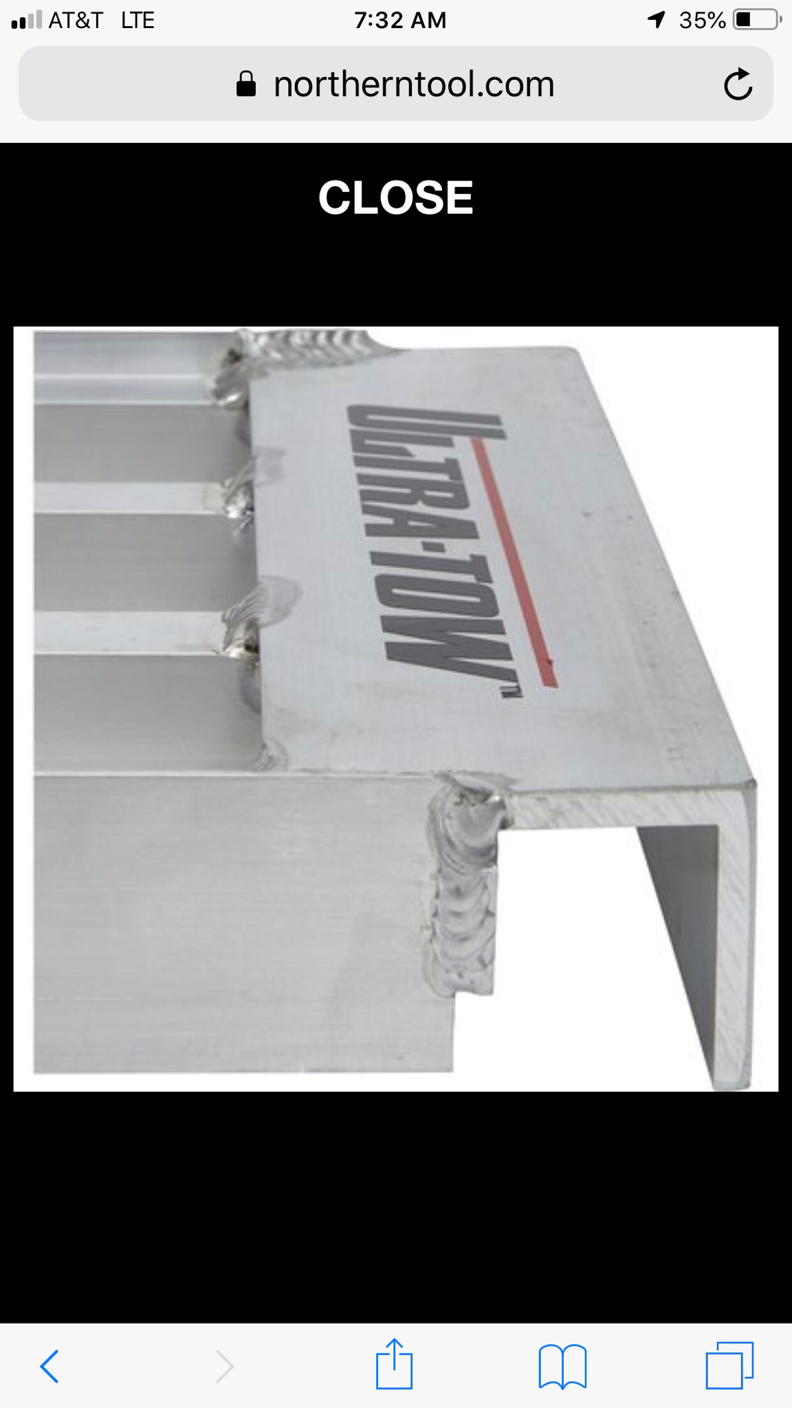

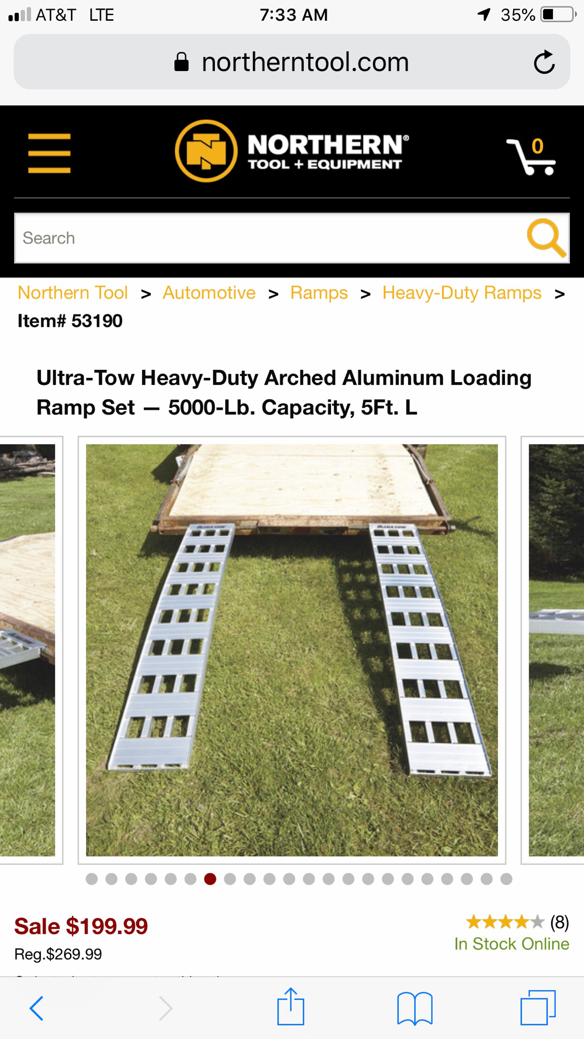

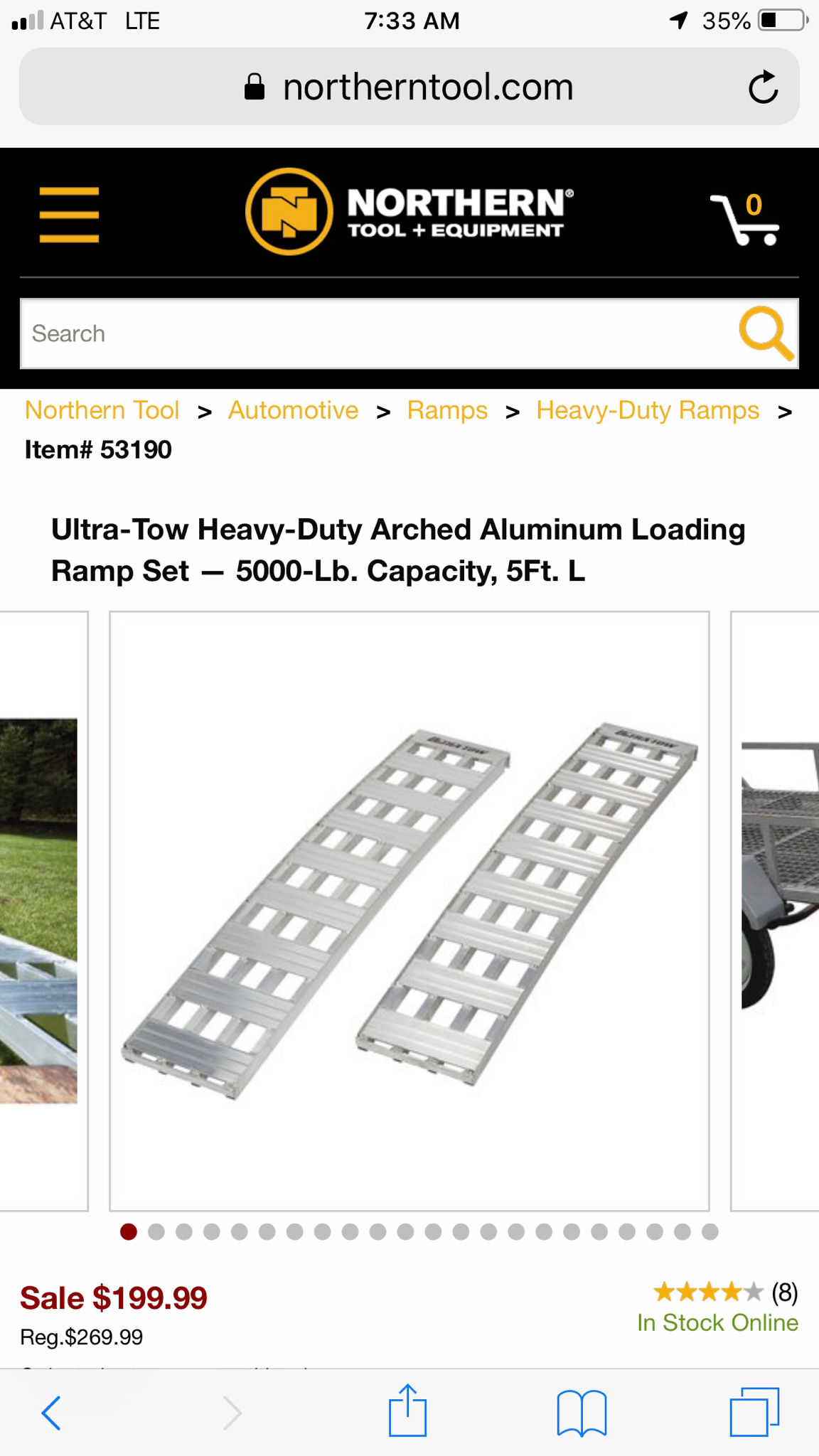

Will these work for a subcompact? Ultra-Tow 5000lb (2500lb/ramp) aluminum ramps from Northern Tool.
I asked the dealer about ramps and he just said don’t get the aluminum ones.
Tractor is 2900 with FEL, MMM, and BH.
Any reason they wouldn’t work?

Each ramp has a 2500lb capacity and you're going to be putting 1450 on each ramp. Seems that the math says it's going to be fine and you're under 2/3 capacity of each ramp. Don't know why it wouldn't work. How often are you going to be using them?

One thing with aluminum ramps is they tend to be slipperier then steel or wood.
Any ramp needs to be built for traction or have traction grips installed,
if you ever get wet tires on a slick ramp, enjoy the ride :eek:

I use a pair of flat 6' aluminum ramps rated at 2500 lb per axle. I recently tried them with my JD4310 with the loader and bush hog mounted. I estimate it to be pretty much max for them and it loaded with no issues.
One thing to look out for with arched ramps is ground clearance. I bought a pair of arched ramps from TS and tried to load my racecar with them and it bottomed out on the arch.

I sold a Farmall Cub recently and the guy rented a trailer with no ramps, he ask me if I had some. I borrowed ours from work that are arched and fold in the middle. I didn't even think about it, I drove the tractor up on the trailer and turned around and both ramps were mashed flat. OOPS. I managed to get them back to like they looked before.
