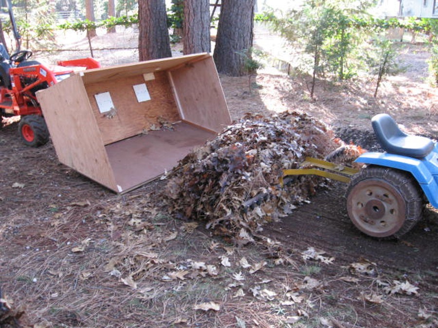

Has anyone sucessfully built a rake to hook up on a 3ph that does a good job of raking leaves? I saw somewhere on the net, maybe here, where someone built a simple rake using hay rake teeth they were using behind a riding lawn mower. It looked like it would do the job. I want to build one to pull with a YM2200 or a Ferguson 35. The one I saw was a simple bar with teeth, but I am thinking of building a app. 2 ft high cage with teeth on the bottom so I can let the leaves build up and then head for the woods, never having to actually pick them up. When I get to the woods, pick up the rake and scatter them out in a drive by fashion. I am sure it won't do as good a job as hand raking but it could sure get the biggest part out of the way to make hand raking a lot easier. I have a bagger attachment on my riding mower and also a pull type lawn sweeper to do the finish work. There is just so many leaves it will work you to death emptying them. Just trying to think of a way to get 'er done in an easier way.
Tell me your tried n true ways of accomplishing this. How close together do I need to space my tines? Does angling the ends forward help in keeping the leaves in the rake and not coming out of the sides while pulling it? I need ideas!
My thoughts are to build a 3 sided cage out of 1" tubing, cover tubing with expanded metal and maybe put a top on it to keep them from spilling over after it gets full. Have rake teeth hanging down 2 1/2 to 3 or so inches lower than the sides of the cage. Anyone tried this?

That garden tractor rake post is here and there are links in that post to building the rake and 2cuyd leaf bucket.
My system of course requires two tractors; one to rake with, the other to haul. Older used small garden tractors/lawn mowers are fairly cheap and you say you have a riding lawnmower.
I have found the rubber teeth work very well set vertical. That way I can pull or push. I can push a lot more than I can pull because the leaves do not bunch up below the tractor. Another member built a set of these (rubber rake teeth on a bar) for use as an attachment to his FEL and had some problems but I don't recall the actual difficulty. I think he used too much down pressure and the teeth folded back. Gauge wheels and bucket in float may have solved that problem. My rake is set rigid with the tractor (not floating) and when engaged with the ground bend 10-15 degrees. I built the hitch to allow for some side-to-side movement, see the rake build post.
Teeth spacing depends on what you are raking. We have primarily black oak and ponderosa pine. The 3"+/- spacing I have works great for me as long as there is sufficient debris on the ground. If cover is sparse then I'd want tighter spacing because the oak leaves pass through the 3" space. If there is a mix of pine needles and oak leaves the needles fill in the gaps.
I like your idea of a collection bin in front of the rake. But the longer you make the bin the less maneuverability you will have. Would you make the assemble pivot so it would track like a trailer? You might consider making the bin a slight trapezoid in plan, wide end toward the tractor, and put rake teeth on the tapered sides. This may help keep the leaves contained in the bin in transit.
I have found that now and again the leaves will ball up at the rake and the rake teeth will bend/flex and ride over the top of the ball "losing the load". Then I'll need raise the rake, go front or back, and re catch the load. How far do you need to move the raked leaves and what is the terrain? I have found I can push a load of leaves several hundred feet. I start at the disposal area and push a path to my burn (or compost) area then move further and further away pushing the new load down the established path. My ground is level, cleared and the pathways are dirt/clay/solid surface.

RedDirt, I like your set up. I found the rake tines at TSC for $2.29ea. My question is if I spaced the tines closer together, using more tines wouldn't I be able to pull more before the tines started to bend. Also have you broke any of the tines.

I have found that the leaves and pine needles do a good job of filling the space between the tines. That is, unless there is not very much to rake, then they just go through the space. The object here is not rake "too often". I can live with that.;) I don't think more tines would make too much difference with the tines bending/flexing with a load especially if the leaves are dry, not wet and heavy. The rubber mounting of the tines are fairly stiff. Their advantage is that they will flex over an immovable object like an exposed root or boulder.
No, I have never broken a tine. This is the 7th year I've used the rake.

I have 5 acres too. If you are on sandy flat ground then you should not have any trouble pushing your leaves wherever you want them. You'll be surprised and pleased at how much you can push.
I built a push brush rake, hydraulic lift, trip lever dump, for the Wards tractor before I had the bx23 and although I could not lift the weight I could push two/three full pick-up loads of limbs and brush (at once) when we logged. I was amazed. I had tire chains and wheel weights on the Wards. Sorry no photos. The brush rake used 5/8" rebar for the teeth and back guard. If I was careful not to dig a tine in the ground and watched my swing not to hit a tree the 5/8" rebar worked well. I bent a tine a couple of times in 5 years but they bend back into shape easily. If you want photos I can try but it's snowing now and the rake is in storage.
