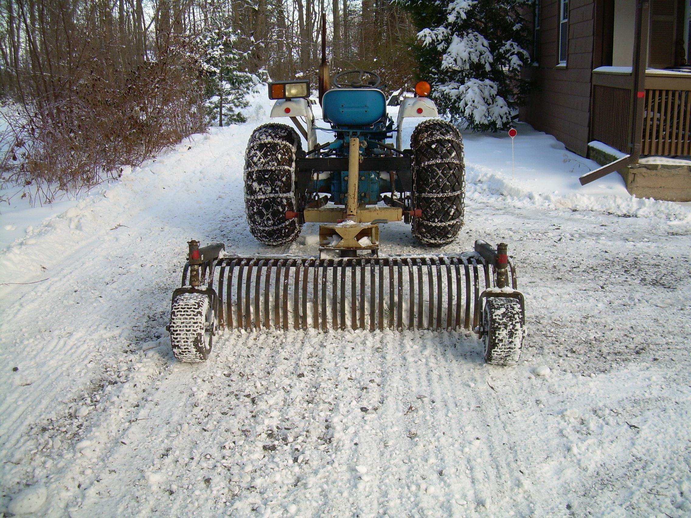

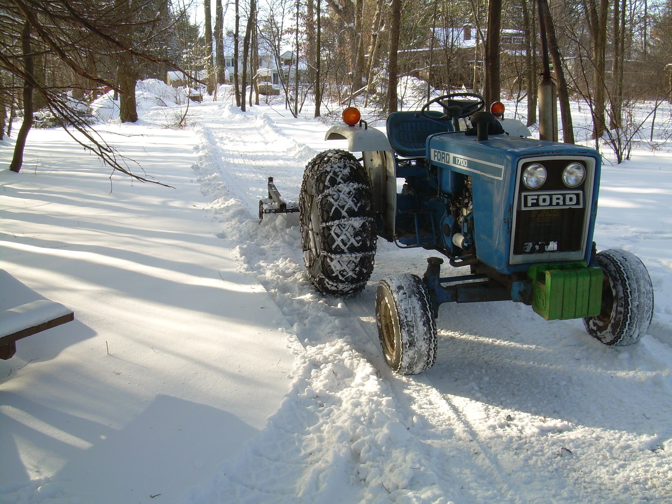

Well I had a chance to try my 6' land pride rake for snow removal. Have heard alot of positive comments but from my first attempt I'm not convinced, we only had 5" of light powder Sunday and it didn't work very well, I tried it on a woods trail and it took several passes with it angled to get it down to where I could groom it with the rake straight.

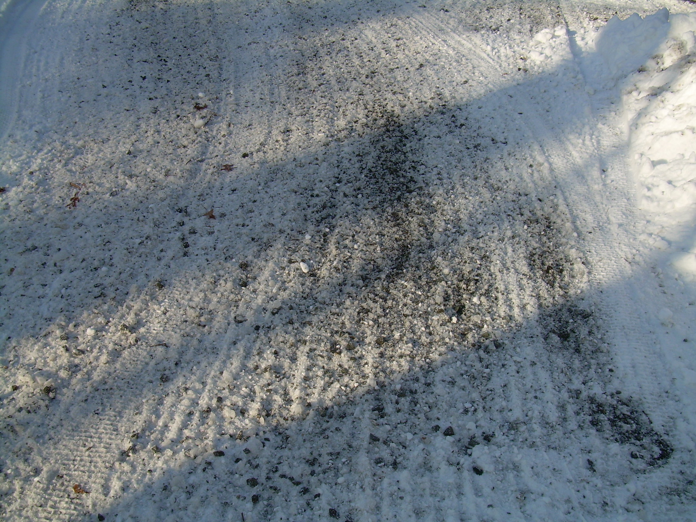

It did work great for grooming previously cleared gravel drive and yard areas as many here have stated, where it would dice up the ice and leave a high traction surface of chopped ice and gravel.
JB.

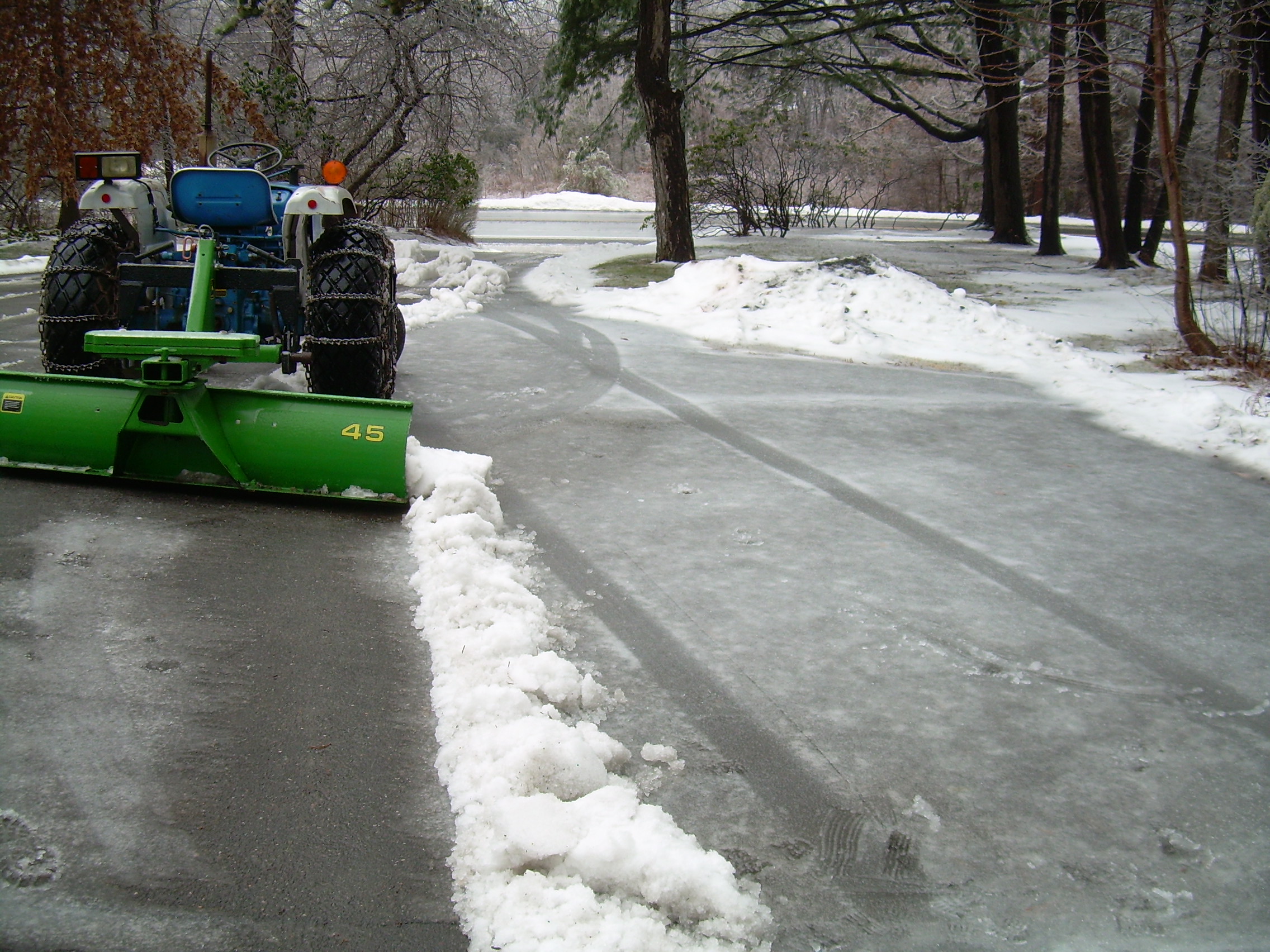

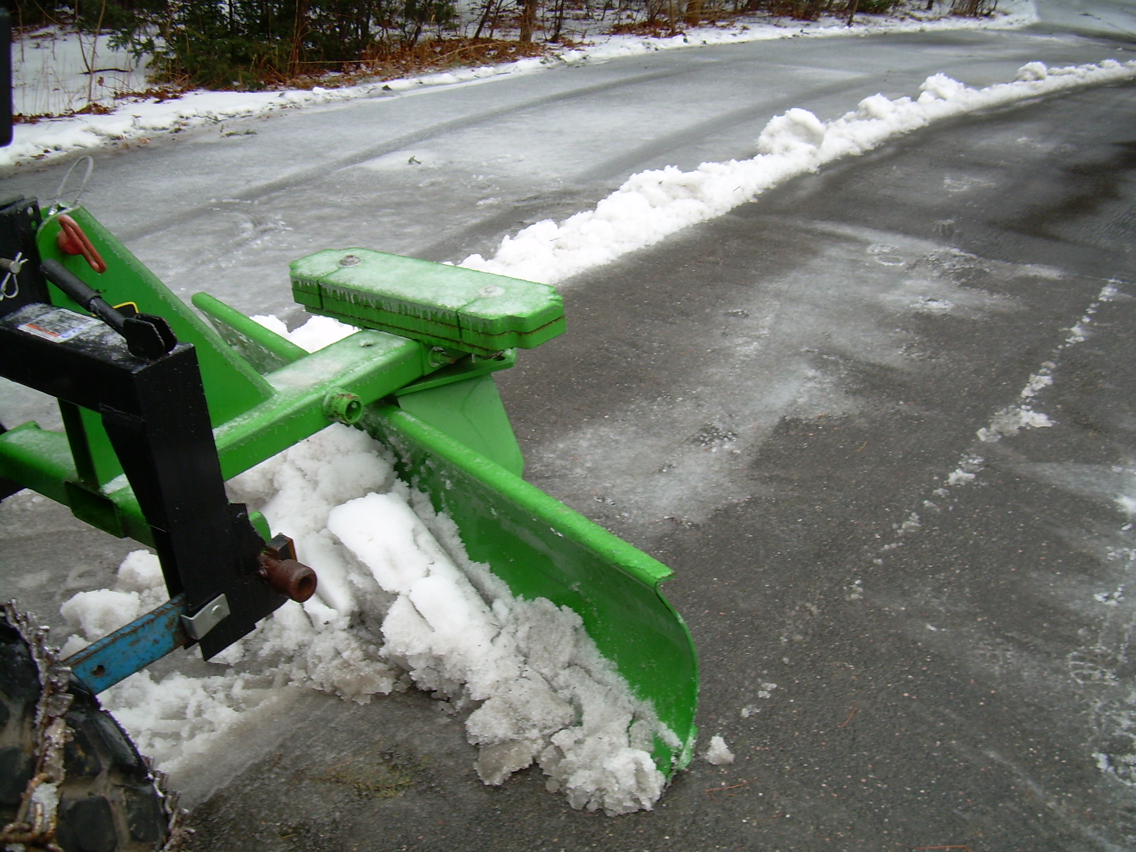

Here's a couple of pics showing rear blade peeling ice from pavement, it was frozen solid but warmed up just enough to allow the release.
JB.

The rake has to be angled way over and it is not necessary to have rake all the way to the ground on the first pass. In fact, I stay a couple inches off the ground. Works great for me, but I have an 8 ft rake. Maybe a wider rake works better?

Looks to me that the rake didn't do all that bad of a job on the gravel drive.
