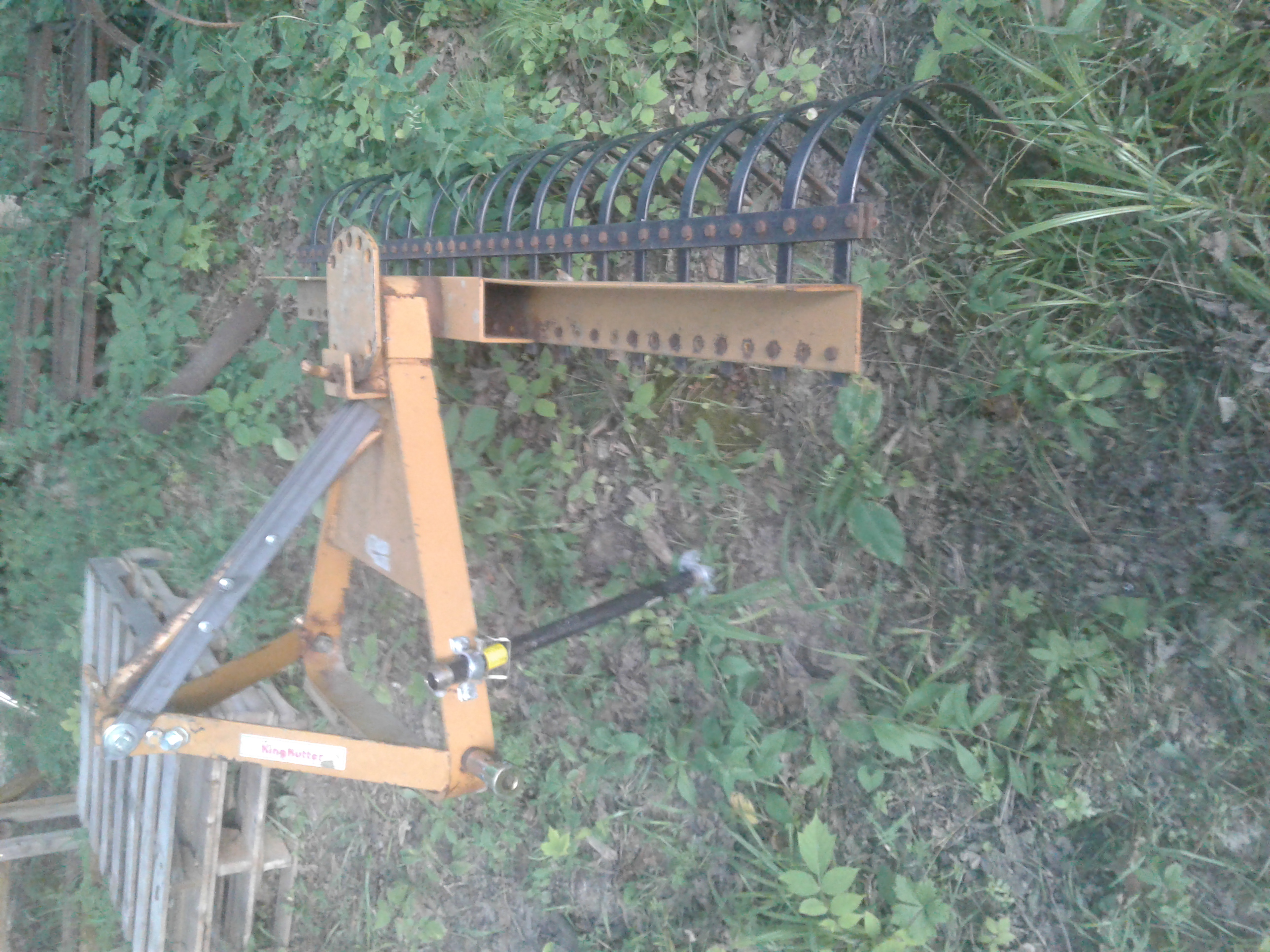

1st time I removed every other tine, I was getting washout from local cement plant. I was separating 3"+ rocks from everything else. Now removing 80-100 dead trees from our woods. Branches shatter when tree is felled, also grapple breaks pieces off transporting debris to burn pile. These 1"+ pieces wedge between the tines as they flex when dragging rake.
If you find a cheap used rake remove every other tine - different rakes for different jobs.
The old "junker" rake was not QH compatible. How I modified it can be found here
Ideas to make implements QH compatible | OrangeTractorTalks - Everything Kubota
