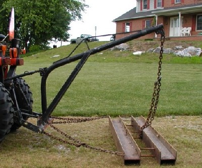

Some of the regulars have already seen this. It's a couple of steel beams fastened together with 6 pieces of 1/2" allthread. By lengthening/shortening the two lower chains, it will cast the loosened material to the right, left or straight.
My first tractor didn't have a 3PH, and it was pretty unhandy not being able to pick it up. With the boom pole, it is 100% nicer to use. Since our main driveway has been paved, it hasn't seen a lot of use. About the most it gets used anymore is to flatten out the sand volleyball court................chim
