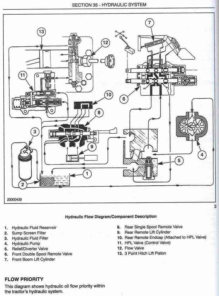

The manual for my tractor says not to operate the 3ph position lever when the rate-of-drop valve is all the way closed, because it will put the system into relief and can overheat the hydraulic oil. Seems pretty straightforward. But in another thread on TBN, someone said that, on their tractor at least, the valve only applies when the 3ph is lowered, and raising the 3ph with the valve closed didn't matter.
I don't know much about plumbing on these tractors. Can anybody speak to this discrepancy? Is this just something that is different on different tractors, or am I misunderstanding something?

The only real way to know what is going on with your 3PH system is to have a hydraulic flow diagram. There are certainly various ways of implementing flow and control for various brands/models. In the diagram below of my New Holland TC45D, the hydraulic fluid flows from the HPL control valve (#11) and into the flow control valve (#12). The flow control valve is a drop control needle valve, a ball check valve, and an emergency pressure relief valve if there is a sudden down pressure applied to the 3PH like something dropping onto a raised implement causing the lift cylinder to see excessive pressure above 3500 psi. The normal system pressure maximum on my system is 2500 psi.
By following the flow arrows, you can see that fluid will flow in two directions in the HPL valve. The direction depends on whether you are raising or lowering the lift arms. When the arms are raised, the fluid bypasses the needle valve and goes to the ball check valve. The ball lifts and allows fluid into the cylinder (#13) to lift the arms. When fluid stops flowing, the backpressure closes the ball check valve and pressure is applied to the needle valve and the emergency relief valve at the same time. If the HPL valve is moved to lower the arms, fluid flows through the needle valve opening. If the needle valve is completely closed, no fluid will flow because all three valves are closed, trapping fluid inside the lift cylinder. If the needle is open, fluid exits the cylinder at a rate set by the needle to allow a controlled dropping of the implement.
With a flow diagram such as this, you can fully evaluate what occurs inside your system. Without a diagram it's just a battle of SWAGs and opinions.;)

Where can I get the flow diagram? Dealer?
