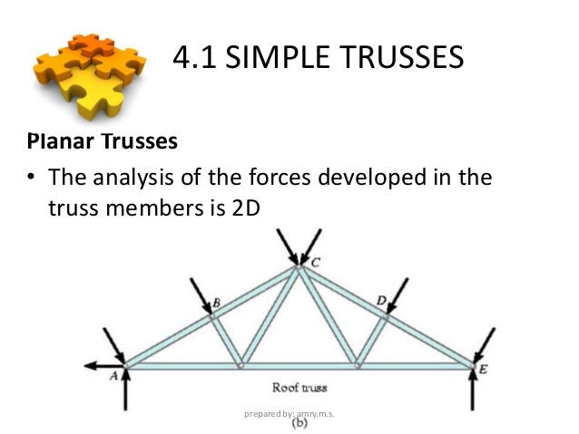

"cutting out the bottom of the rafters" Is a scary concept! Using the terms labeled here on this simple W roof truss diagram below, the bottom chord is under tensile stress as a result of weight bearing down on the A shaped frame composed of the top chords. The web is designed to reduce sag in the roofline and bottom chord by creating a structure that is dependant upon triangulation. If you mess with any of these parts you have significantly altered the strength of the design and you will create side loads on the bearing walls. Your load bearing side walls will tip outwards at the top and the building will collapse if you mess with those bottom chords, guaranteed.
I majored in Architectural Drafting and Structural Engineering was my strongest subject in school ;) you can truss me on this.
I was going to do this same thing where I live now but never got around to it. What I thought I could do was cut a 2x6 or 2x8 at the correct angles to sit on the top of the wall and come together at the top, and nail both to the side of the truss. Then drop down a certain amount and cut another 2x6 or 2x8 to create a "cross tie" to make it look like a "A" from the side. Probably use some sort of plywood to attach the cross tie to the rafters. Once that was in, then cut out the bottom of the truss.
I know the truss is complex, it must be because it's only made out of 2x4's. But I was going to make my auxiliary structure simpler and with larger wood. That should work correct?
Actually the truss is complex because it needs to be, the triangulation designed into its shape is what enables it to be constructed of 2X4 lumber, that and because it is a garage and not designed to support a second floor with living space. As for using larger lumber and not retaining a shape that is acceptably structural, nope, sorry but it doesn't work that way.
I get the feeling this is what you are trying to achieve, but you will notice that this type of roof truss requires 2 additional load bearing walls inside the structure:
(indicated by the little rectangles with the X's through them)
