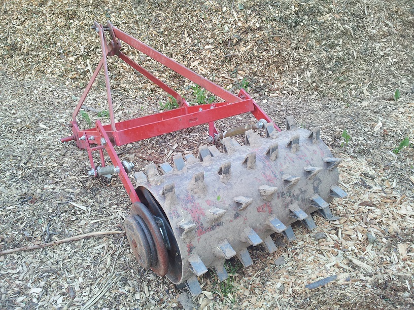

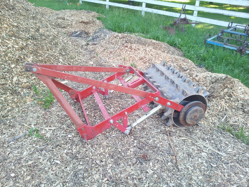

Our next move was to create the "Wheel of Doom". So called because it has 7 rows of spikes that when pulled through the field would mark out the holes for us.
Originally it had cultivators in front, but they didn't make the ground smooth enough for the spikes to mark a hole so we removed them and used a rototiller set shallow first, then went over with the wheel. This has worked ok, but thanks to the geometry of the spikes they tend to kick the dirt on their way out of the hole and fill it partially back in. While we could still see where we were supposed to put the transplant, we had to either open up the hole with our fingers, or force the seedling into the ground. This added more time to the process and was probably not great for the root system. Sometimes the holes were so bad you just had to guess where to put the plant for a few feet.
While just changing the geometry of the spikes would have almost been enough, we wanted something a little better. A neighbouring farm was out prebedding with their raised bed maker (prebedding is when you make a bed in the field with no plastic before going over it again with plastic...makes a firmer and more even raised bed for the plastic and keeps it tighter), I asked if I could try my wheel on the beds and it made a significant difference running the spikes over a slightly packed, more level surface.
So this leads me to my post title. My current plan is to build a raised bed maker, modify the "Wheel of Doom" and combine them into one package to give me a better end result.

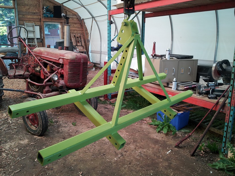

Before paint:
After paint:

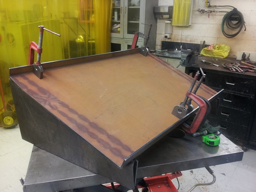

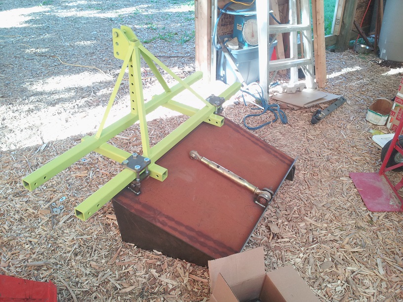

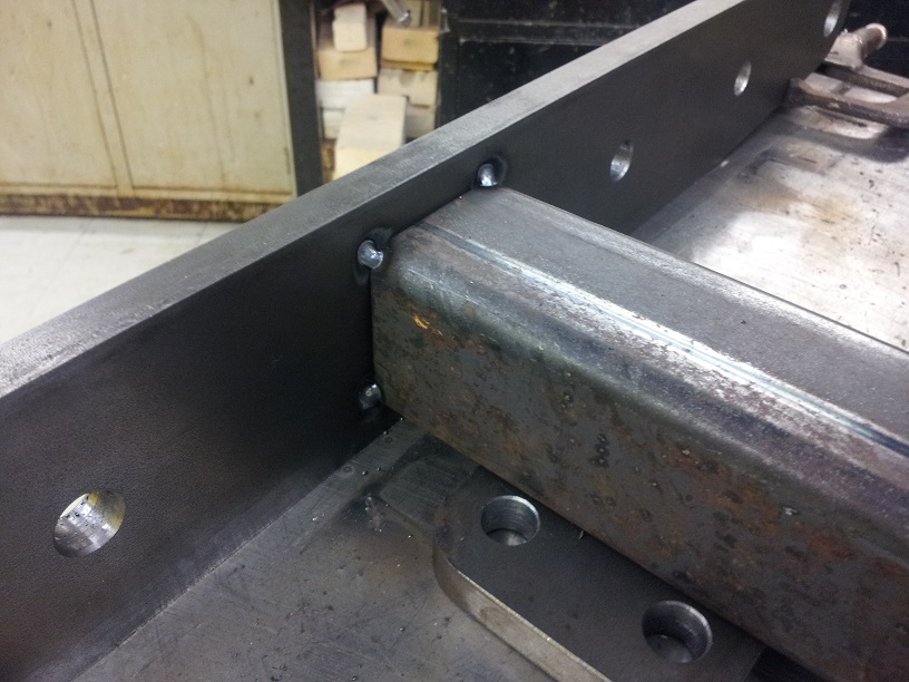

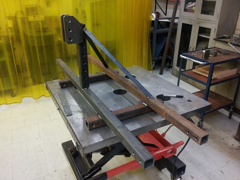

The toolbar seen in the above post is made from 2x2x1/4" square tubing. This seems to be a common size most people use for making these. The unit is 5' wide and I have the square tubing set on 12" centres.

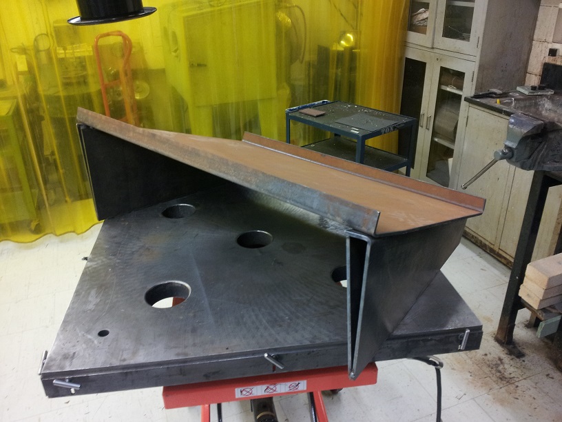

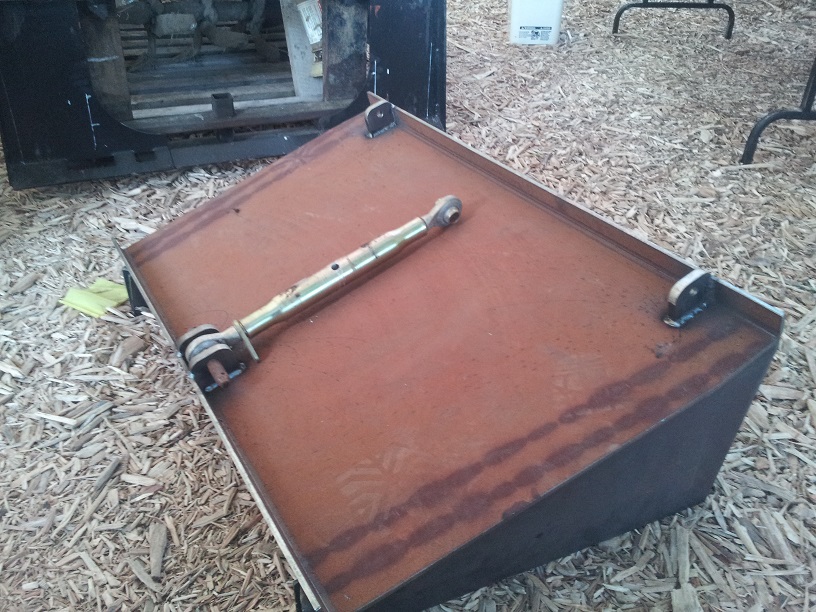

The following are some photos of the press pan. I have not had too much time to take pictures of the build process, but the pictures should give you an idea of how it went together.
The press pan and sides are made from 1/4" plate steel which I had a local steel company cut and bend for me. While I could have cut the steel out myself and welded angle on in place of the bends, it was a lot easier to have them do it and it looks considerably more professional with the bends.
Front attachment points and rear attachment point for the toplink clamped and ready for welding. I will use a top link to keep the back stable so I can adjust the angle of attack for the press pan.
Photo of the press pan all welded up with the top link and ready to get attached to the toolbar.
That is all I have time for now, but check back soon for more.

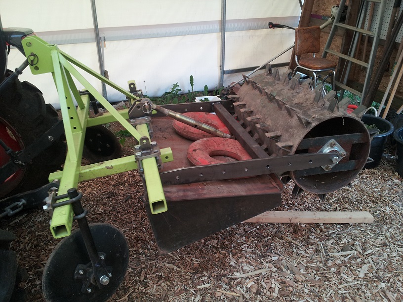

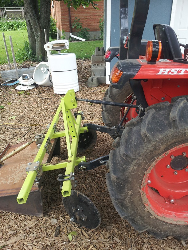

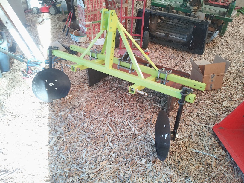

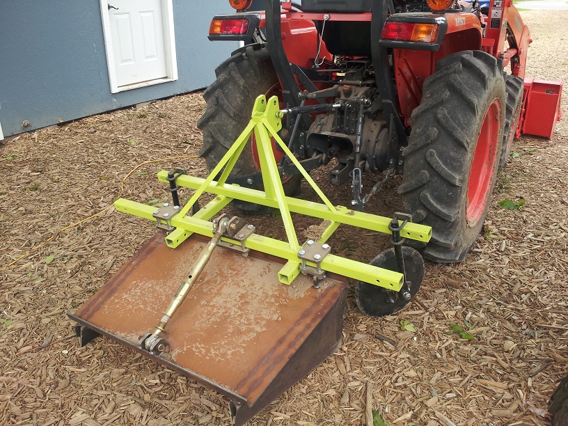

The following are some photos of the raised maker all assembled. I made a bit of a mistake in how the press pan attaches to the toolbar and just need to make a longer attachment piece. It is hard to see from the photos but all it means is that the toolbar ends up sitting tipped back towards the press pan and cannot be straightened out without the top of the press pan bend hitting the bottom of the toolbar pieces that run forwards to backwards.
Photo of the raised bed maker with the hillers set up in front. I made my own U-bolts to hold the hillers to the toolbar.
Here you can see the toolbar tipped back at an odd angle. One of the side effects is that if I lift the implement up too high the hillers will hit the back tires of the tractor. Adding taller stand-offs will allow the toolbar to sit level and will fix this problem by moving the hillers backwards and changing the lifting geometry.

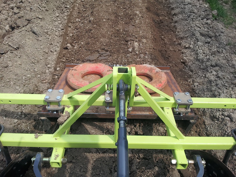

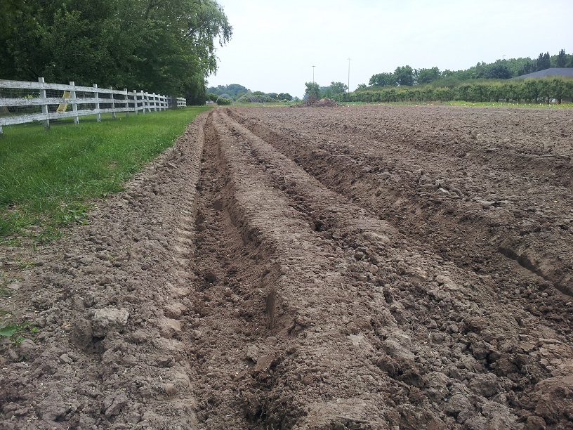

/ Raised Bed Maker w/ Transplant Marker

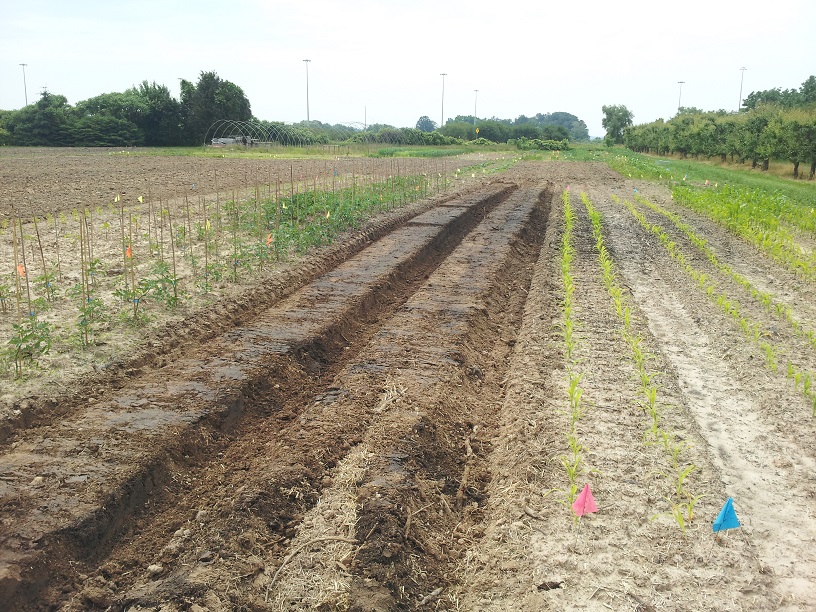

Here are some pictures of my first attempt at making the raised beds. I had a bit of a hard time getting soil all the way to the centre of the bed, but a second pass over helped quite a bit.
I added some old wheel weights I had lying around to the press pan and it helped with smoothing out the top a lot. The last beds I made turned out really well.

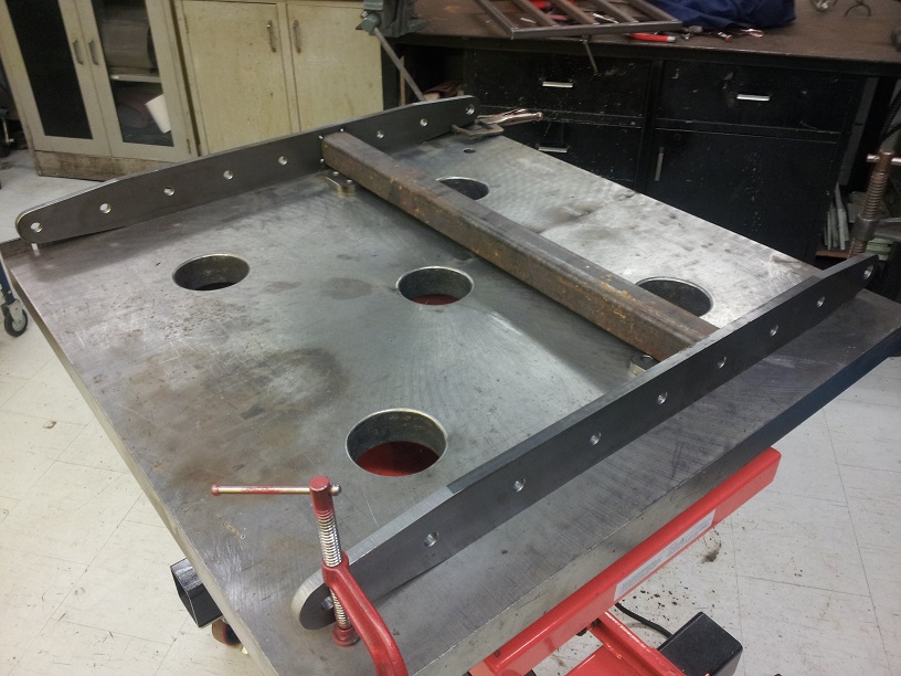

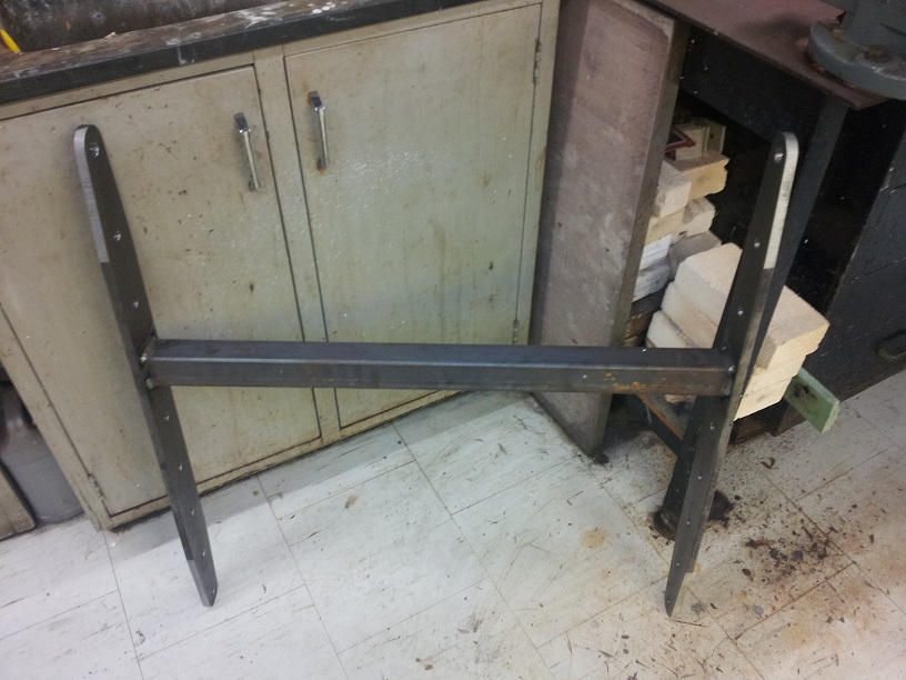

Today I worked on making new arms for the spike wheel to attach it to the raised bed maker.
Tacked together and ready for final weld.
Welding finished and ready to be attached to the bed maker and wheel.

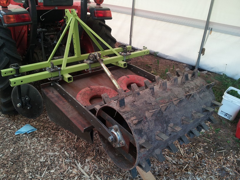

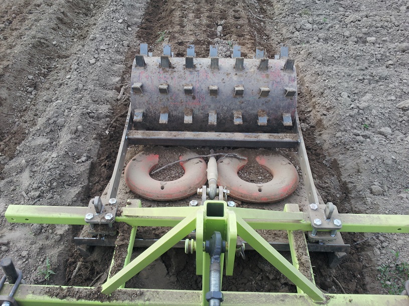

#9

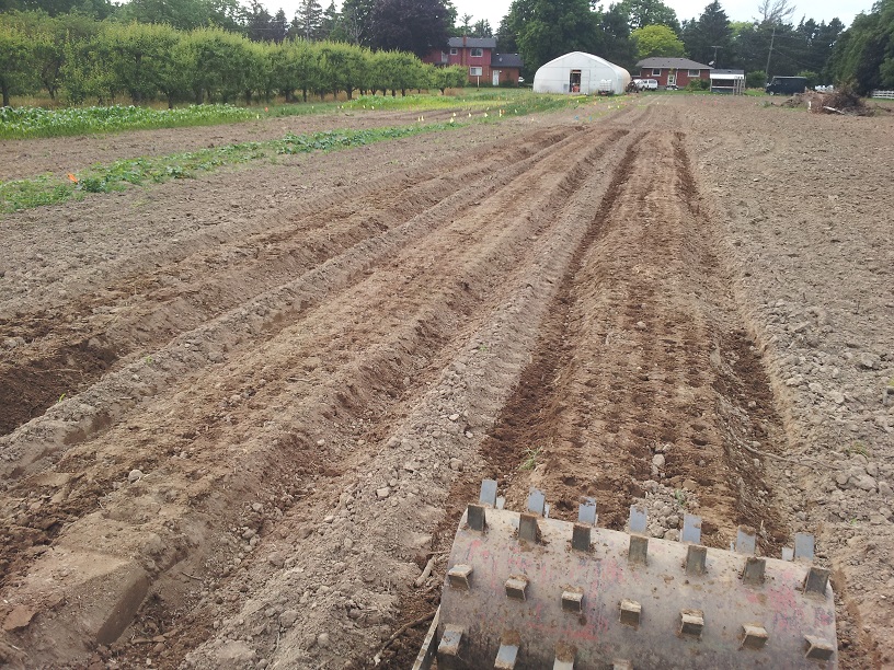

Last night I attached the transplant marker and took it out for a test spin. Seems to work fairly well, but I had to make two passes to get it where I wanted it. I hadn't cultivated the soil in about a week or so and it has been really hot so the ground was quite dry. I find both the raised bed maker and transplant marker work best with some moisture in the soil and I would have needed to cultivate first to bring some ground with more moisture to the surface.
A couple shots from the tractor seat:

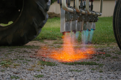

The general idea for next year will be to prebed the entire field and then flame weed the beds pre-planting to exhaust the seedbank in the soil. I made a tractor mounted flame weeder last year that I belly mounted on a Farmall A, but had some problems with it and will need to rebuild for next spring.
Here is the only picture I could find of the flame weeder in action:
/ Raised Bed Maker w/ Transplant Marker #10
Will you tell and show us more about your flame weeder? :applause:

/ Raised Bed Maker w/ Transplant Marker #14
Creekshore - I love your welding table! What is that - like a 2-3" thick steel plate top? Wow. And nice work on the implements! :thumbsup:
#15
Its 2" cast iron. Weld doesn't stick to cast so it is great to weld on. Was blanchard ground on top so nice and flat. I work for a machine shop so one of the benefits is being able to build stuff for myself on the side.
