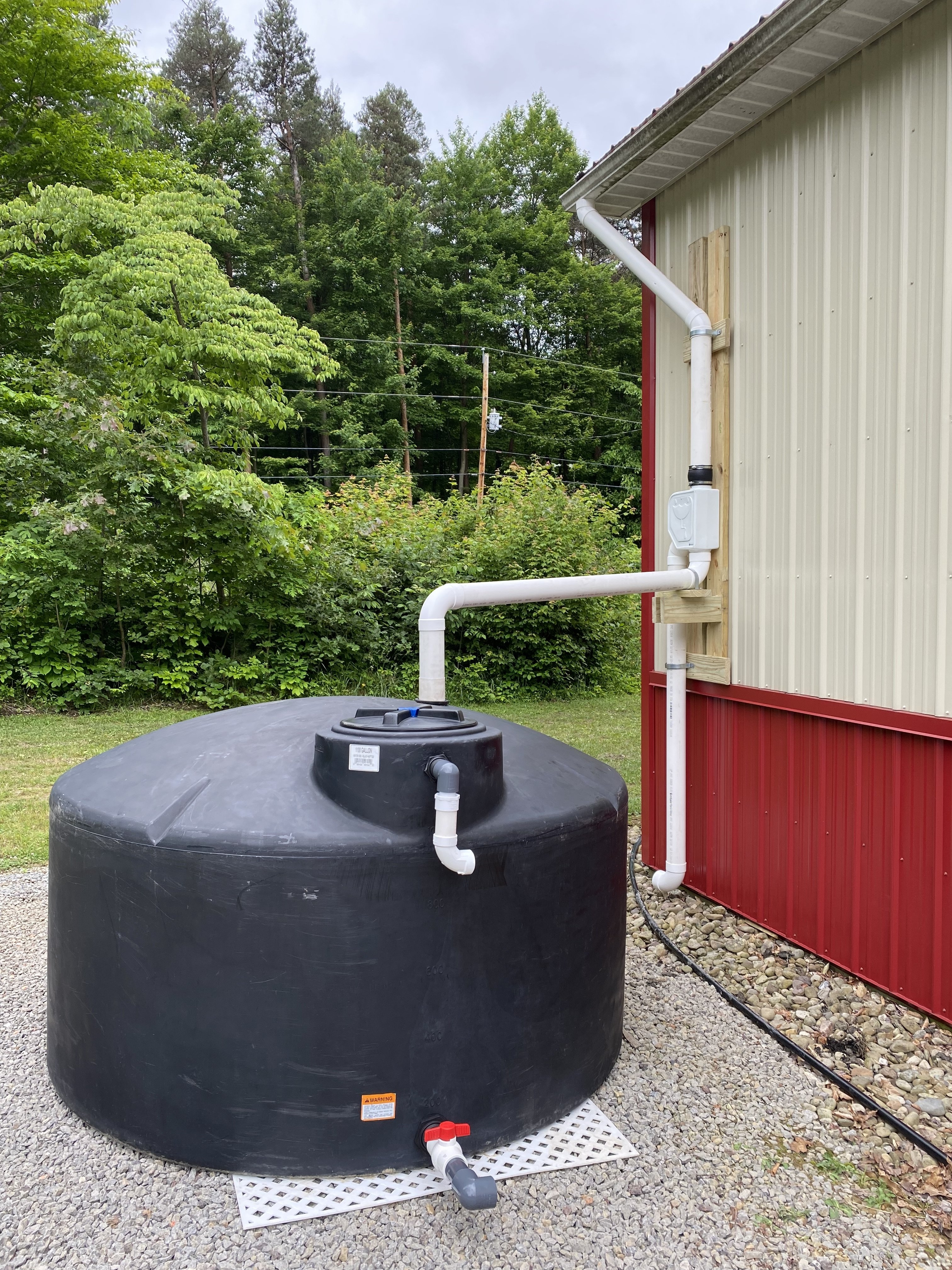

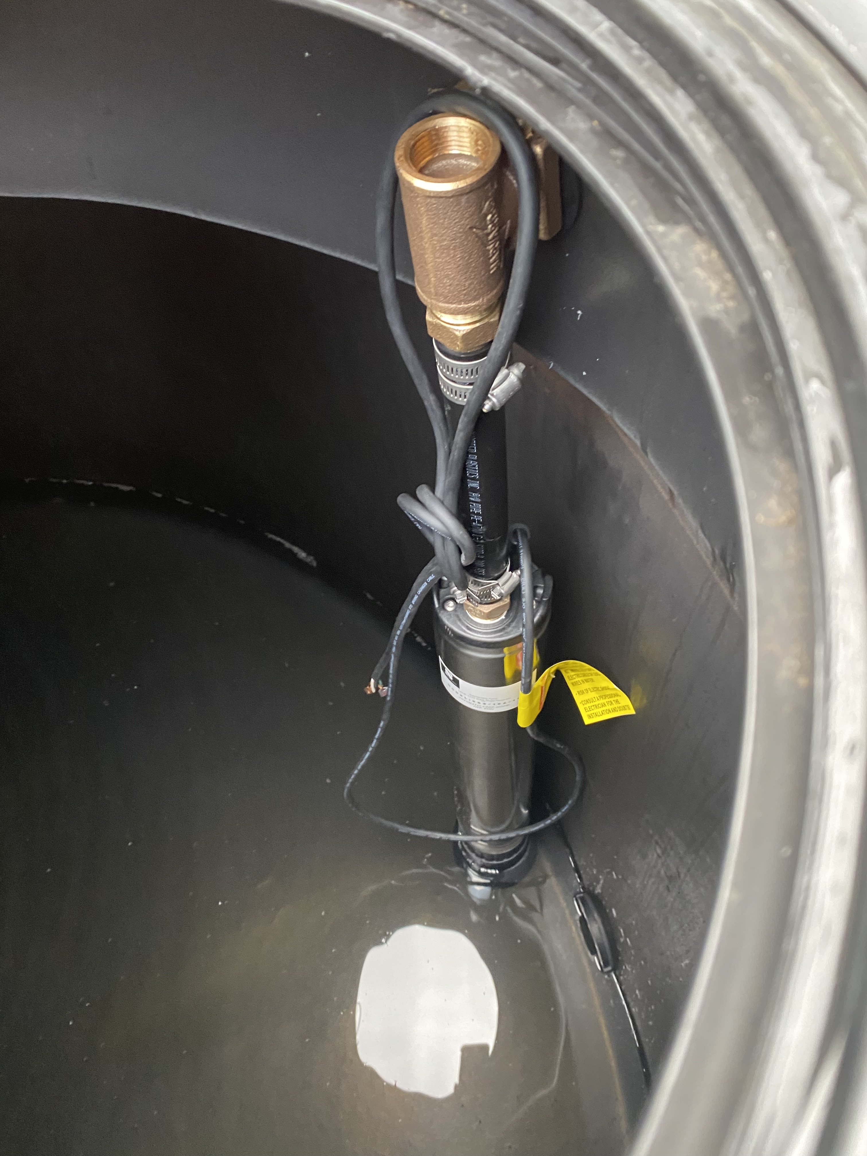

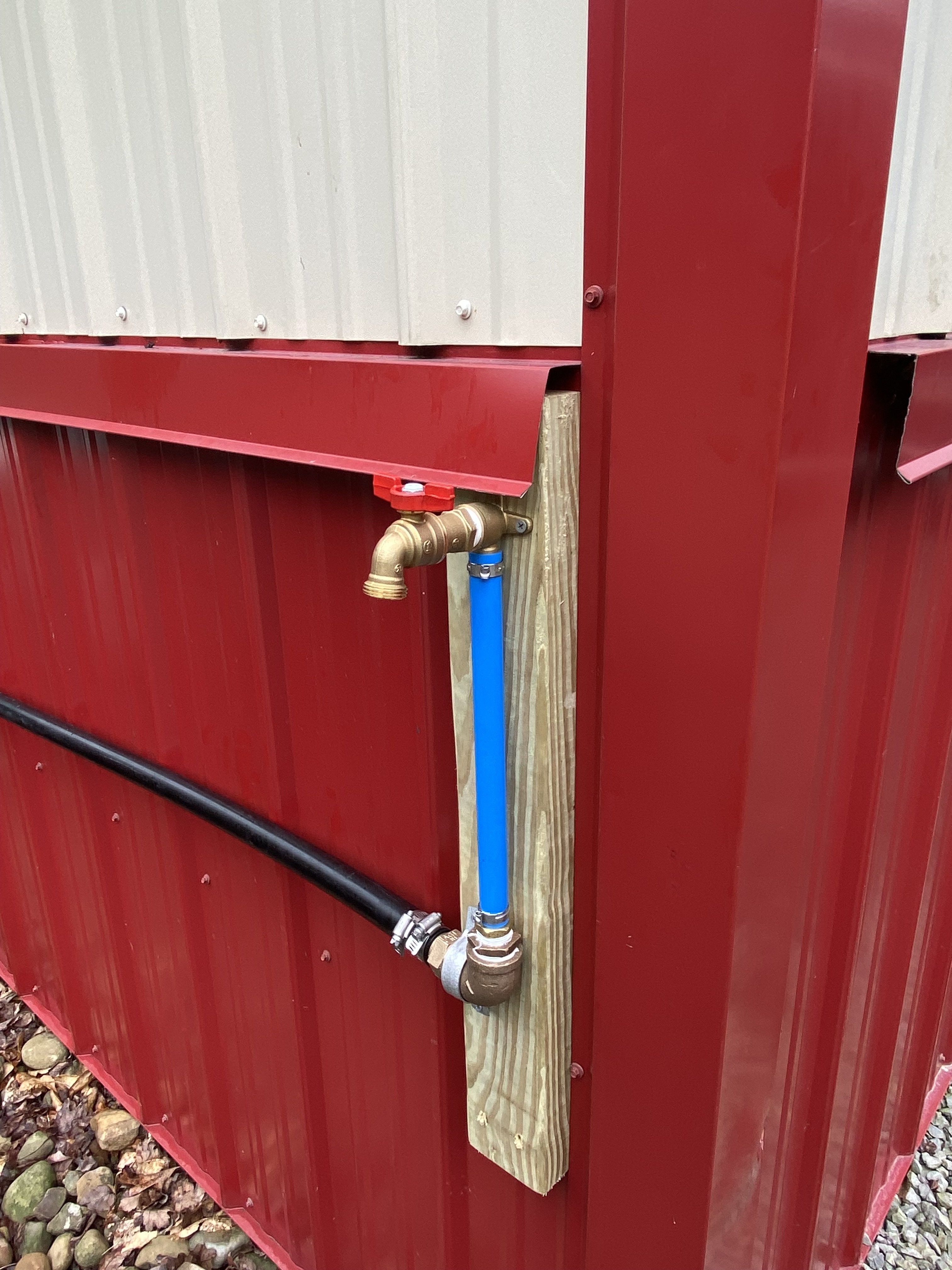

I bought this 1100 gallon tank 2 years and finally got around to installing it. The water will be used mainly for watering the garden and cleaning up my equipment. Its a simple system with a Special Pump from Rain Brothers in Ohio. The pumps does not require a pressure tank and pressure switch. The control logic is contained inside the pump. When you open the spigot the pump senses the loss of pressure and starts pumping. When you shut the spigot off the pump senses the increase in pressure and shuts off. I mounted it in the tank with a pit-less adapter like you would use in a deep water well. There was a 1/4” of rain yesterday and the tank filled to about 4” or close to 100 gallons.

Nice set up just curious why you installed it. Remote building not served by well or town water ? Save money on town water, reduce wear and tear on well pump ?

What kind of water pressure does it produce? I could see this being an option for my drip irrigation. Gonna look them up. Thanks for the idea.

Great question. I do have spring water from my underground tank in the pole barn, but I don’t like using the spring water for washing equipment and watering the garden during the summer months because we use it in our home as the primary water supply. I try to conserve water during the summer months when the spring is running slower. We have no city water where we live.

I get about 60psi from the system but they don’t recommend using this type of pump for drip irrigation system. They recommend a system with a pressure tank and pressure switch. I bought mine from Rain Brother in Ohio. Great question good luck.
