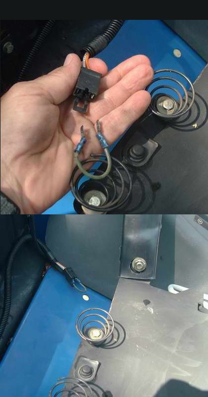

If your frustration level builds high enough Chris, this solution will work. I've had mine bypassed since the first week I owned it.:thumbsup:
   / Rain, Freeze, E-Brake switch kills circuit. #8
Yeah, 10-4 to that... not to piss off the safety gods, but I got so sick of my TT75A not starting, cutting off, not to mention getting after dark calls from the neighbors telling me "my barn was beeping" that I bypassed the seat switch for good...
