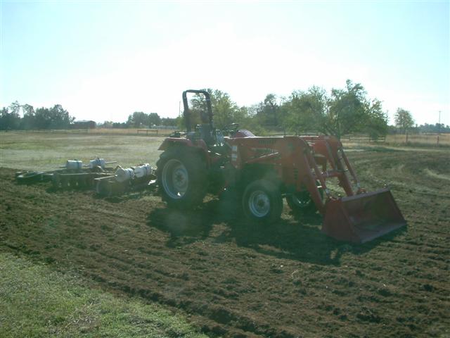

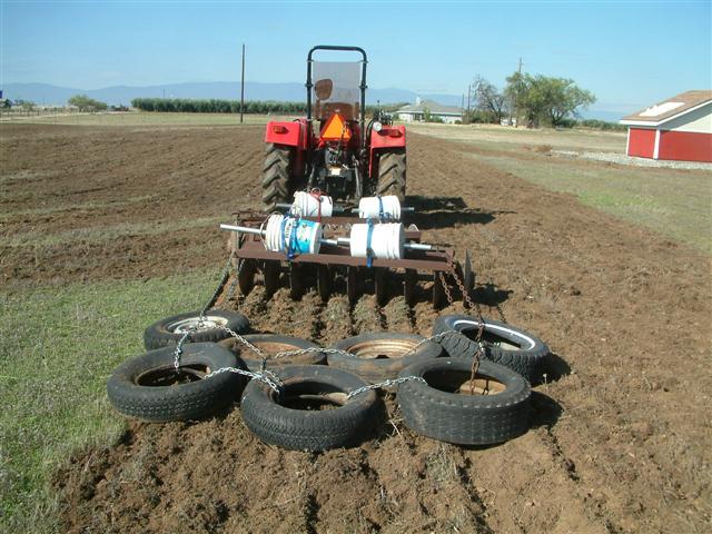

I used 120-lb concrete weights on my 7-ft Towner offset disk and towed a drag behind. Here's one version I used with a tire drag. Later I used a piece of chain link fence with the tires attached to the top for weight. That one worked better.
The tractor is my Mahindra 5525.
Good luck
