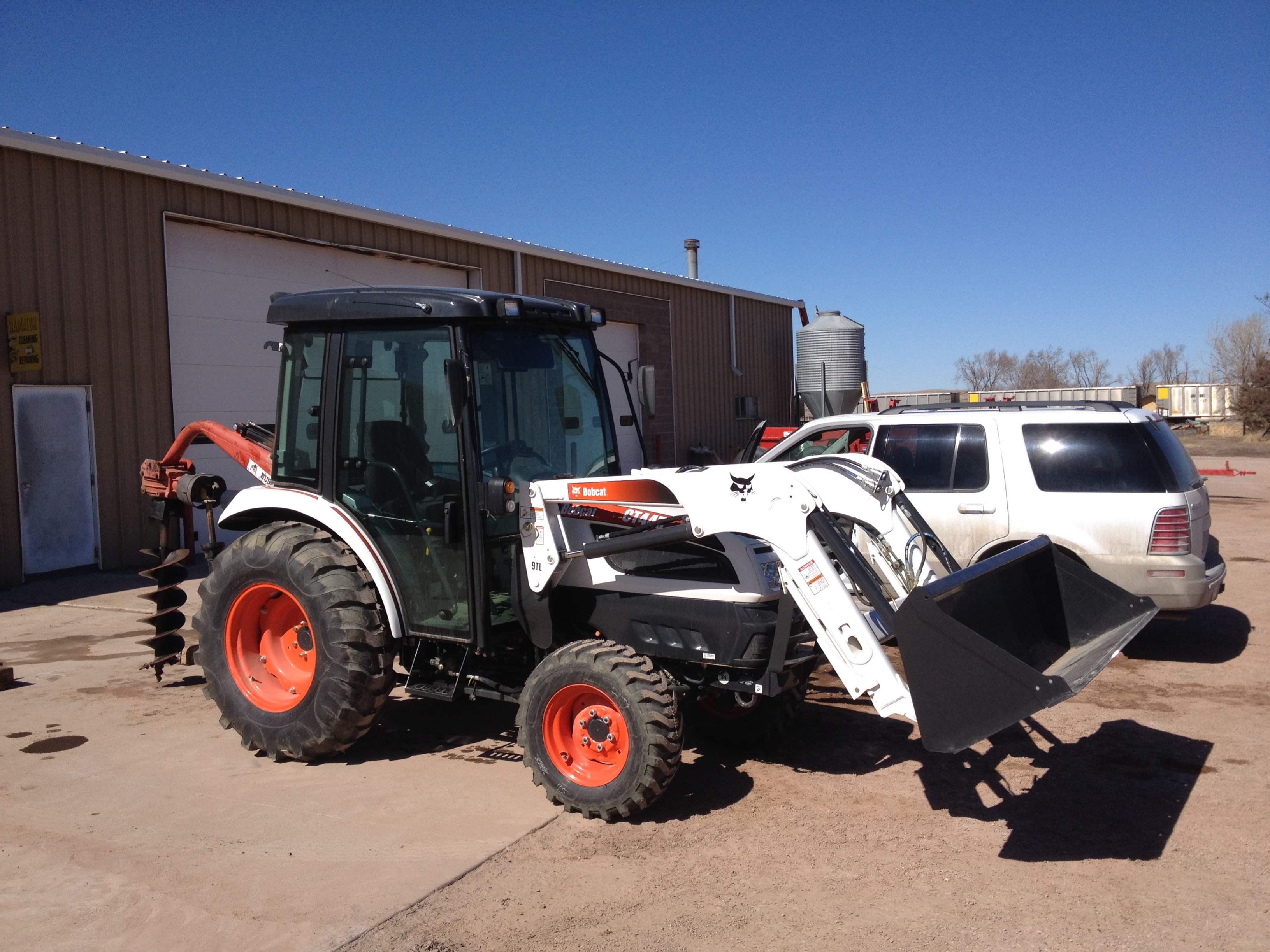

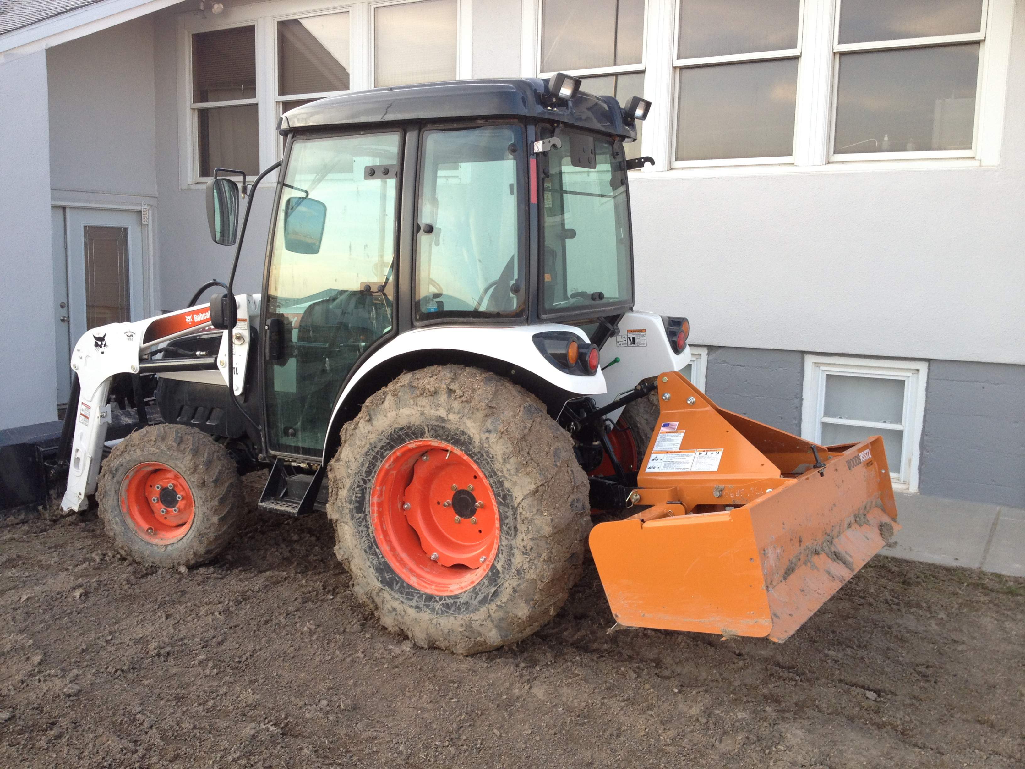

I have been doing some searching for the correct wiring harness that would allow me to install an aftermarket radio in the cab of my CT445 which appears to be wired for a radio and 2 speakers. I fond some old 2010 threads on this fantastic site which talked about a $19 adapter but no part numbers or follow ups with results of the install. Have any of you guys installed a radio in your Bobcat tractor? Is there a reasonable factory kit that I am missing that might work better?
It must not be a factory Kioti cab as it did not come standard with the CD player. I also don't believe it is a cozy cab. Possibly Bobcat made it's own cab as far as I can tell it is of OE quality and factory installed.
My dealer is looking into it. They are not terribly knowledgible as this is the first one they have sold with a cab. I called on Monday and they were going to look into it. Hopefully this goes better than the front bypass/aux hydraulics went. This place does not sell many of these little tractors and don't seem to be terribly experienced at the accessories. I was trying to figure out if there was a simple wiring harness adapter as you can buy what appears to be the same Jensen radio that Bobcat sell at several places online.
