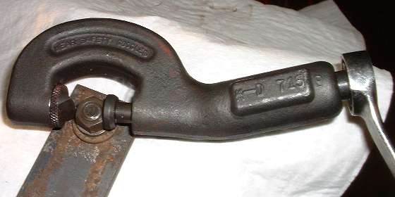

Okay so I have everything drained and flushed and I need to remove my radiator as it is beyond repair and sketchy as ****. I can't manage to understand how the **** I am supposed remove the two bolts on the bottom of the radiator. Any help is appreciated, James

The 2 bolts are captive in the rad, you have to remove the 2 nuts underneath, when I messed with mine I found that I had to sort of pull (towards the front of the tractor) on the opposite side cause the captive bolt was spinning a bit.
   / Radiator HELP!!!
the issue is that the right one is spinning freely and I can't manage to get it locked to break or loosen the nut

Not finding a good picture of it on-line. Can you get to the sides of the nut? Possibly a Dremel tool with a cutting wheel to cut the nut in half? or a Nut Splitter?

if the shouldered bolt head spins and you can't capture it, or leverage it down or lit on the radiator to leverag ehe bolt. then you will be cutting the bolt or splitting the head...
not many options available past that.
got a hacksaw blade?

I own all three. Quick question, would it be possible for me to torch the bolt then take a chisel and try and whack the crap out of it
   / Radiator HELP!!! #10
if you can blow the nut off.. just do that and yo can get the rad out
