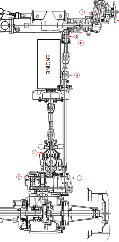

Crash and Eric, you are both correct, the radiator fan is belt driven by the engine. In my line of work I deal with electric motor driven variable speed cooling fans so I naively assumed this radiator fan had its own electric motor.
This led me to investigate the HST fan power source, which appeared to me to simply be the drive shaft, so checked my service manual and that appears to be case, so it doesn't seem to me it's possible for the HST fan to spool up either, at least not without the drive shaft increasing drastically?
...in which case...now I don't even know what this noise I'm hearing is coming from!
All filters and fluids were done at 55 hours by dealer as part of the 50 hour service. Oil change and oil filter were again done at 100 hours when took the deck off and put the blower on.
Ford, you are right, it almost seems to lose power like being in high range and going up too steep a grade. However, I am always in low when blowing snow, and I'd say her drive at it's steepest gains 1 foot elevation per 10. This past snowfall was only about 4". Blower and engine never bogged. I do have the pedal pressed down pretty far when doing her part of the drive, as its long, straight, and relatively level.
I will experiment with giving it less pedal and see if it stops making the noise...but now curious as to what's making it?
