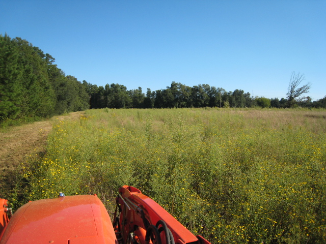

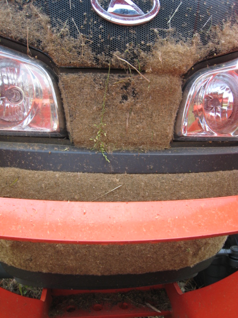

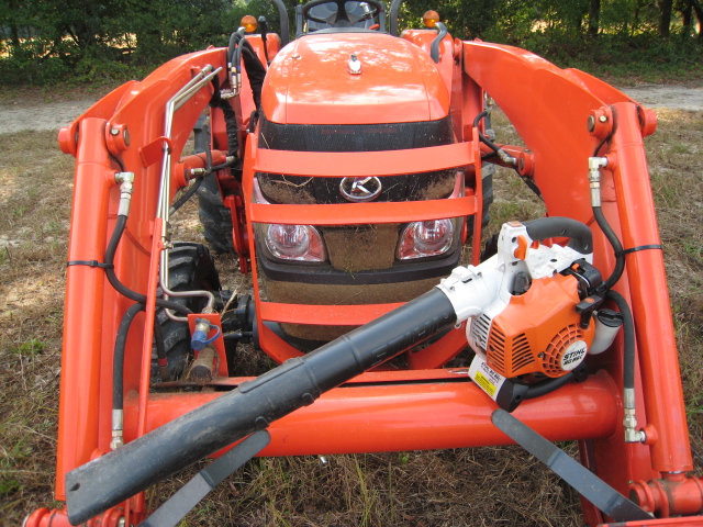

I have been bush hogging about 15 acres of fields and found a leaf blower is the quickest in the field. Pict of field, grill after 15 minutes of BH. I blow off the grill the blow off the trans cooler then the radiator. It takes about 2 minutes and beats the heck out off pulling off the side panels and screen. Normally my 5240 runs about 4 blocks on the digital guage and when it moves to 5 blocks I clean again.
