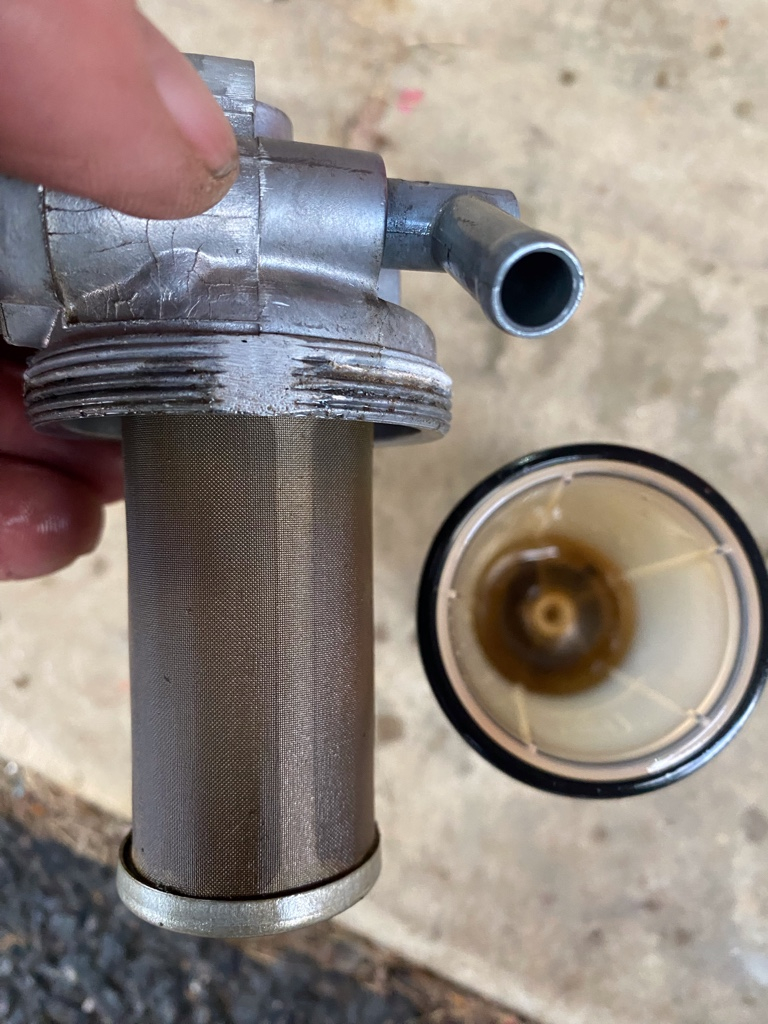

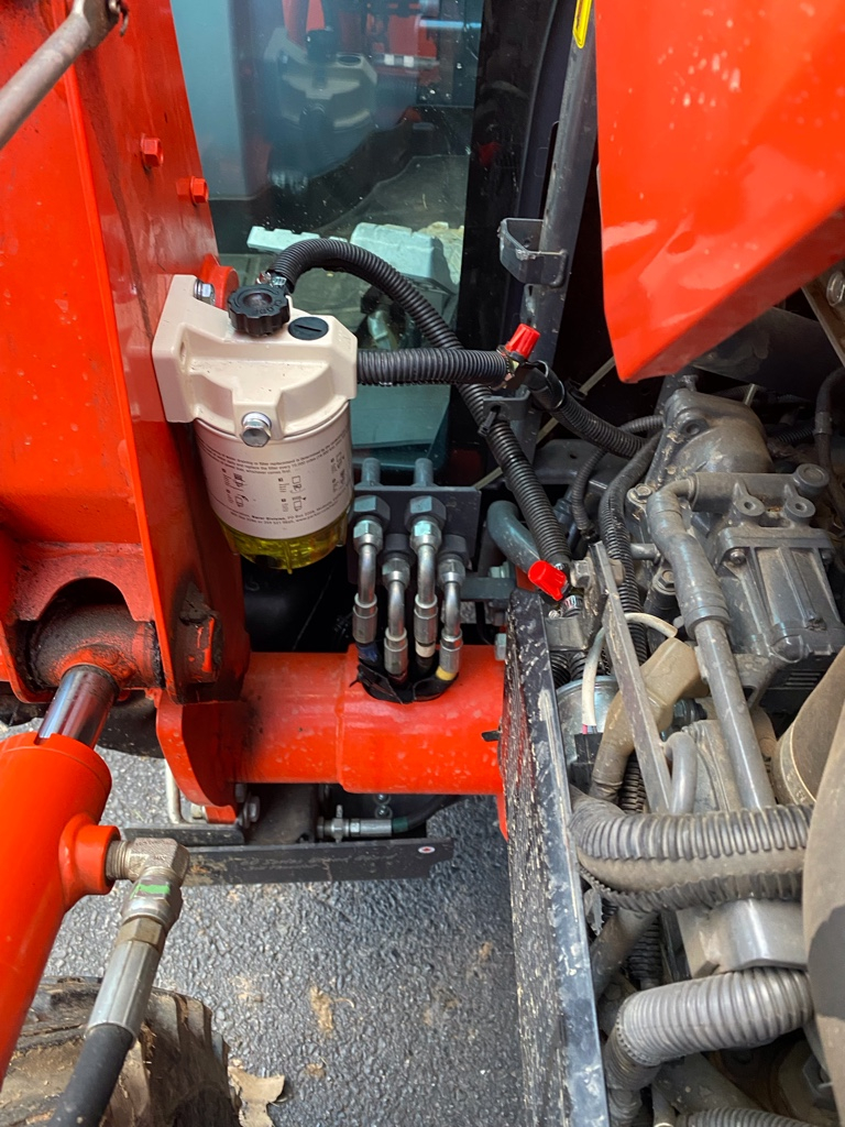

I finally got around to installing a Racor fuel filter (215r) on my tractor. It didn't take long, but I did learn a few things...
I agonized over the micron rating of the Racor (2,10, or 30) and where in the fuel system to put it. I ended up trying a 2 micron filter, and put the Racor in place of the OEM water separator / filter. Not ideal for a 2 micron filter, as it comes immediately after the tank and before the OEM spin on filter (presumably a 10-20 micron filter, but it's impossible to determine). Worst case is that I will be going through 2 micron Racor filters quickly, and will switch to a 10 micron.
I filter fuel going into my equipment with a 10 micron water blocking filter, so I start off with reasonably clean fuel. Anyway, I also used 2 inline shut off valves. In hindsight, probably not necessary as the tank is below the filter on the intake, and the filter output goes straight to a 12v lift pump.
Currently the filter is mounted to the loader frame with one bolt. It seems secure enough, though I may drill and tap another mounting hole. I never take the loader off so that's a non issue.
When priming the Racor I was unable to fill the unit with their nifty hand pump and vent. I guess it was too high a lift (was less than their max lift spec). It filled fine just bleeding the tractor with the 12v lift pump like Kubota says to do it.

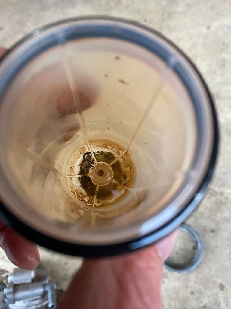

We'll see how long the 2 micron filter lasts! Based on the appearance of the OEM water separator / pre filter after 684 hours I think I will be fine.

My L4060 was bought in 2016, and does have a coarse mesh filter in the water separator as well as the spin on filter further downstream. My previous L3410 had a water separator / filter combo like you describe on your 40 series.
I don't see my L4060 OEM fuel filters being any better than the L3410, although the micron ratings are basically unknown. I suspect the stainless pre filter is around 50 microns and the final spin on filter is 10-20 microns - that's just a guess though.

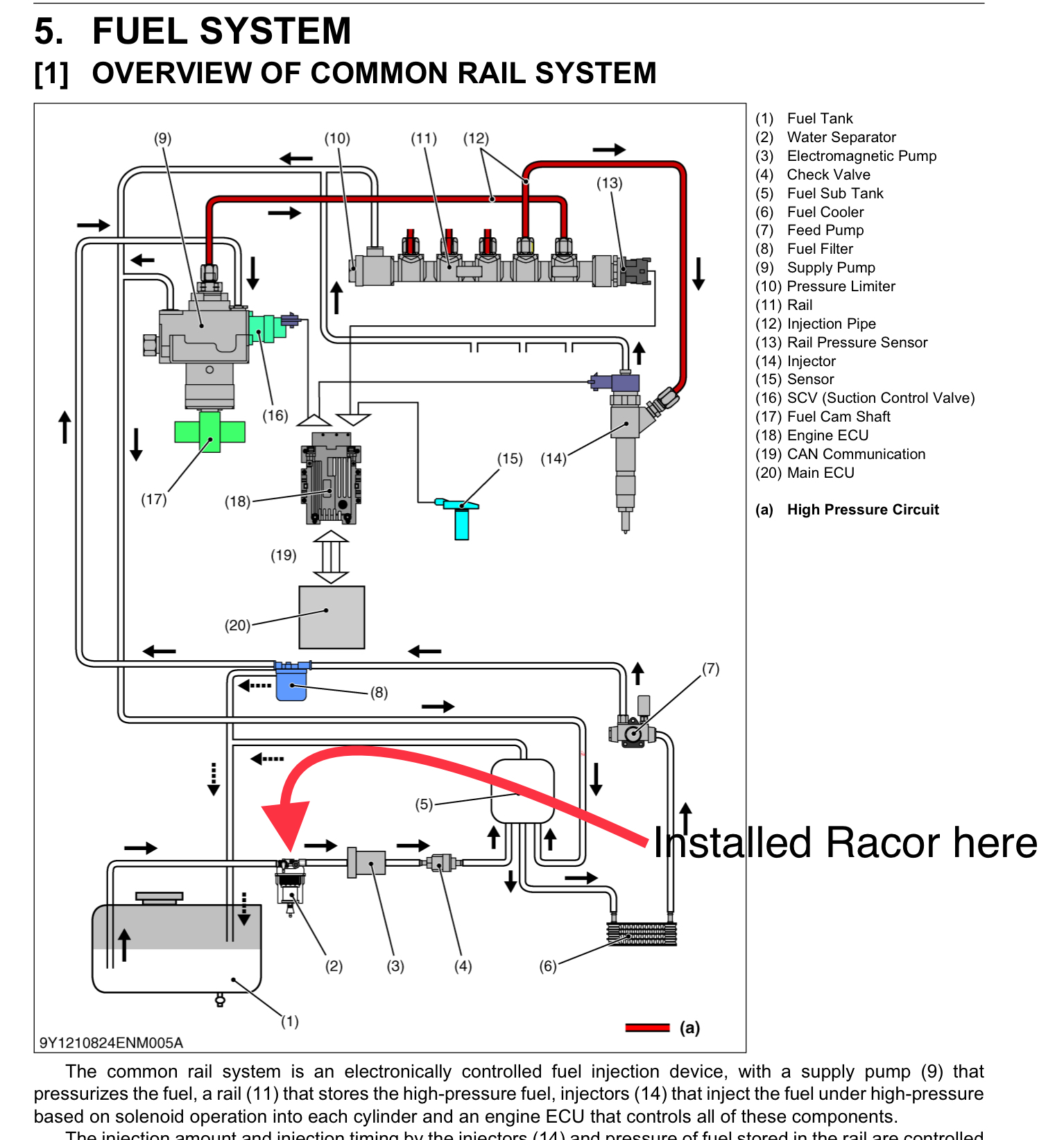

There is a 12v lift pump, and I presume a mechanical lift pump at #3 and #7 in the below diagram. Racor recommends installing their filter on the suction side, so I used the location of the OEM water separator.
So the OEM fuel system is Separator > 12v lift pump > Feed pump > Spin on filter.
   / Racor 215r Installation on L4060 #8
ok so you replaced the OEM separator with the racor unit. and kept the original spin on filter. So the racor unit couldn't fit in the stock location of the separator?
That is correct, at least on my M9's it is. Not enough room on my units.
