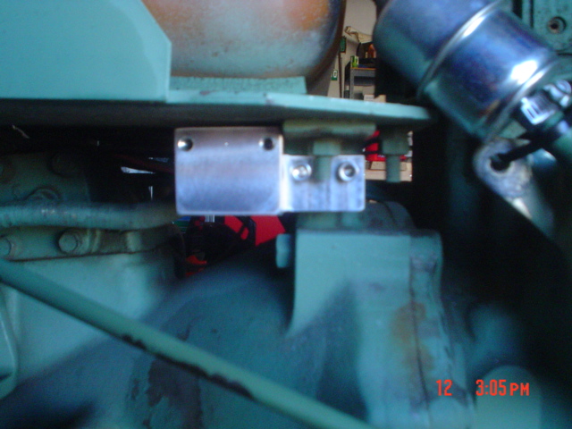

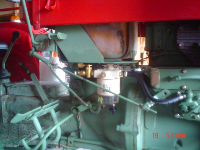

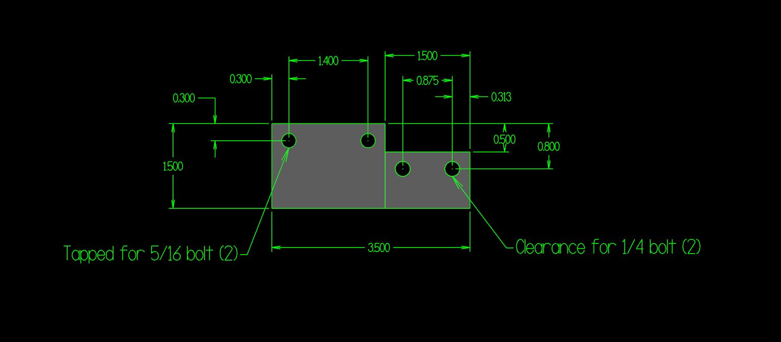

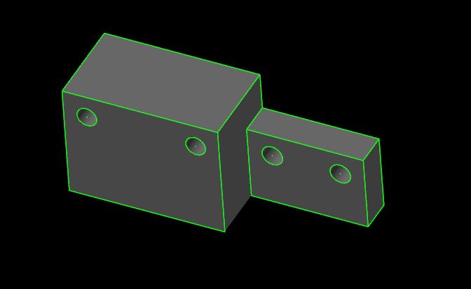

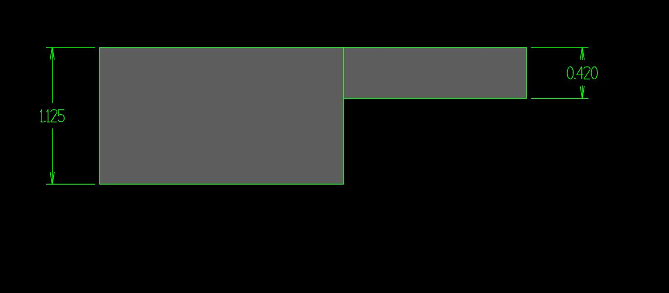

I recently purchased a YM2000 that was missing the factory fuel filter. Instead of buying a factory filter I bought a Parker Racor 120AT filter. It cost a little more but I was hoping to get an American made filter and better filtration. I am a bit skeptical if it is actually made in the USA any more since mine had no country of origin labeling on it. With the Racor I have a water drain and filtration to 10 microns. I believe the factory filter is 19 microns. I could also go to 2 microns but don't think it is necessary. There is just enough room to squeeze it in. I made a bracket that I bolted to the fuel tank support. I imagine it would also work on the YM240 American version and a few others. Second picture is the bracket I made on the tractor before bolting the filter to it. The last three are cad drawings in case someone else wants to make one. The shutoff valve was from Anderson Brass.

I too would have just bought the hoye OE unit. They worked for decades aND will work for decades more.
I bet you could get a Baldwin or some other amercantile filter if there is a cross for it. But even the wix , and whoever carquest uses now a days, purorlator, and Fram , even though made in isreal, India or china is probably better than the filters that a farmer would have used in the rice patties over in Japan, china, and Vietnam when these tractors were overseas.
Good work gabbing it up and making something you have confidence in. I just think it was a lot of time one would spend to do so just to get a water drain that should be unnecessary with as little fuel as most of us use between fuel filter changes. ..you would have to have some awfully water logged fuel to need it. The bowl catches it just fine. Also someone in the future or you might have trouble locating the replacement element instead of jus being able to look it up at Napa or carquest or wherever and just getting a replacement.

Very nice install, thanks for the post.
Just FYI, and Coda1 you may already know this, that Racor R12T filter element crosses to WIX 33583.

I'm a machinist and not a mechanic. A few hours making and installing a bracket for a better filter to me is worth the time if it might make the injector pump last longer. Based on what I have read good filtration is important. Some are filtering all the way down to 2 microns but in my research most say 10 microns is good enough. If it already had the factory filter I would have called it good enough but I didn't want to buy a oversees filter if I could avoid it. Buying a Japanese tractor was hard enough for me but there isn't an American tractor in this size range.
