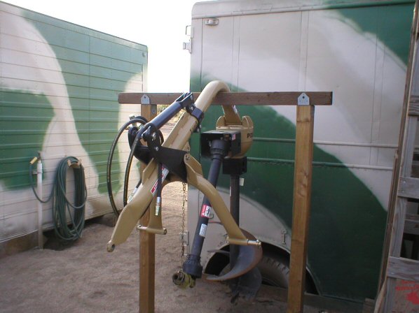

As far as a down pressure unit for a PHD, they work great. Actually hard to believe how well they do work. The down pressure kit is far from just a hydraulic pushing down on the auger. Here is Land Prides unit.

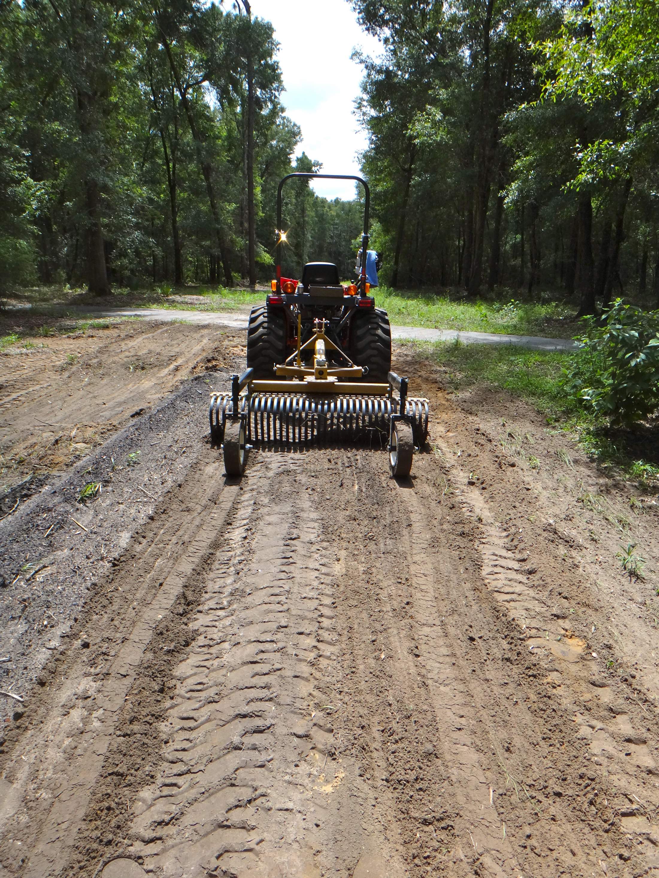

I use my ETA Landscape Rake quite a lot for trail grooming and soil prep prior to sodding. The rake excels at removing trail/road crown to fill in low spots/ruts in sandy-loam soil. Good quality tool. I use the rake gauge wheels 80% of the time.
I also have a Box Blade. It requires more hours to learn Box Blade technique than rake technique.
I use them approximately the same number of hours.
I use a HYDRAULINK in lieu of Kubota Top Link with both Landscape Rake and Box Blade. Hydraulink is particularly helpful with the Box Blade.
