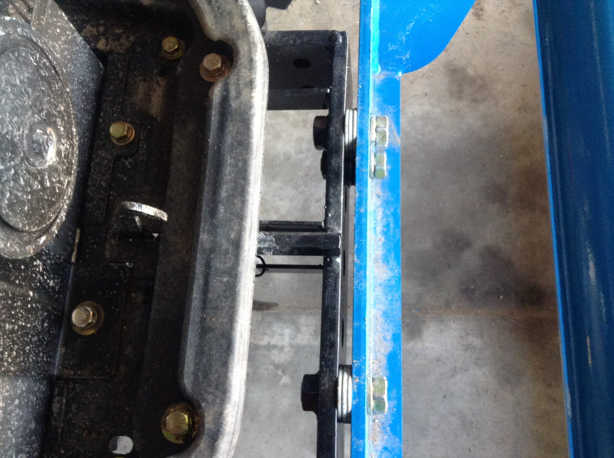

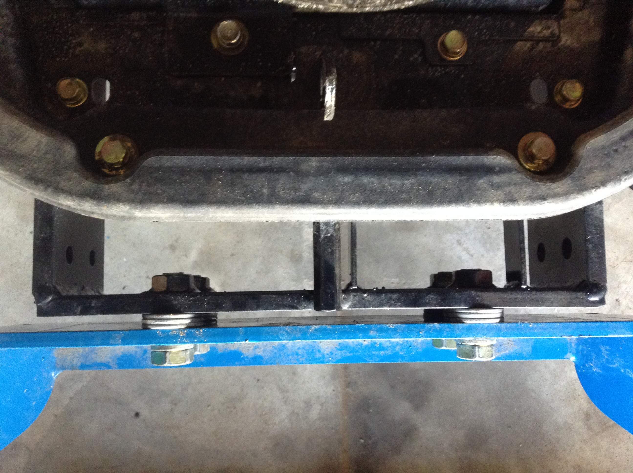

If you want to open your Hood without tilting the Brushguard forward, loosen the 4 bolts ( don't remove ) that hold it on, ( the nuts are welded to the frame ) Then take 1 out at a time & insert 3 nice thick washers between the guard and frame and tighten. The existing bolts are plenty long enough for 3 washers. I can now open Hood w/o tilting guard. I don't know why they didn't engineer it this way, there is all kinds of room there. The loader doesn't even come close to the guard? :confused3:

They must have thought of that when designing the XR series brush guard. Mine has plenty of room to open the hood and lots of clearance for the loader. Cheap and easy mod done to yours.

I think LS fixed this on the R series somewhere along the way. My 2013 R4047H's hood will clear the grill guard without swinging it forward and has no spacers in it.
