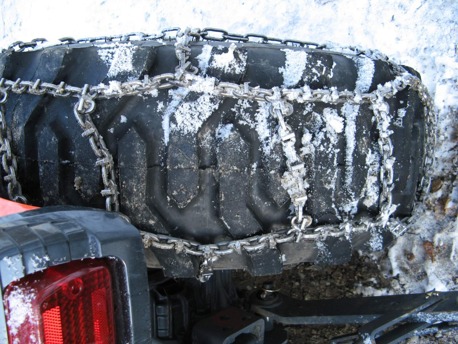

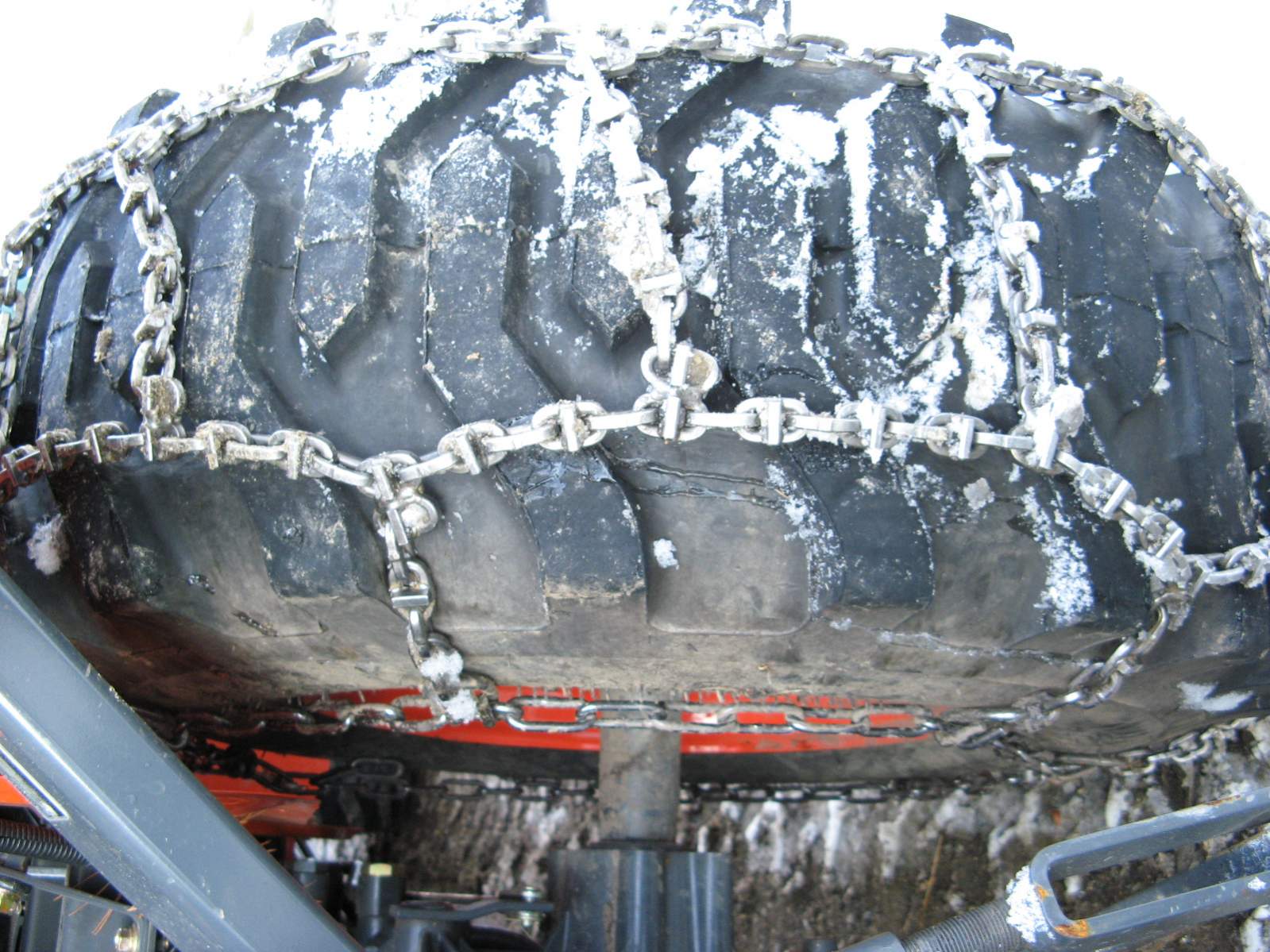

Here are pictures of the chains I have - clearance is pretty good due to the smaller links and side chains. To bad they cost so much in the bigger sizes, wheel spacers might be cheaper but these are real nice chains.

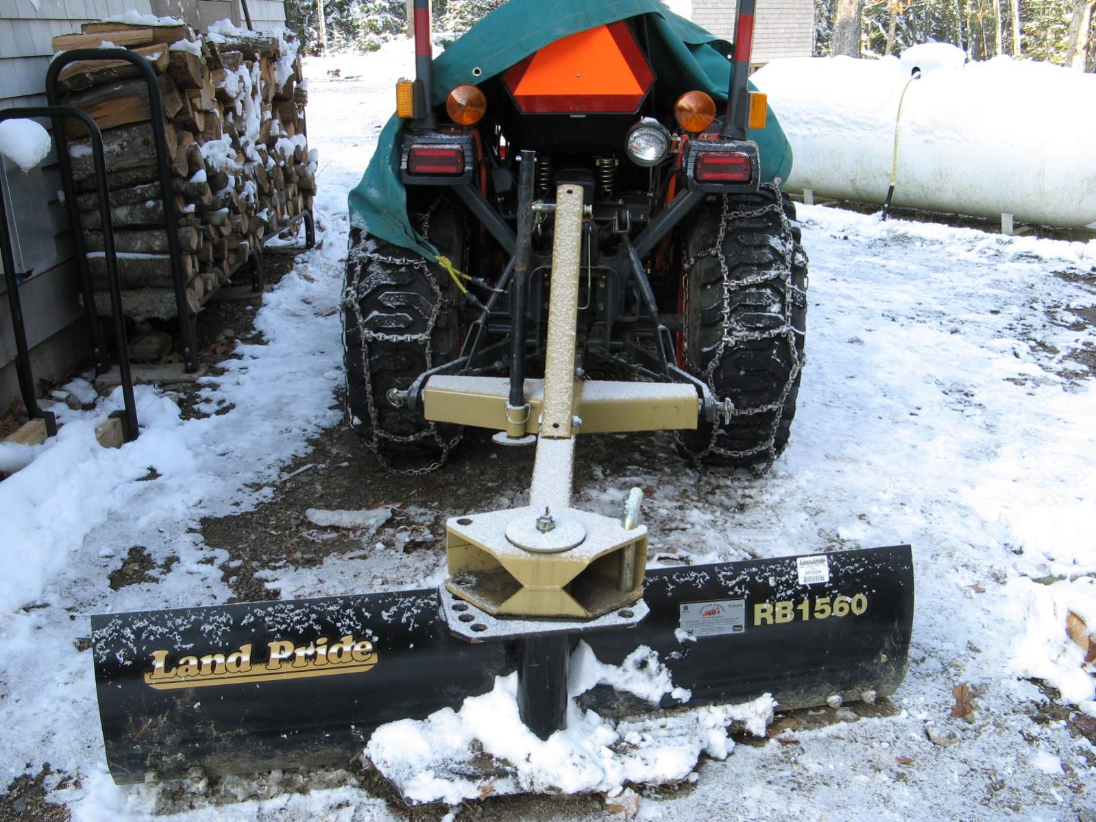

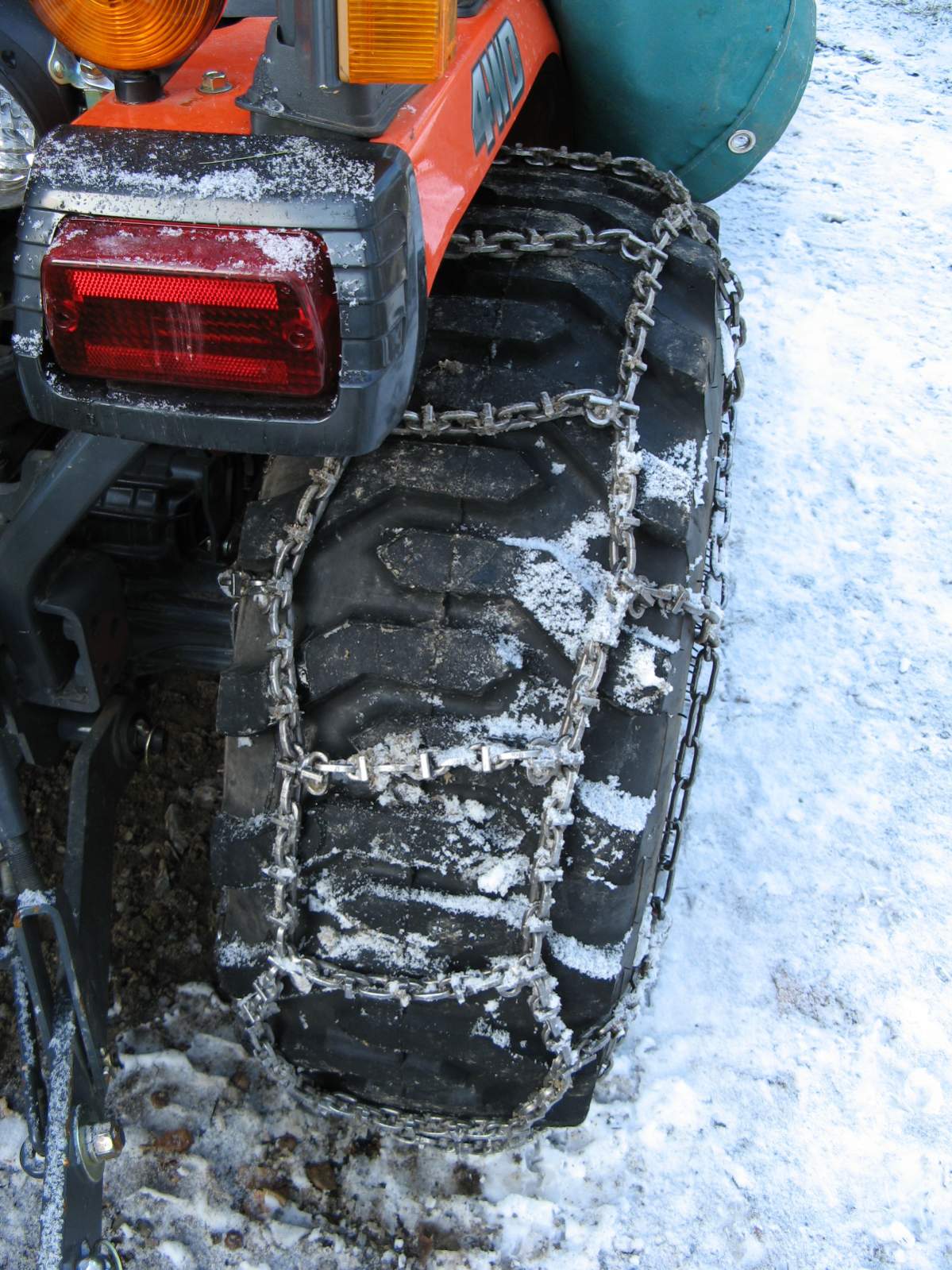

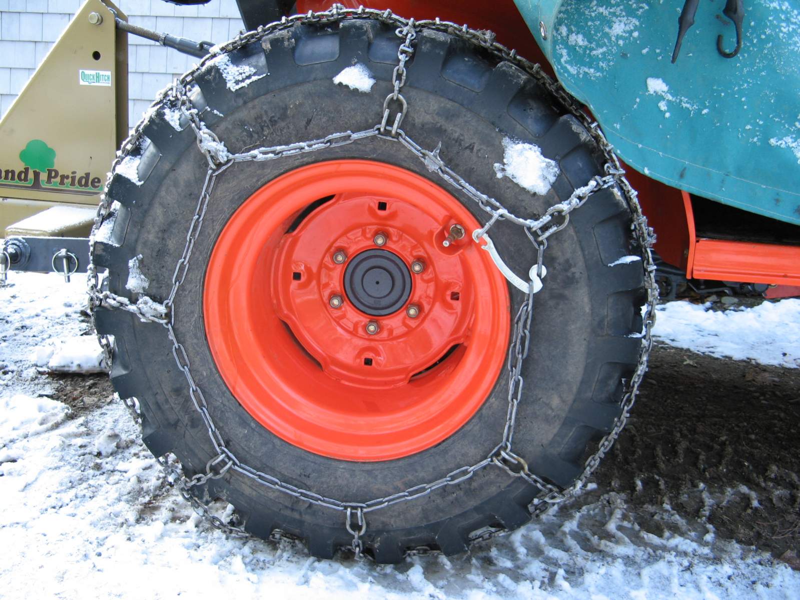

Found a few more pics.
