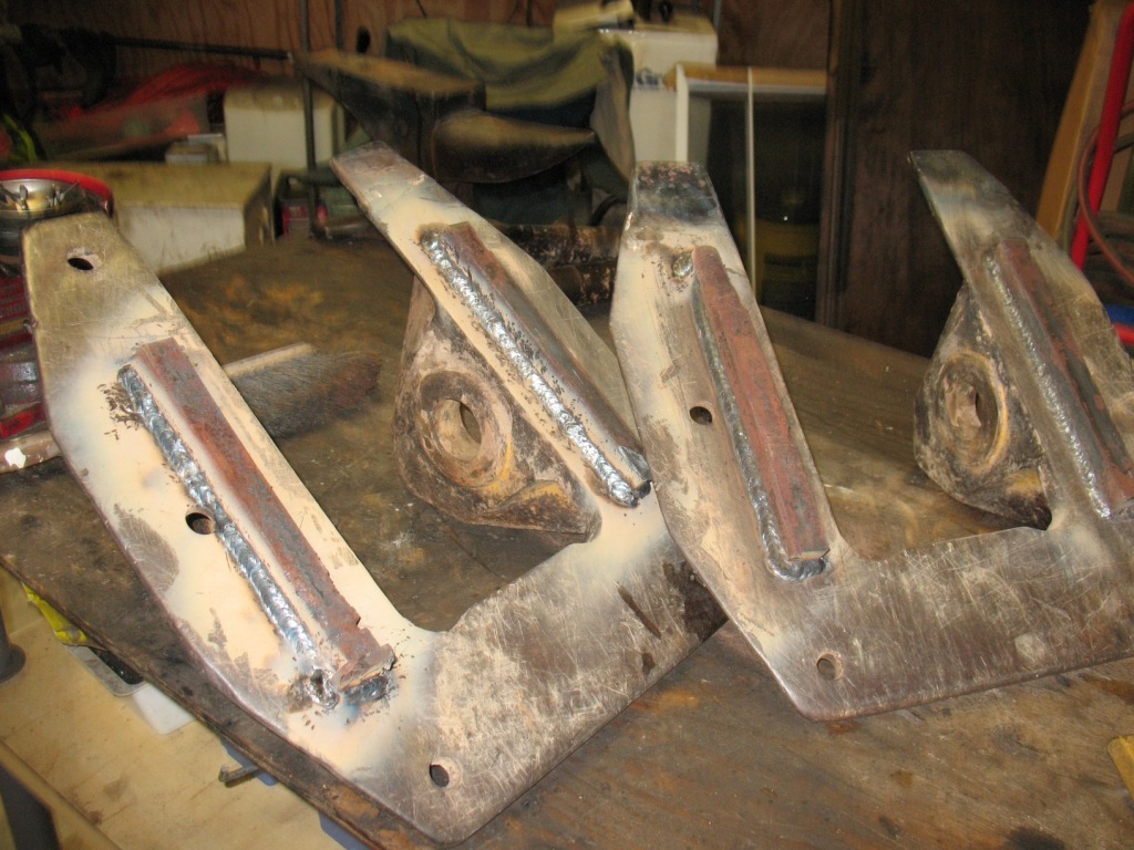

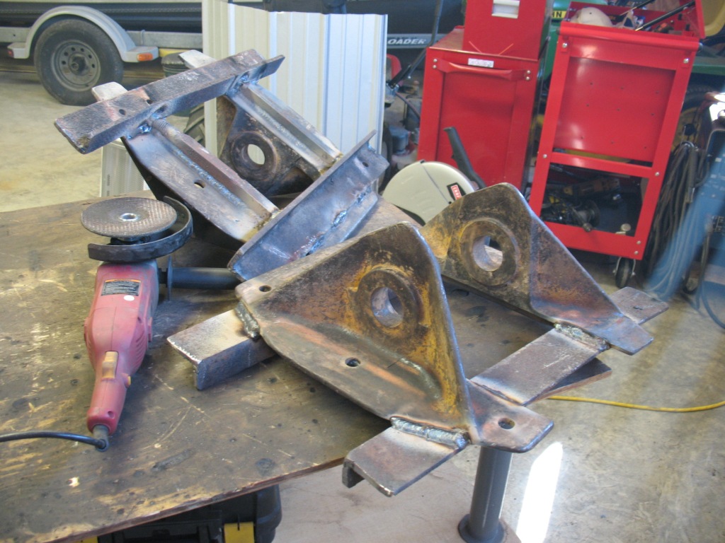

I finally finished (I think) fixing up the stabilizer pads off a JD 310 backhoe for my building contractor (Ricky) It started out with just a patch job on some broken tips (3) on the pad which would have been about an hours work counting preheat and bevelling of the pieces. Then we talked about putting some cleats on to prevent sliding so I welded on some 1" bar stock from an old disk axle. This took me about 6 hours yesterday. This morning, he bring me two long pieces of old rusty angle and wanted them welded crosswise to help with floatation in soft soil. So, I put the pads back on my table and put a heater on them for about hours with a piece of roofing tin over the top to direct all the heat on them. It worked pretty good and got the all warm to the touch. The welds tend to underbead crack if not preheated. It took me another 5 1/2 hours of welding, not counting the preheat prep time to get all the old rusty iron ground down a bit and cut to length. I ended up burning about 30 pounds of 1/8" 7018 rods on this little quickie repair. You can see the tips repaired that dont have a hole in them as shown in work done yesterday, then final I hope version finished today.
