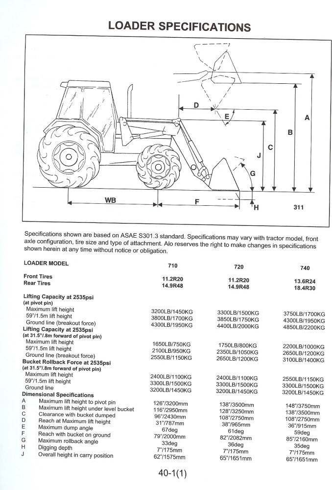

Jan 25, 2008 / Quicke Q720 Loader #1 IH3444 Veteran Member Joined Jan 10, 2004 Messages 2,077 Does anyone know the loader specs for the Quicke Loader series of 700. I haven't been able to find any specs yet. Q 720, Q730??? Thanks!

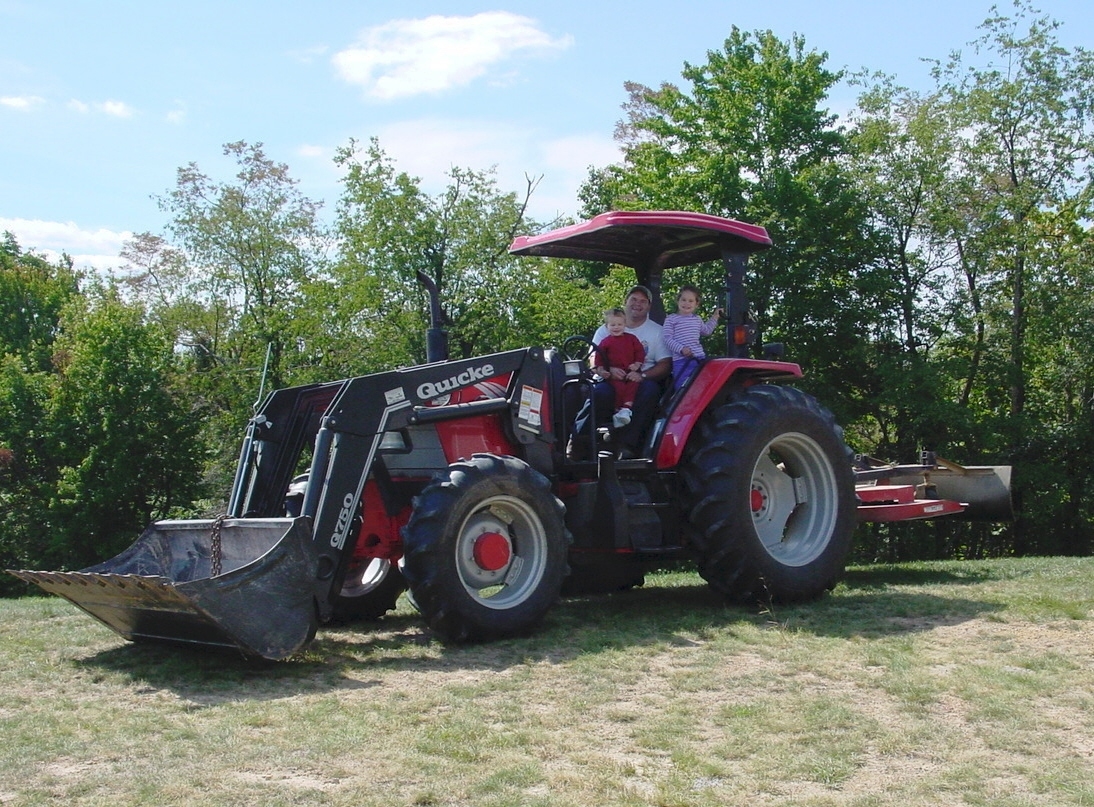

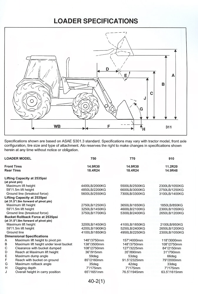

Jan 26, 2008 / Quicke Q720 Loader #2 M mccormickDave New member Joined Apr 19, 2004 Messages 16 Location Southwestern, PA Tractor McCormick CX 75 XtraShift I will try to scan and post the specs for the 700 series from my owners manual. I have the Q750 on my McCormick CX75 and am very pleased with it. You can also try the quicke website: Quicke Dimension front loaders I am not sure how much the specs changed from the 700 and 900 Q series to the new QD series. Hope these attachments work. Attachments 720.jpg 239.5 KB · Views: 3,213 750.jpg 248.4 KB · Views: 2,280 CX75.JPG 806.2 KB · Views: 1,988
