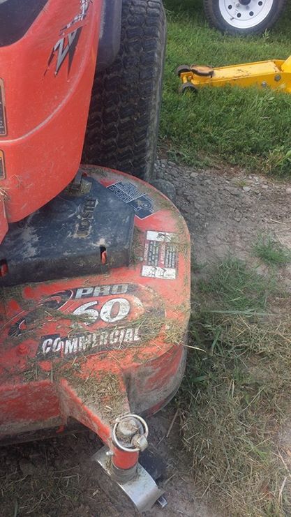

Last week we purchased a ZD326 to replace an older Cub Cadet ZTR and my only real complaint with it was that the rear tires were almost as wide as the deck which made it hard to trim around trees but I found that by turning the left rear tire around so it was dished in instead of out I could move the tire in about 2" and that made it much easier to trim with. I have mowed several road ditches with it so far and haven't noticed any difference in stability on slopes.

I might just try that on my zd221.
