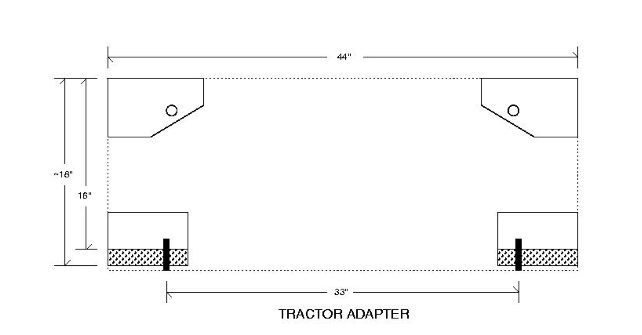

I am going to add Quick Tach set up to my Kioti CK20, so I can quickly switch between the bucket and forks.
I want this lite as possible as not to loose lifting capacity.
I don't need or want the heavy commercial units that are rated for 3500#, my loader is 1050# capacity.
I found 3/16 and 1/4" weld on plates that are 50#
Questions on the FEL side of things, what is the standard pin to pin center dimension for the tractor adapter?
Is the standard for the pins to line up with the lager out board slots or the smaller in board slots ?
I have seen the dimension 33" pip - pin throw out there,, if that is so, that is going to line up with my loader arms (32" C-C),
That is going to make the adapters a pain to fabricate,, using the smaller in board holes would slide the pins in, out of the way of welding on the "pin on" brackets ?

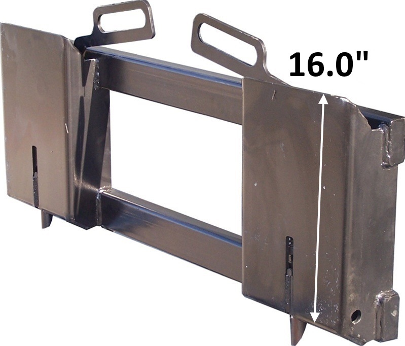

33" is standard:
