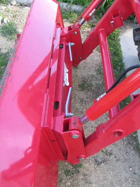

this is probably the best I can do for a picture without taking a new one. You can see that it is 1 solid unit and does not have an open area like Slippy's.

Yours is different from mine. My understanding was that your type was compatible with all skid steer type attachments.
   / quick tach plates on 00 series and incompatible attachments
I think it should be but maybe the guys at king kutter skimped on the metal a bit and made something that would work for 80% of the people out there.

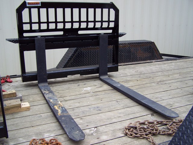

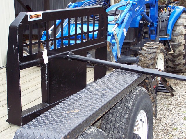

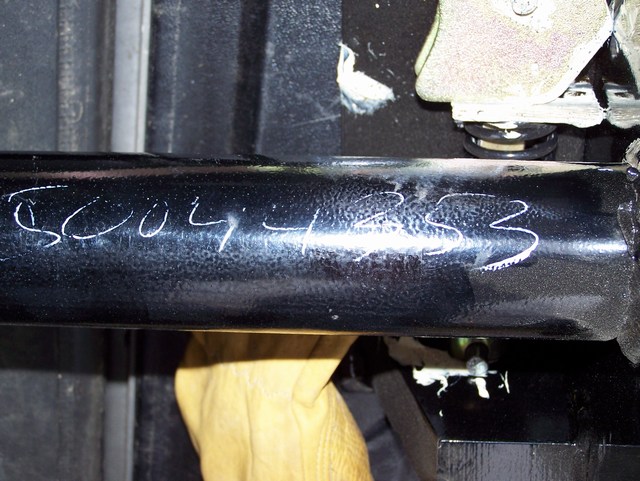

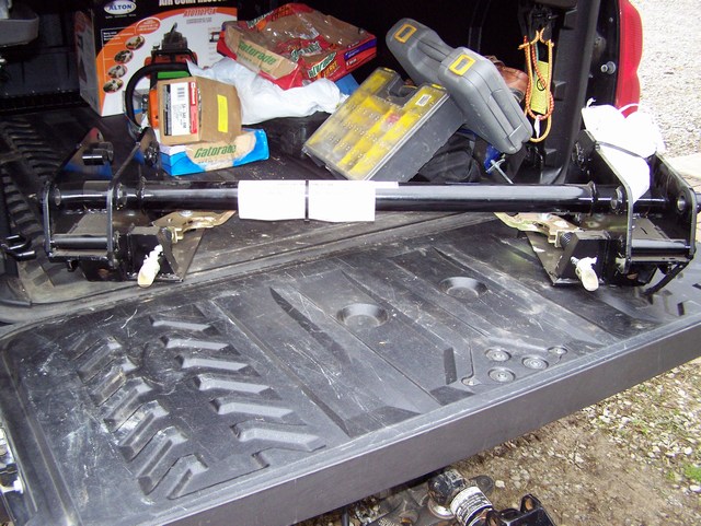

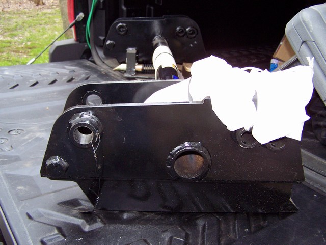

Here are pictures of mine before it was installed. You can see the cross member on mine is round. One of the pictures actually has the part number on it. But again, mine is for a Great Bend loader. I also put in pictures of forks and bail spear.
