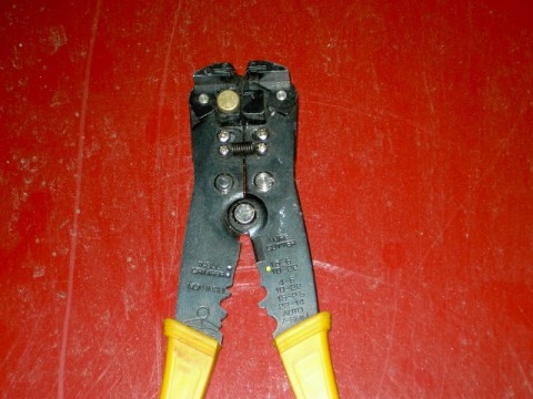

I have a tool that is similar but, metal. It works pretty well. I don't see a brand on it however. See attatched.

Mike; I've got the same strippers you showed. They are nice, Klien makes quality tools. Don't use them hardly at all though. They take up a lot of room in a pouch, so I went back to the old standby Burndy's. Burndy also makes a nice sheathing ripper/scorer foe 12 and 14 gauge Romex. I use that a lot, it's quite a bit safer than a utility blade. I sometimes like my hands and fingers without stitches if you catch my drift. /forums/images/graemlins/cool.gif /forums/images/graemlins/blush.gif

I agree with Al and pineridge.
A bunch of companies make variations on that same tool. But this is the ticket.
I have two; one for common small wire sizes and one for common larger wire sizes. Each one has several grooves for different wire sizes. They make a wide range as was already pointed out. You need excatly the right size for each wire so that you do not nick the wire. It should only cut the insulation.
Small nicks in the conductor concentrate stress and may ultimately lead to the wire breaking. This is more critical with solid wire than stranded wire.
For some applications maybe you do not care if the wire breaks after many years, but with the right tool it may be possible to make the wire / connection last much longer.
