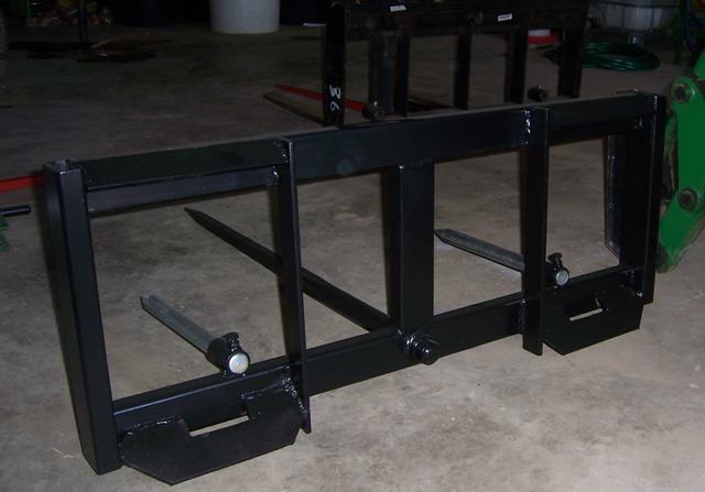

I make my own for the SSQA ... I think this is what your thinking for the implement side?
/ Quick-release FEL implements? #11
Blueriver: Nice! You have simplified and perfected the SS quick attach.
/ Quick-release FEL implements? #12
Thank you ... I'll take some pictures of another SSQA I did this week and post them.
/ Quick-release FEL implements? #13

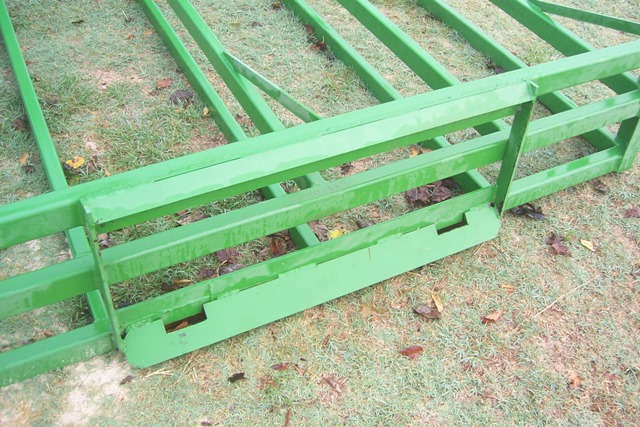

Here's another version on a hay spike... that I threw together one day last week.
/ Quick-release FEL implements? #14
Interesting. You broke the QH into two parts, left and right. That looks great and is a good example of why I recommend people start out with the SS system. To me, the SS QH looks way easier than the JD system I have been copying everytime, with curled metal top receivers and very accurate pins at the bottom. It might not matter for one, but about the time you have to produce it for the 4th or 5th implement you start to wonder.
