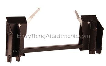

Looking for ideas to add a quick release/attach for the loader/bucket for the NH 10LA. I hade heard the kubota quick attach for the BX series works but it does not fit at all
   / quick release/attach for the loader/bucket for the NH 10LA #2
Will this one work? W.R. Long Pin on Tractor Loader Bucket to Universal Quick Attach Converter, Adapter | Free Ground Shipping for 1,000 miles!!
   / quick release/attach for the loader/bucket for the NH 10LA #3
I don't see that listed on the NH parts diagram for that loader. Looks like your loader uses a single cylinder to tilt the bucket. That makes most generic aftermarket adapters like the one above not functional for you. The other issue I have read about is that the tolerances on some aftermarket adapters require modification to make implements fit correctly. You can search for threads using the search function at the top of the page to get an idea of what I am talking about.
You might try a NH dealer and see if they made a quick attach adapter for the 10LA. I doubt they did because of the added weight and it puts the load further out from the pins decreasing lift capacity. I lucked out. I was able to go with the NH part for my 16LA. The dealer had someone order one and they never picked it up. I got it at cost as it was sitting on the shelf gathering dust.
