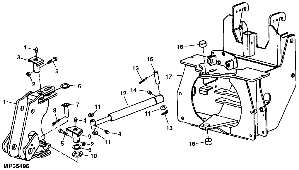

i was taking off my lower hydraulic arm today to have the seals redone(small leak) i was able to get off the hydraulic lines and the front pin out. i took out the two cotter pins(upper and lower) where the arm mounts to the backhoe frame but i can't figure out how to get the rear pin out, any ideas, i've hit it with a small sledge and its like its locked in some how, whats the trick. thanks in advance, i've done 80% of it, i'd hate to take it to the dealer now.

Are your talking about the swing cylinder? Unclear as to what "lower hydraulic arm" you are referring to?
   / quick question, please help
The arm that moves the boom side to side, sorry for not being more clear
   / quick question, please help #4
OK, That is the "swing cylinder"
Looking at the detailed drawing, it does not appear anything else should be holding it in.

by looking at that diagram i may need to pry off that lower washer, the pins came out easy and it spins with just finger pressure, any helpful hints, thanks for the diagram it helps
got it off today, a lil tricky, just needed a bigger sledge hammer, it was gummed up with dirt, debris. thanks again for all the help, i dropped it off to get repacked today, should be back to work within a week

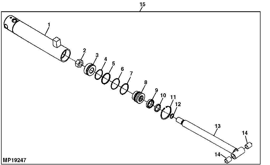

Great news! Since you went through all that work-you should have taken on the easy job of rebuilding the cylinder also...

do u mind to explain the how to for me, im sure ill need the info in the future
   / quick question, please help #9
Look at the pictureI posted above, there is just a retaining ring that keeps everything together. You can get the seal "kit" from JD.
