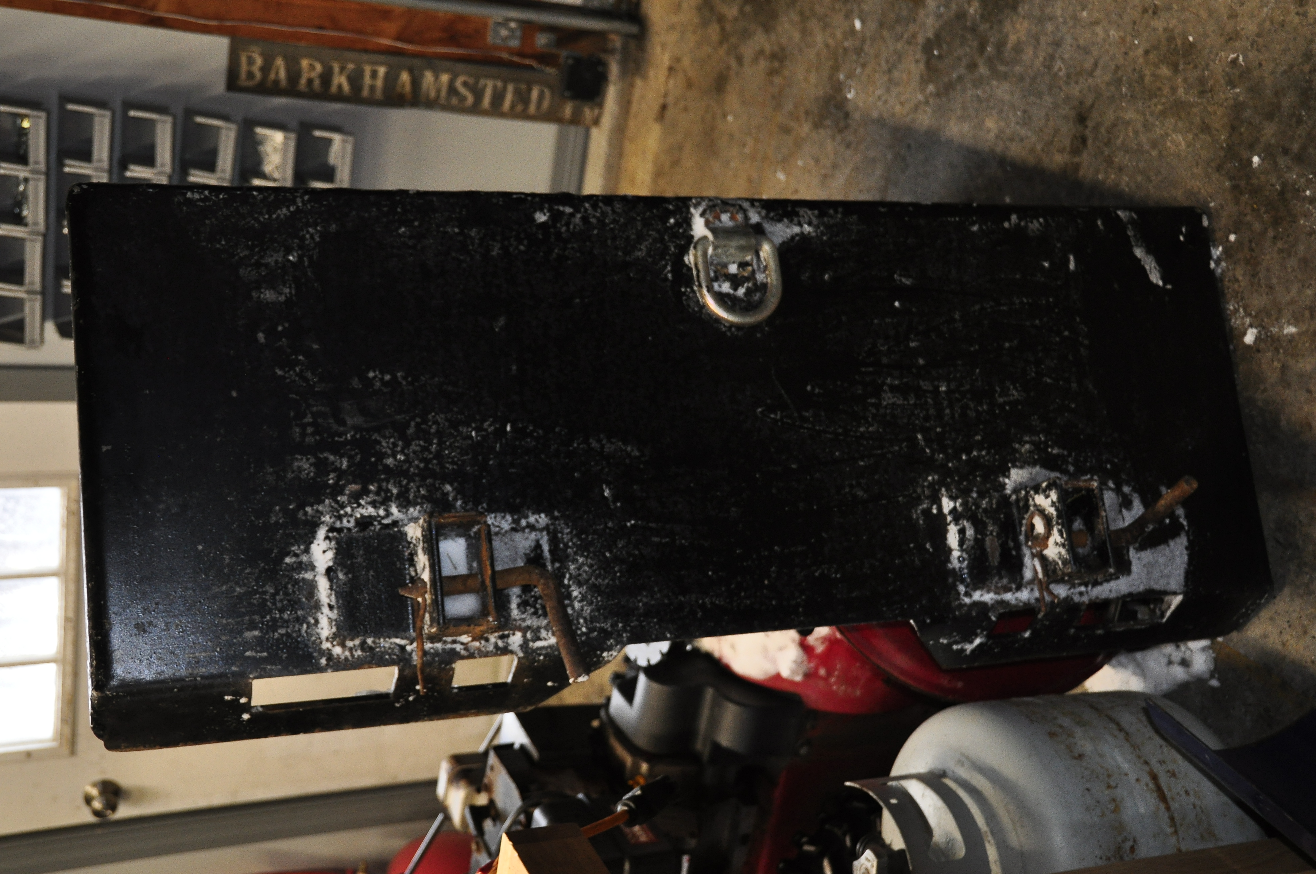

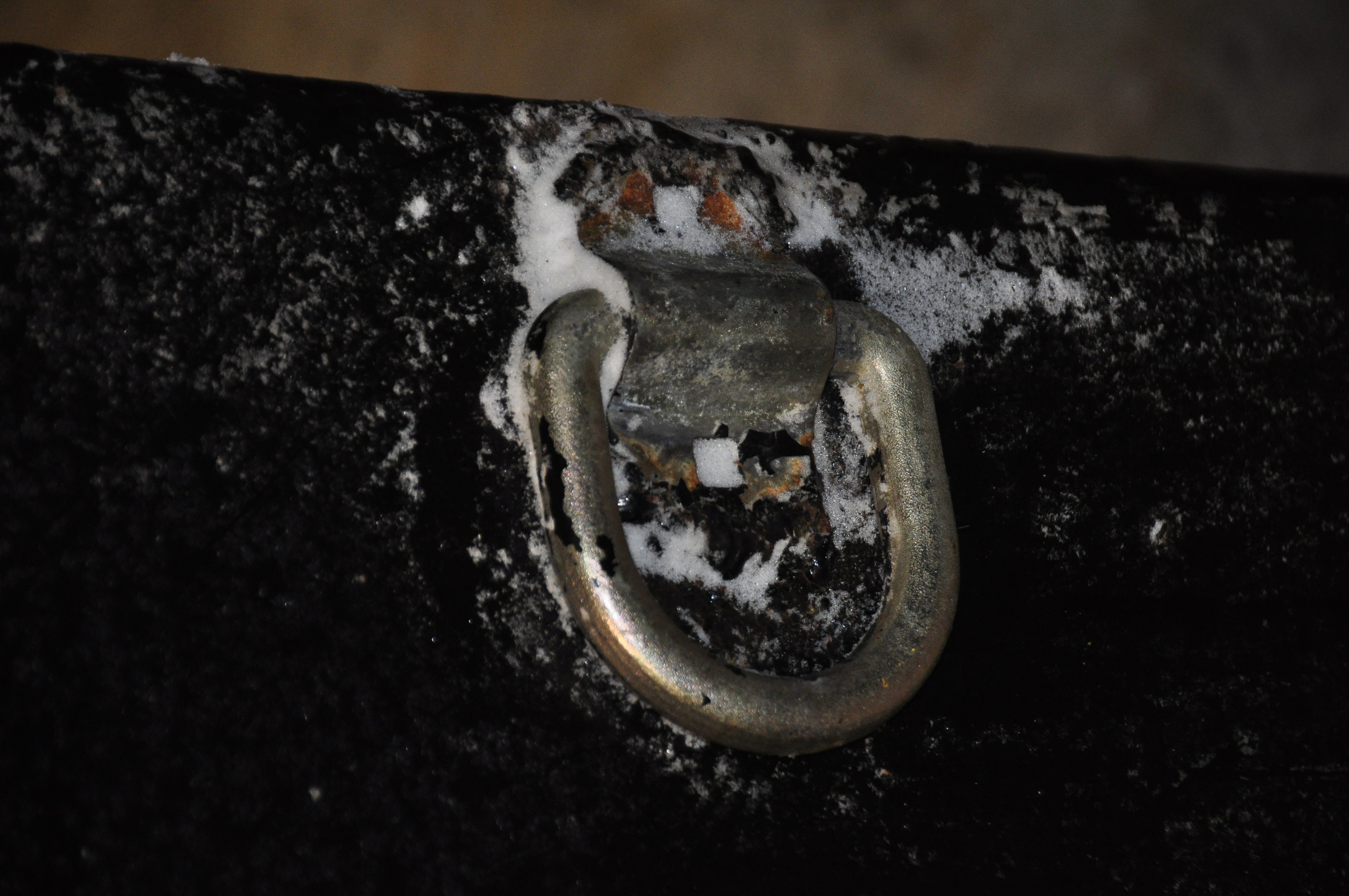

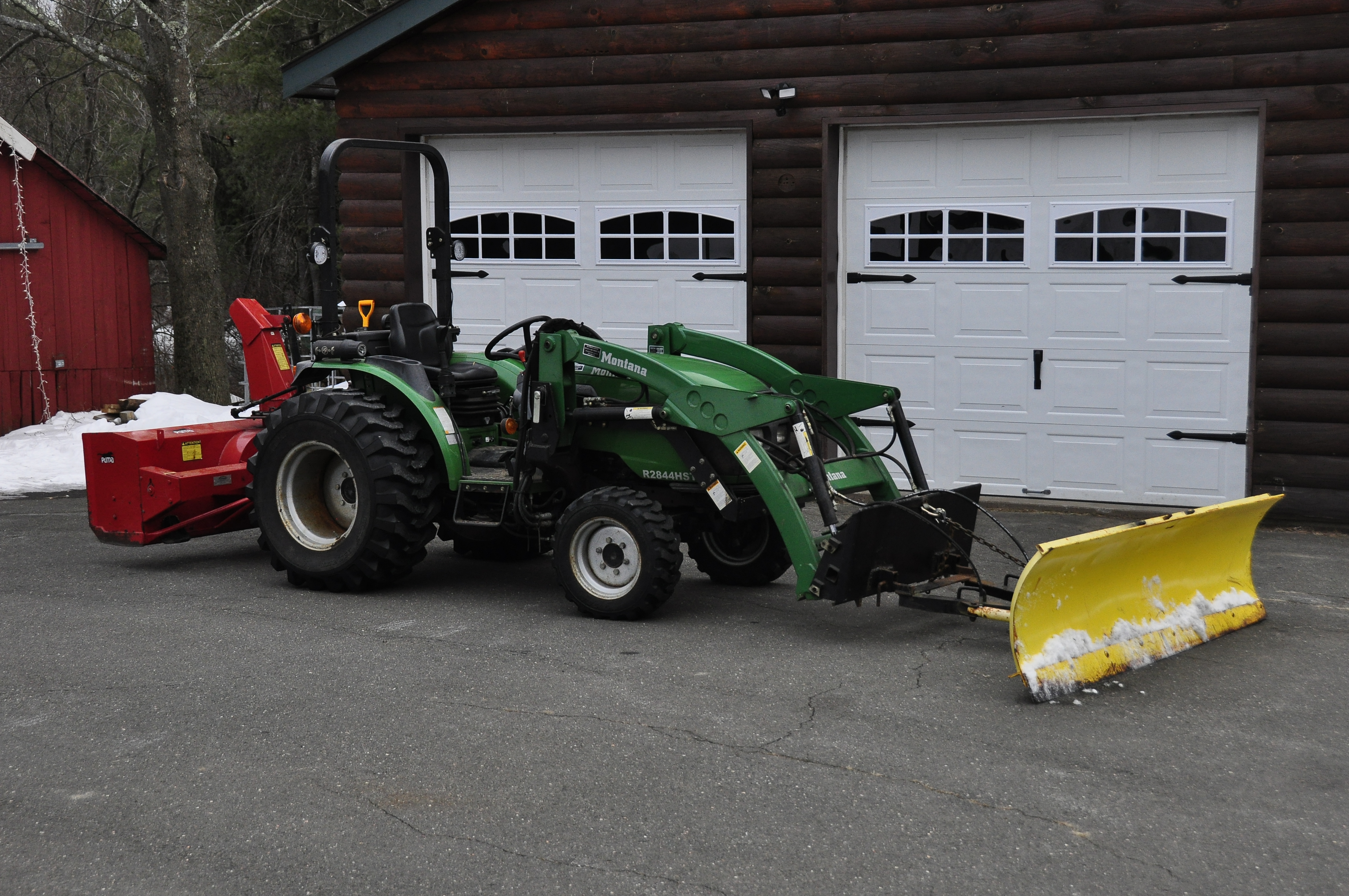

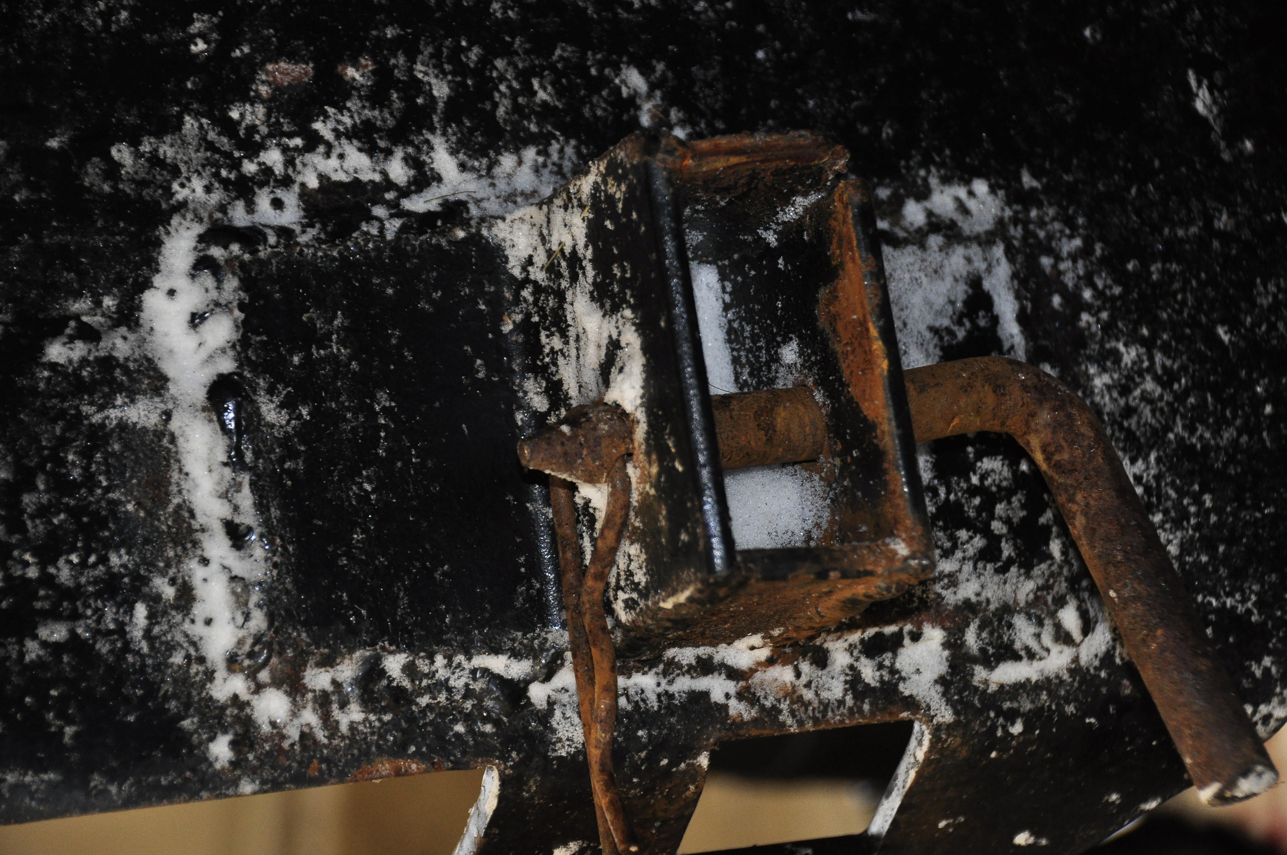

If you have a SSQA (Skid Steer Quick Attach) on your loader, you can make a quick attach plow using a truck plow and blank SSQA plate. I picked up a Meyer 7.5' plow and mounted it to a blank plate. Cost was $250 for the plow and $100 for the plate. Welded two boxes on the bottom of the plate with holes and a pin that mount the plow's A frame to the plate. The D ring at the top hold the chain which goes to the top of the A frame and allows the plow to float while plowing. I can raise or lower the plow very quickly by tilting the FEL back and forward, or of course raising or lowering the FEL arms.
To unhook the plow, I have to undo the 2 quick attaches on the hydraulic hoses which control the plow's left and right angling, and then raise the 2 handles on the FEL quick attach mechanism. I lower the FEL and the plow comes off. Drive over to the bucket, hook the FEL on the bucket's quick attach bars, lower the handles on the FEL and done. Takes 2 minutes total.
Nice set up you have there, no tire chains? I do not have the SSQA on mine, it was an option when I got it but I had no intention then of changing out the bucket. I will be adding a new cutting edge this spring due to wear from scrapping the driveway.

My tractor as setup for snow weighs around 5000lbs and my driveway is flat, so I have never needed chains. I didn't really know what SSQA was when I bought my tractor, but boy am I glad I have it! I have a bucket, plow and forks that I rotate out, and hopefully I will be getting a grapple sometime in the near future.
