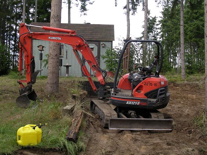

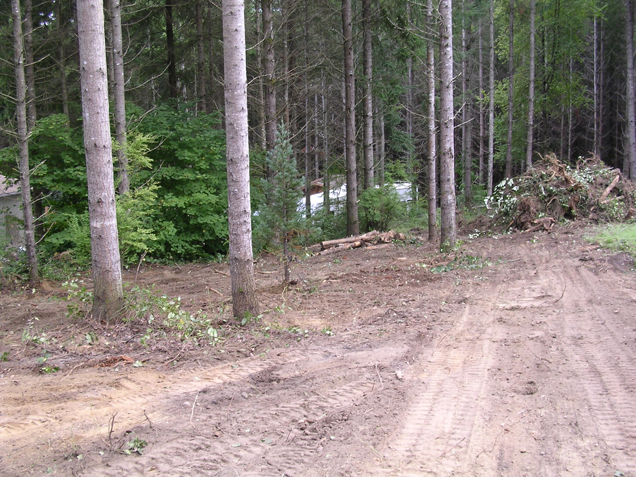

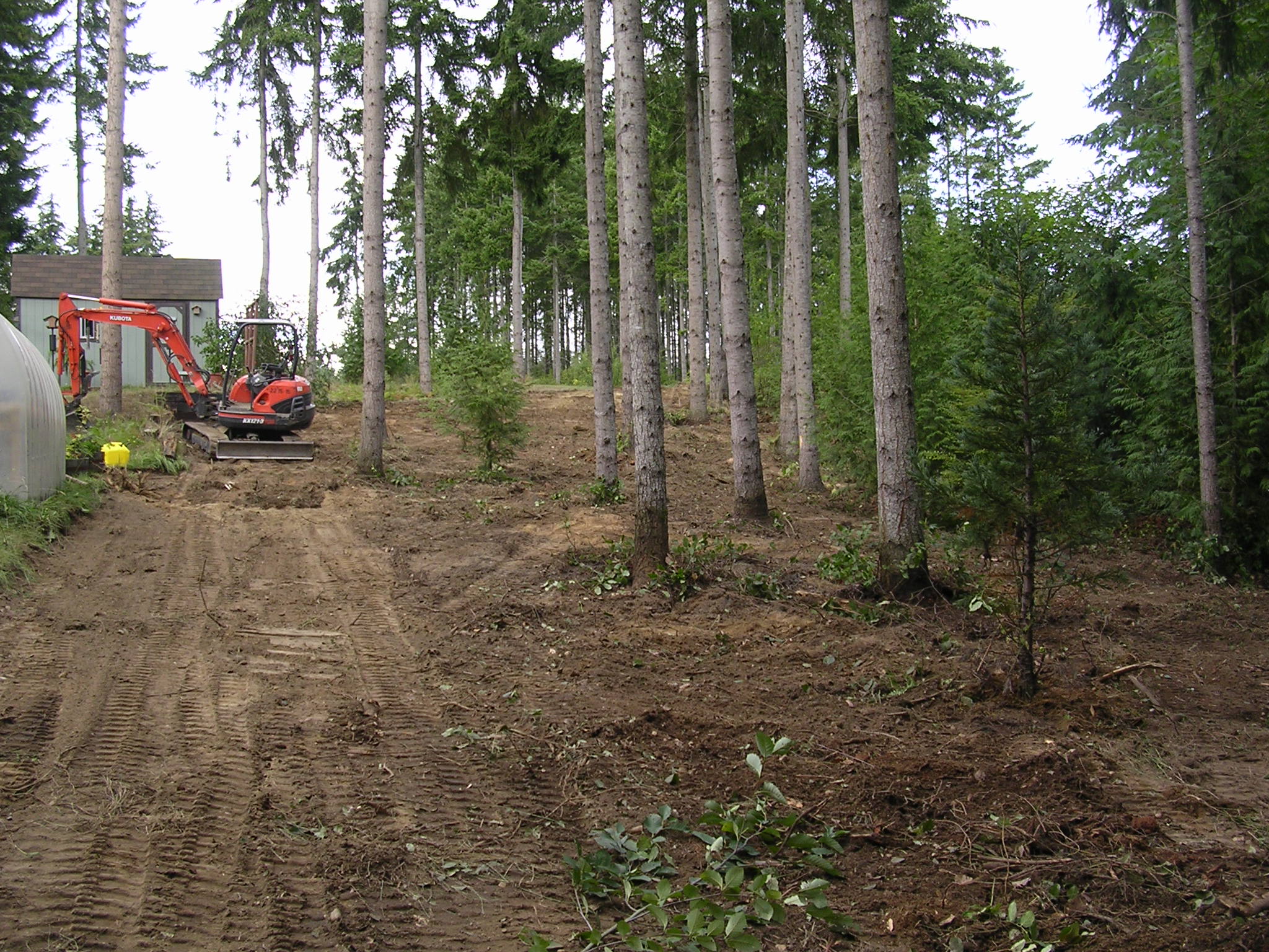

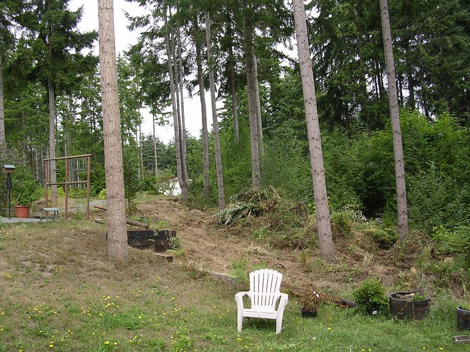

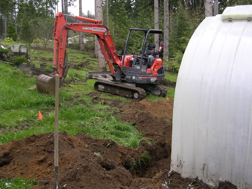

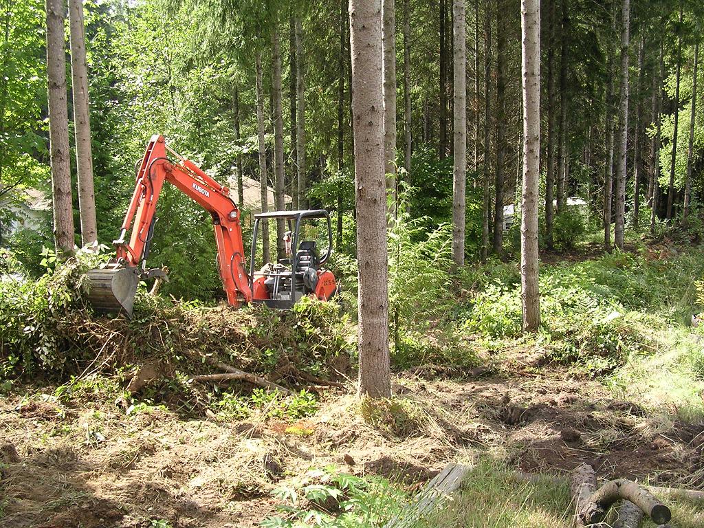

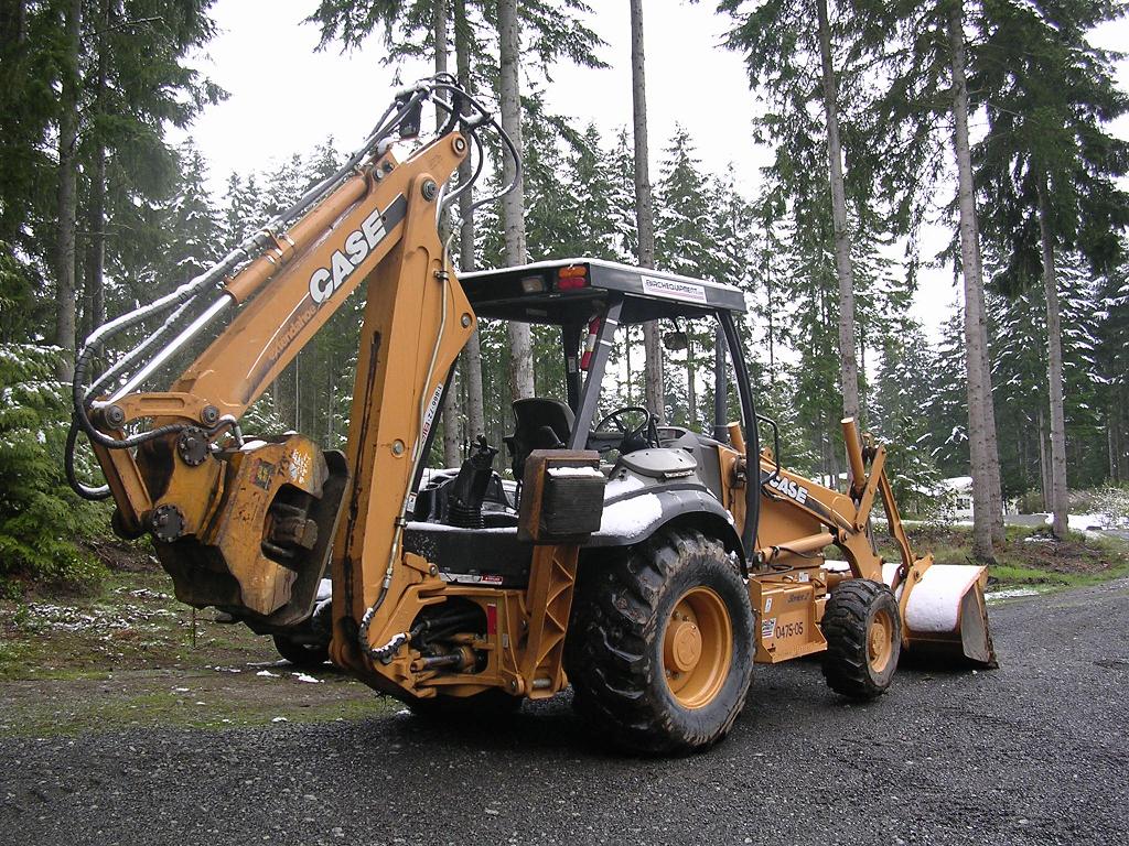

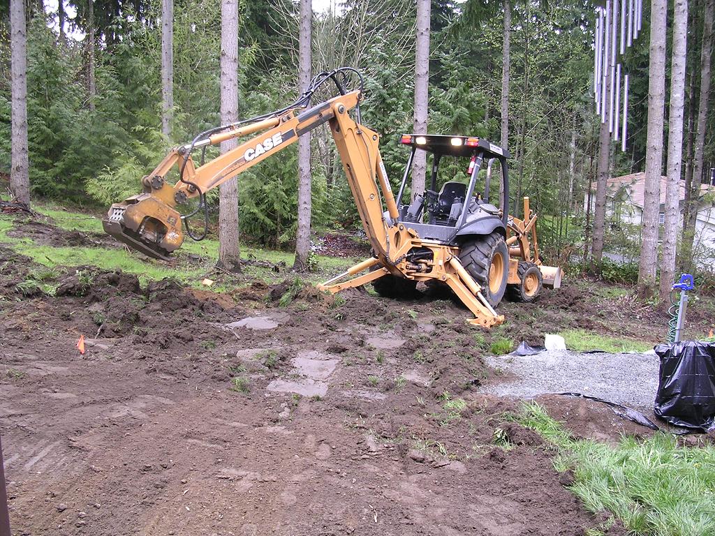

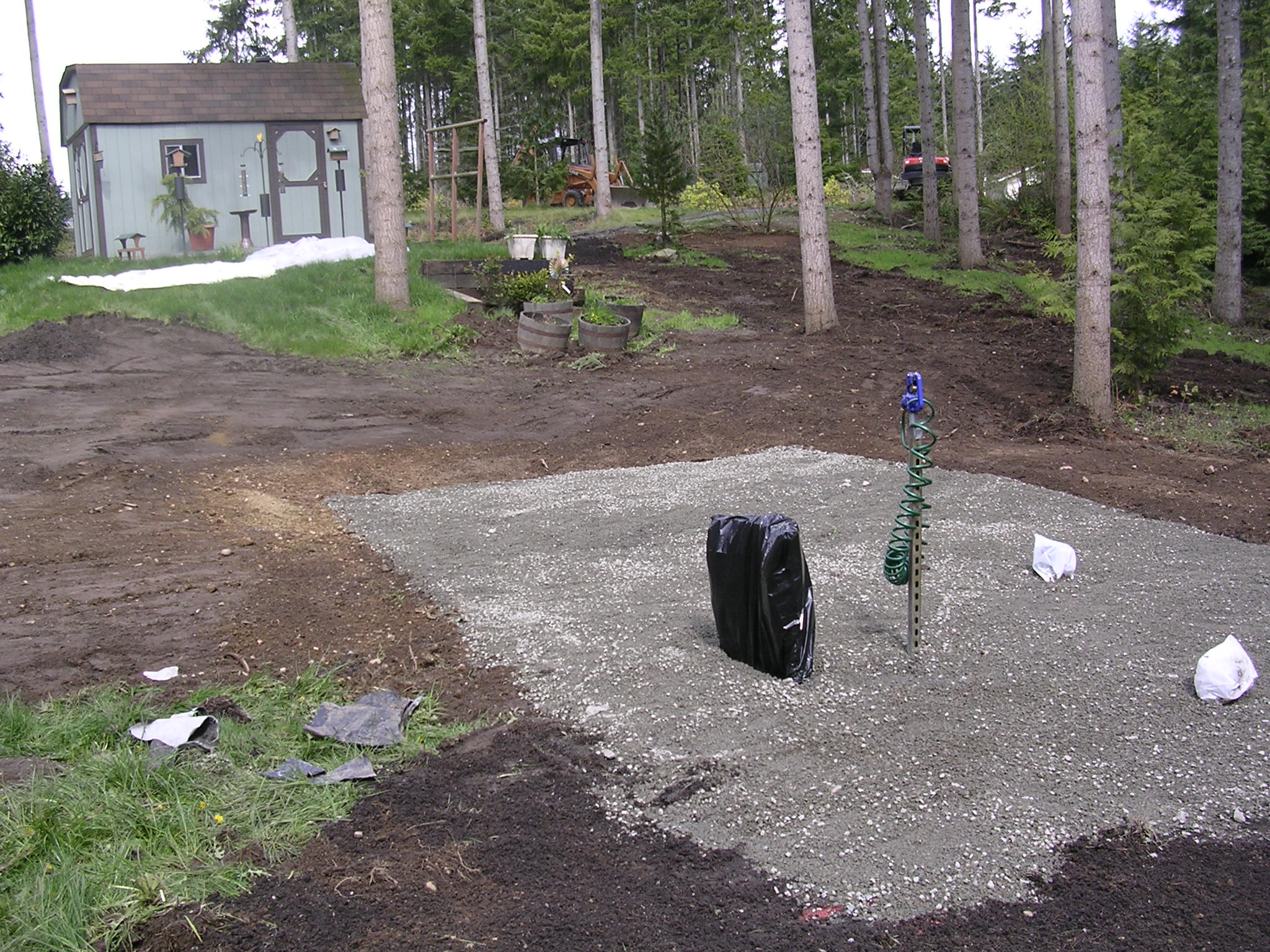

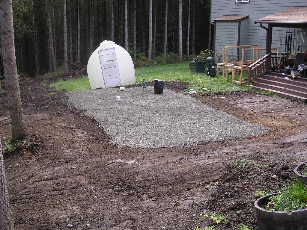

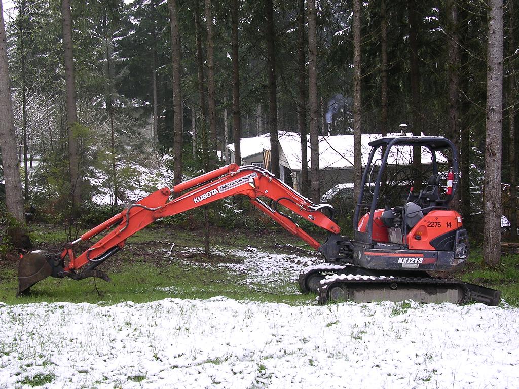

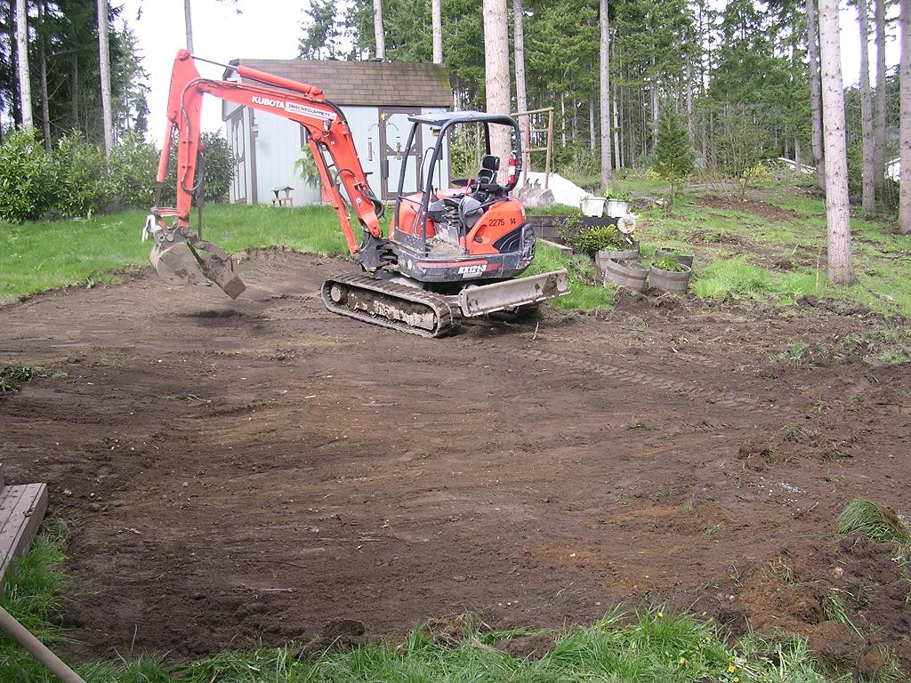

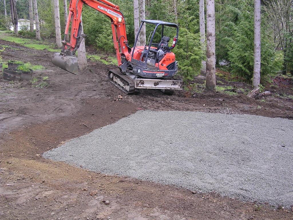

Here are some pics of some work I did for a friend to give him more room for a greenhouse. I cleared this land last year. Snow really made a mess of things and put a couple hours on the job but oh well.

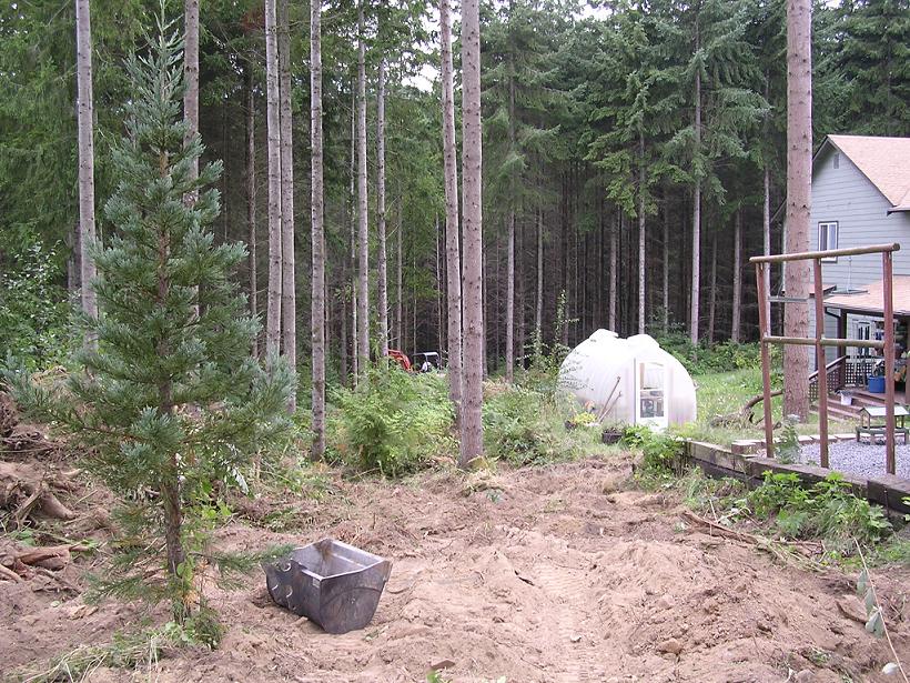

This was what I did last fall for him...

Very impressive. Did you clear it with the Kubota or the Case?
What is the attachement for on the backhoe? It looks like a plate compactor, but I've never seen anything like that before. What did you use it for?
Great pics, thanks.
Eddie
   / Quick job
Hi Eddie,
I did clear the land with the Kubota. I would have liked to have had a 120 size but the trees were too close together and it could have been ugly. The backhoe has a hoe pac attachment. It's a large compactor that I used for extending the gravel pad out for my buddy's greenhouse. I had to actually add some dirt when I dropped down and regraded the areas around it and since I didn't want the area to settle too much I used a hoe pac to really get it set and to help reduce a lot of settling. The snow really made it hard to get the job done the way I wanted it to be done but it was finished none-the-less and finished nicely.
