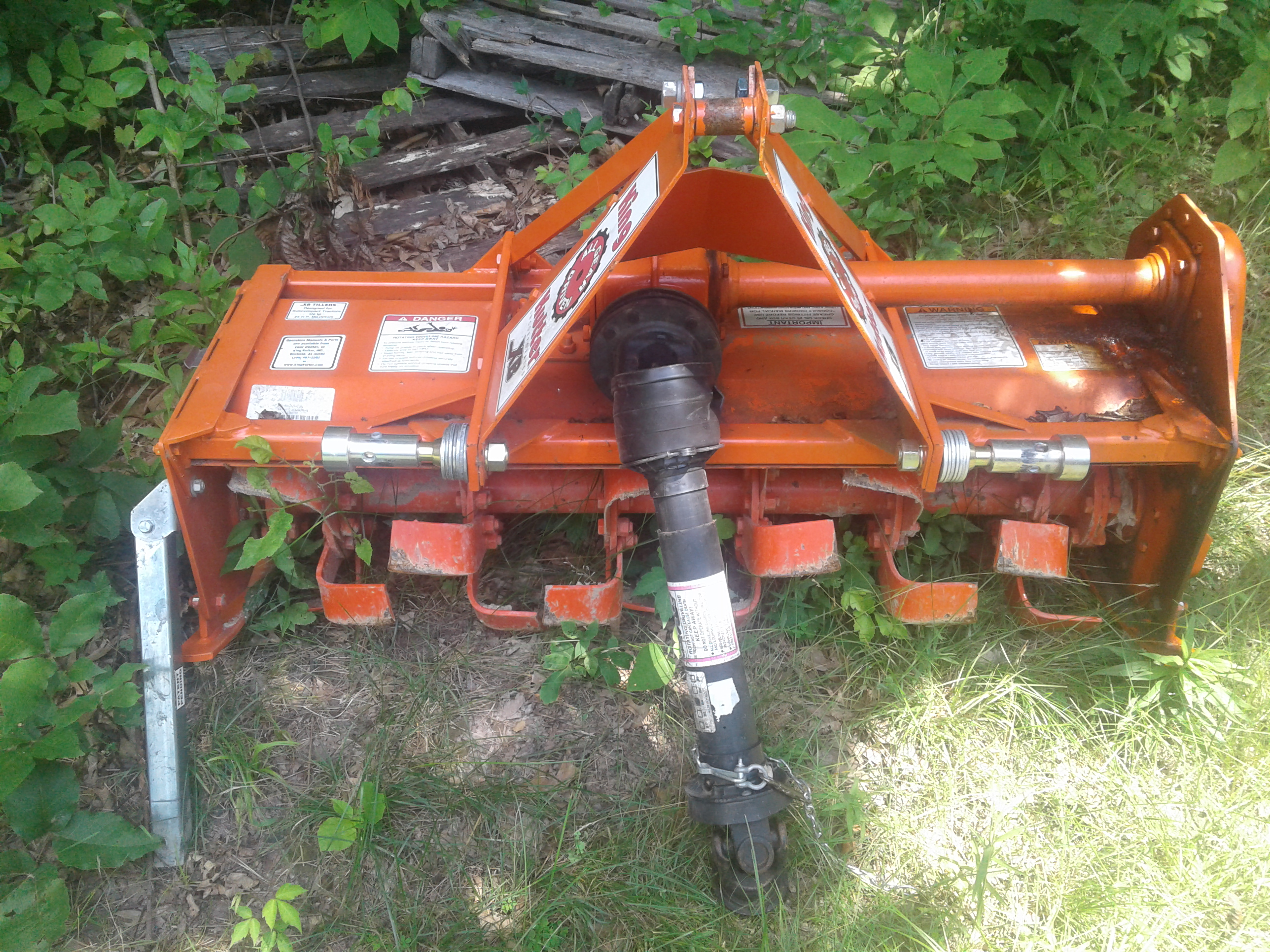

I recently purchased a Kubota BX2380 and then purchased a quick hitch to use with it. When I went to hook up to my King Kutter tiller the quick hitch was too wide and too tall. It would work with my blade and some other implements but I needed it to work with my tiller also. My question is, has anyone made a quick hitch that is adjustable both in height and width. I think that would make it more versitile.

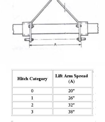

Priefert used to sell one adjustable between Cat 1 and 2.
But it sounds like you have a Cat 0 tiller sized for some subcompacts or garden tractors that didn't have Cat 1 or Cat 1 limited hitches.
Measure your lift arm spread and post a photo of the tiller. There may be an easy conversion.

I guess you learn something every day if you’re not careful. I thought my tractor had a cat. 1 hitch but it must be a cat 0. I still wish I had a quick hitch that I could use but it seems that’s not possible. Thanks for your info and thoughts on the matter I appreciate your help.
   / Quick hitch #7
The BX has a limited Cat 1 hitch. It matches Cat 1 dimensions but doesn't have the full range of motion as a Cat 1 on a larger tractor.
Implements made for limited Cat one hitches usually differ by having Cat 1 pins about 3-4 inches lower than standard when the implement is horizontal.
I have both type implements. A regular cat 1 implement needs the lift arms raised about halfway to meet a level implement sitting on the ground. This limits the amount left to lift the implement. Lower pins on the limited cat 1 implements solve the problem.

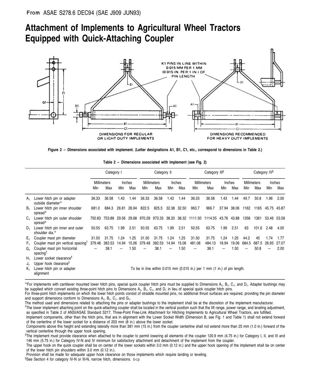

   / Quick hitch #8
Here is "standard" specification for quick hitch, just make non stand implement fit to the standard.... You only have to do it once (per implement) ...
King Kutter XB?
