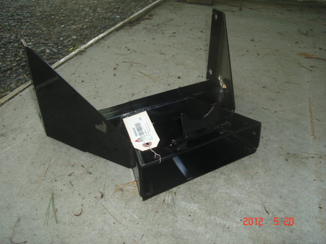

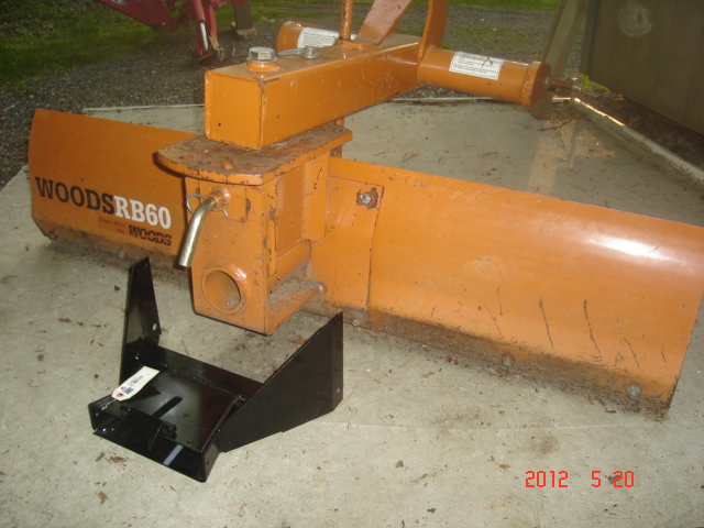

From what I've seen, the Kubota quick-hitch is similar but not the same as the M-F version. I guess each mfr has their own "proprietary" set-up, though I believe there are some threads here in this forum about successful conversions.
Another alternative, if you can find a used blower, might be to just change the receiving "shoe" part on the blower. That part isn't too expensive, IIRC. I bought one a while ago to try to match up a plow so I could quickly switch from blower to plow.
As far as my blower, no way would I part with that! :laughing:
   / Quick Hitch
As always Irving, you're a trove of good info.
Any chance you have the Manufacturer's name & Pt# & where you bought that 'shoe'
   / Quick Hitch #4
Massey Ferguson part number 4263451M1 Hitch Female Quick For the MF snow blower 2360
   / Quick Hitch #5
Yep, that's it. I ordered it through my dealer before they dropped/were dropped by M-F. I paid $152 for it a few years ago, but if you were handy with welding and had the ability to bend 3/16" (I think) steel, you could probably build one.

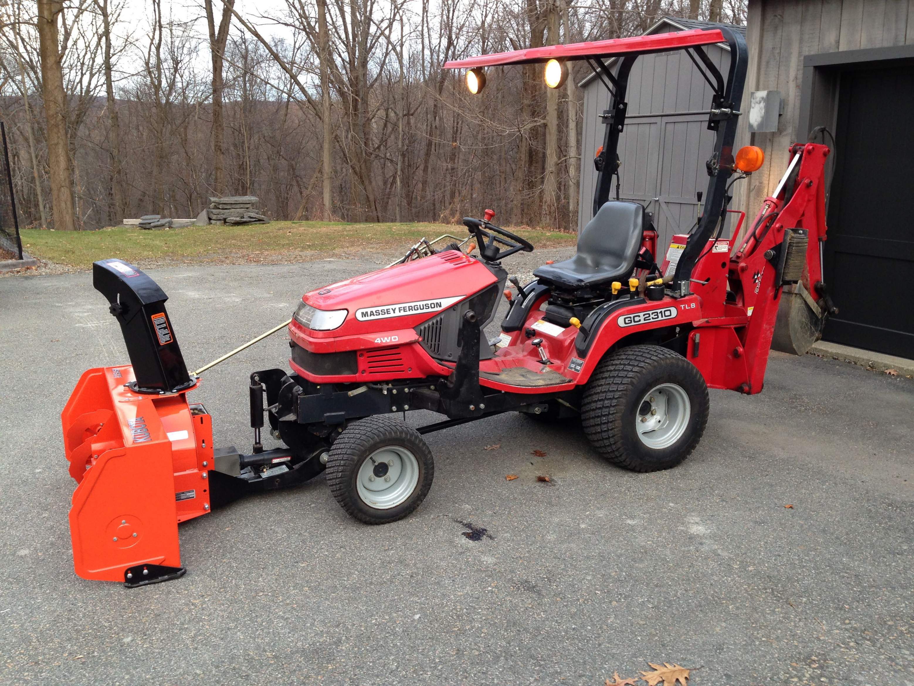

So- I was VERY lucky to P/u a brand new snowblower for my 2310TLB - don't kick me out 'cause it's Orange.
Interesting as RAD in Canada makes the Snowblowers and quick hitch sub frames for Red, Blue and Orange, this is the new (Nov. 1) vs.
BX5450-has a few build improvements over previous vs. (red MF2360) Two immediate issues: As it came w/ manual chute rotation, after I assembled it and ck'd it 3x's
there is a 1/4in play between the chute's mount & it's retainer - can rock it back-forth-360deg. So when I turn the rod to rotate the chute, the worm gear ends up lifting the chute assembly up that 1/4in and so binds up. Will try to get tech on the horn this morning as we're expecting a decent accumulation beginning tomorrow. But if anyone has an idea....
Also - for any of you w/ a MF2360 and manual chute-(and or a parts book) what is the part # for the bracket that secures the chute rotation rod at the operator's end (near the FEL controller ?) I think it may be different - specific for a 2300 -2400 or 2600 set up.
   / Quick Hitch
Orange on Red
Ready to go as soon as it stops snowing!
