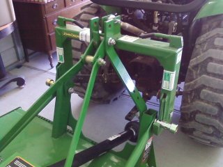

Hello Gents,
I have a JD 3320 with a JD Quick Hitch which I love. I am considering purchasing some additional attachments from everythingattachments.com but am concerned that they will not be compatible with my quick hitch.
Where can I purchase additional receivers to install on my attachments?

I think I just found the answer...I need to purchase bushings for each one of my attachments?
   / Quick Hitch #3
Yes, you need bushings. A search of the term "imatch" will return hours of good reading.
When you buy a new attachment-just have them verify it meets the ASAE Standard S278.6 and you will be all set.
TSC has bushings, as well as JD. Here are the cheapest you will find them but you will still need the top link one but that is cheap: QUICK HITCH ADAPTER KIT CAT 1-3

   / Quick Hitch #6
Dr Zaius and Kenny,
You both helped on the JD Quick Hitch and great low price adapter kit.
I attached some photos as I received the QH Saturday and installed the QH and adapter kit.
Jim
